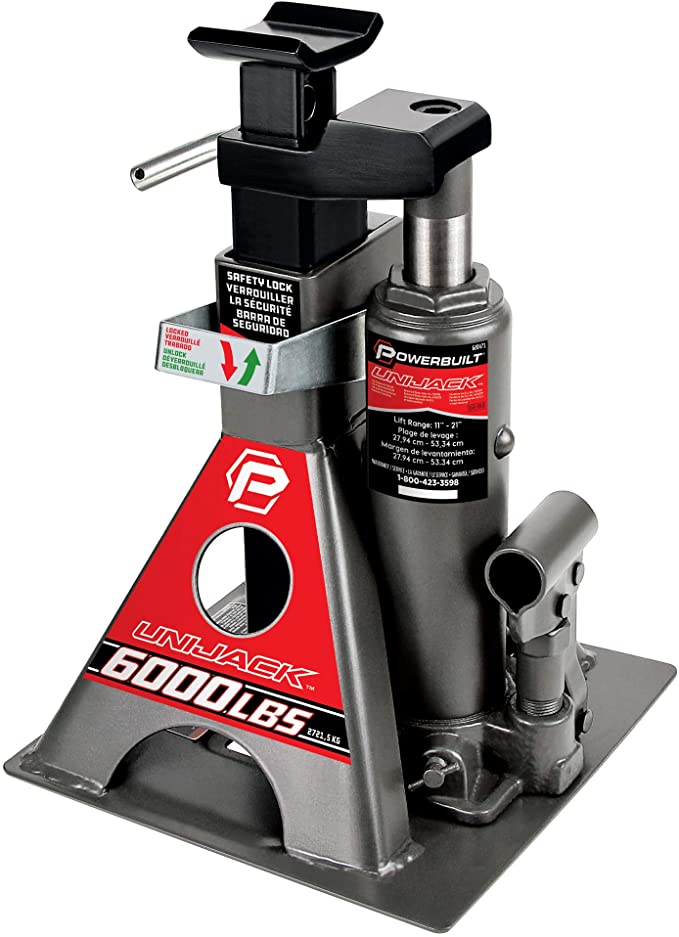

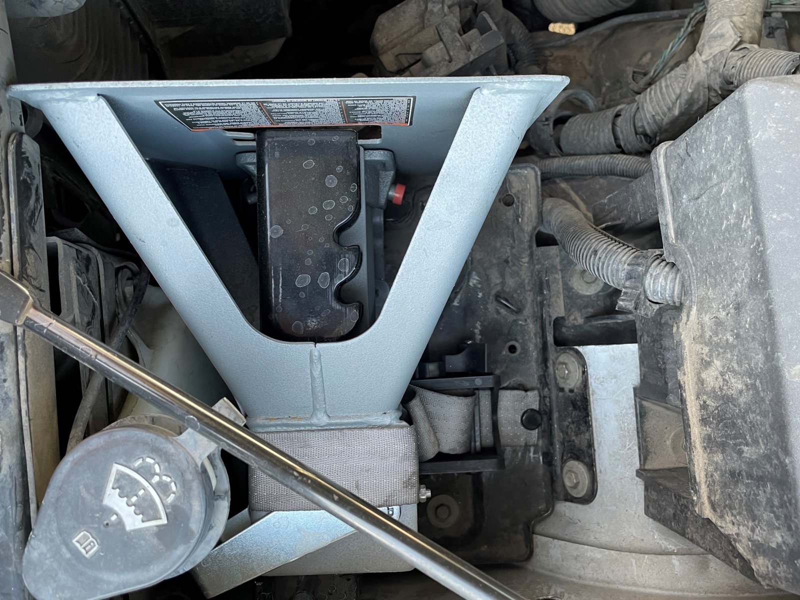

Here's my jack set up.
I used a unijack on the spare battery tray with a quick fist ratchet strap bolted to the tray with lock nuts. The round part of the bottle jack sits nicely in the cradle and holds it level. The strap loops around the whole thing and you just crank it down. The top of the jack sits up against the inner fender, so I put stuck a piece of rubber there to keep it from scratching it. the lip of the tray holds the bottom of the jack. Occasionally rattles a loose a little and I have to readjust it and retighten, but it can't fall out (or hasn't yet after a couple years). I just check it when I check my oil or after something super rocky and it's usually fine. An angle bolted to the tray at the bottom of the jack would keep it from slipping over the lip of the tray on occasion. I'll probably move it to a rear drawer if I ever add a second battery.
