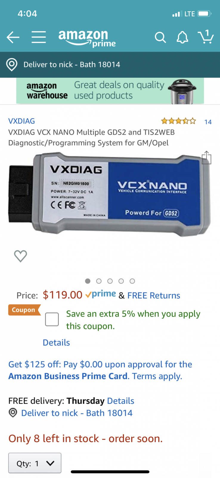

if you have a windows tablet or a laptop with a standard usb port you can save a few buck and order a vx diag nano those run about $100-125 and it will give you tech2win (software based tech2 operation) and gsd2 software for most gm's that are 2014 or newer. (the tech2win will work from 96-2013), a tech2 hardware will go back to older years because it includes adapters for use before obd2
that’s the exact unit I was looking for on amazon. I’m definitely thinking that’s going to be a contender.

if you pick up the vx nano when you install the software be sure any anti-virus is turned off during the install otherwise you will have issue's just a heads up
this is what I ended up buying.
It states on their website that I works on windows 8, but I have windows 10. I did some research and found people were able to download it using windows 10 by disabling windows defender.
I’m looking around on here for anyone who’s done it and has any notes.
