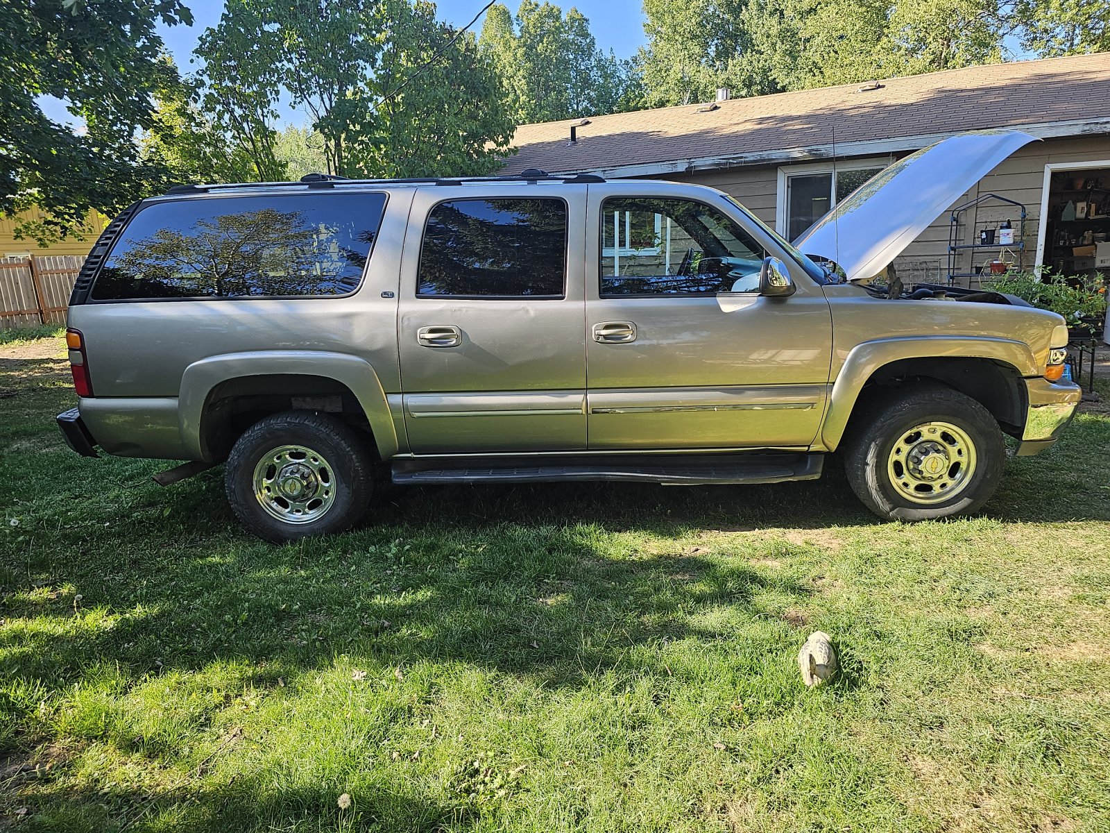

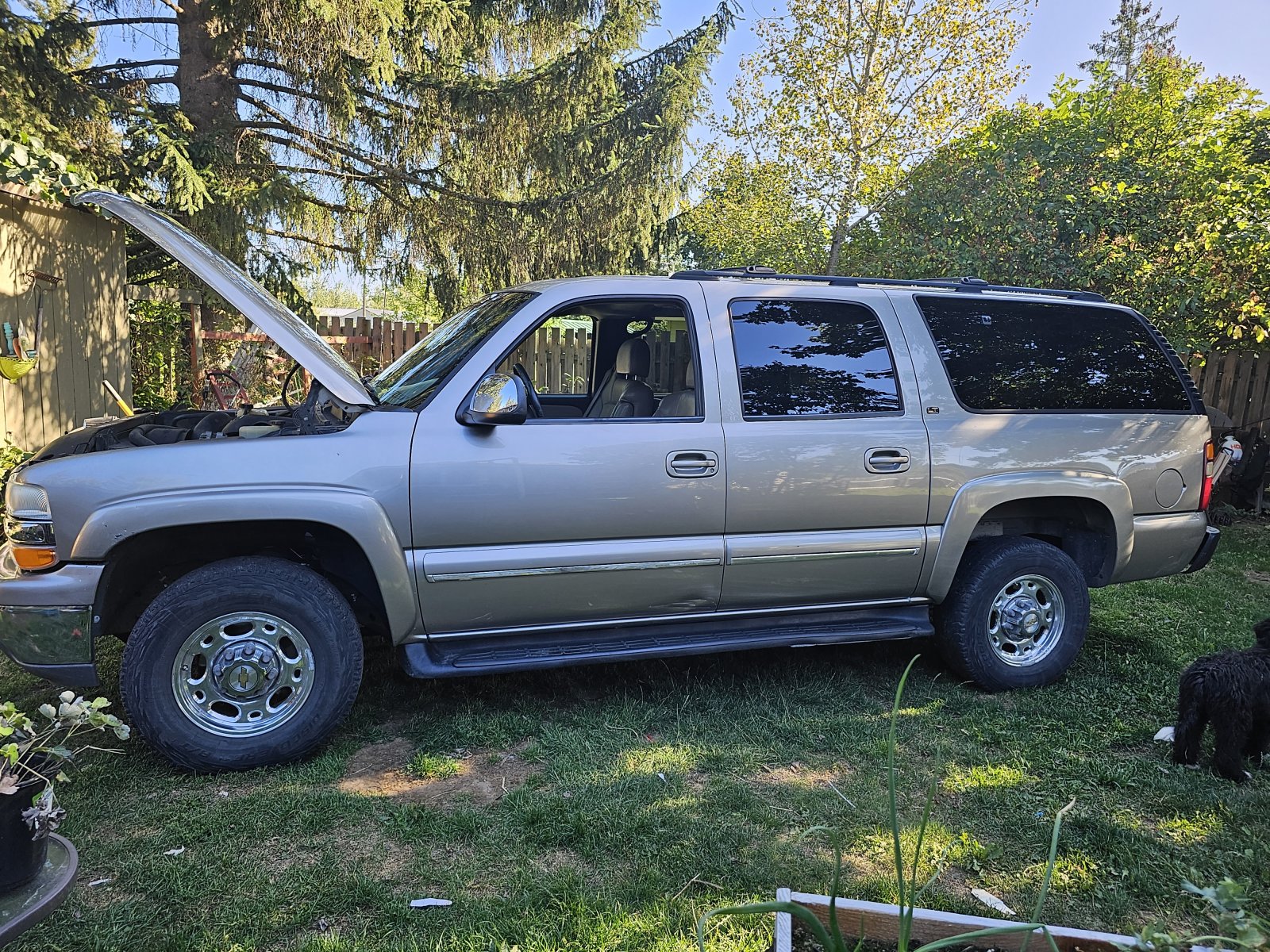

Here is my 2001 Suburban.
SpareParts
Sep 17, 2023
2,120
4,819
North Idaho
Picked this up for a cool $2,500.
Needed a few things but nothing major.
I have changed the Oil, Filter, removed the running boards but still need to find mud flaps, New sparkalators, Fixed the broken ABS module
This weekend will be changing the Knock sensors and possibly the stock non Bose amp as it's not working and stereo sounds like cr*p.

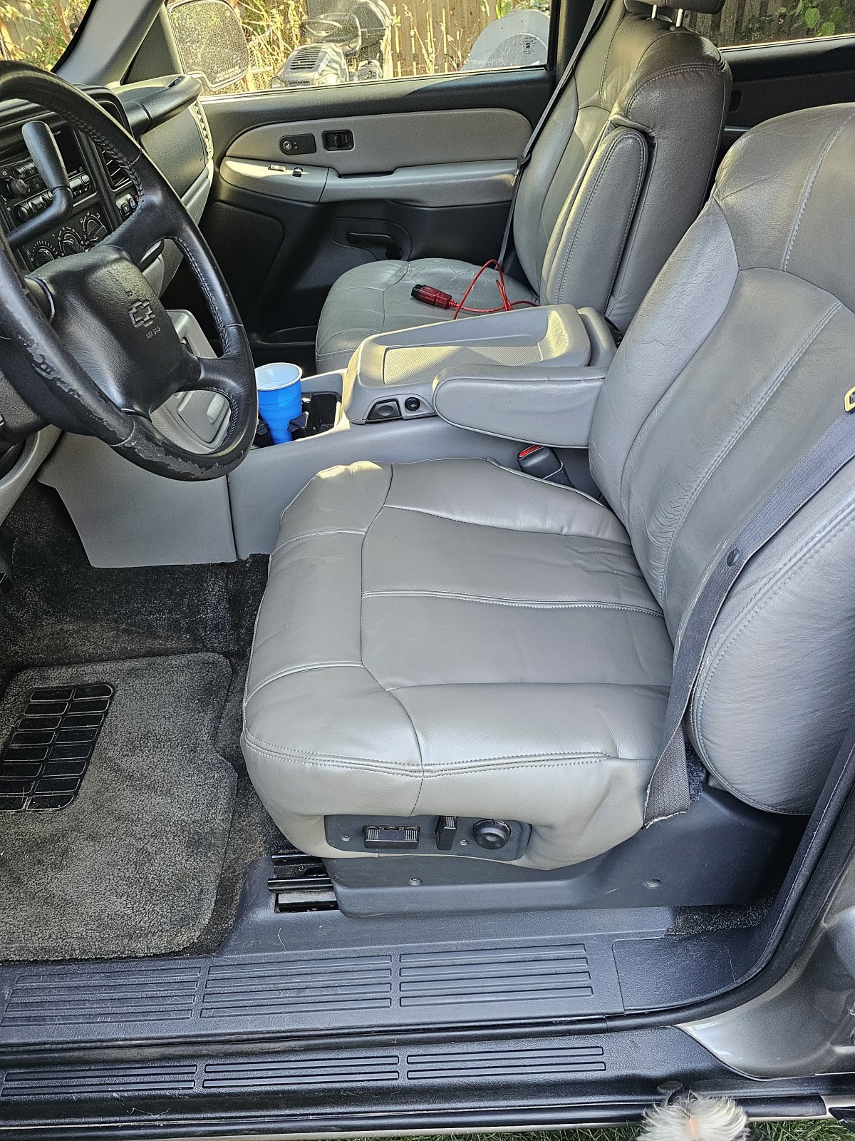

I have only put about 100 miles on sense i got it. So far seems pretty solid and not abused. After changing the driver seat cover the interior is nearly perfect.

Before and after.
