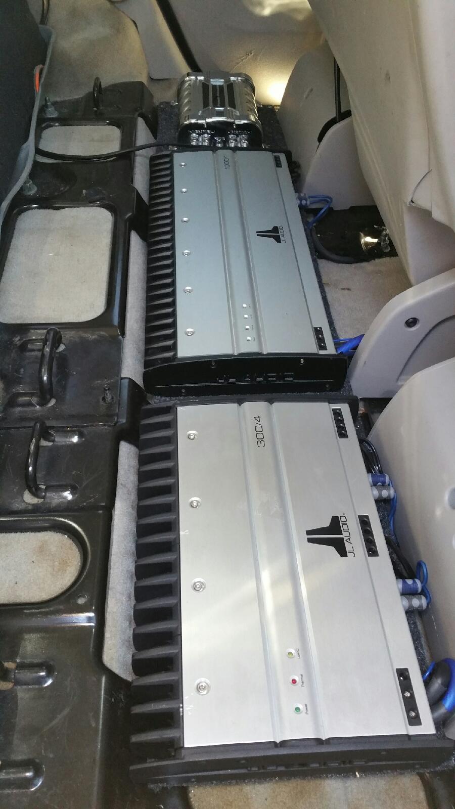

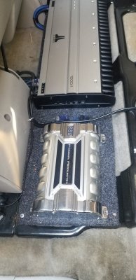

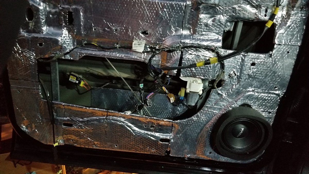

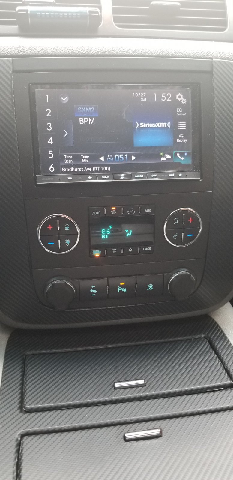

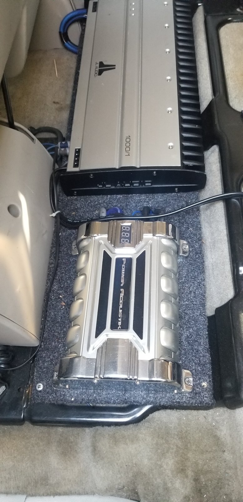

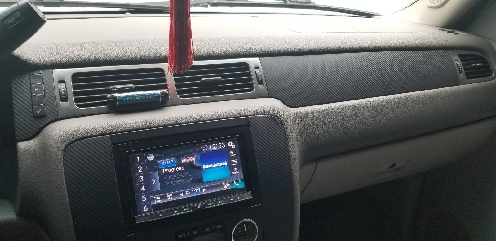

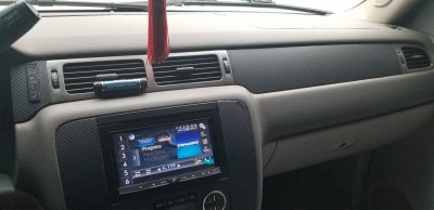

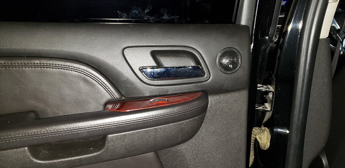

I guess I am next.
12" jl audio w7 in back.
6.5 components in doors and 4" in rear pillar jl audio all around.

Awesome! What’s next to the amp on the driver side? Nice touch with what appears to be carbon fiber trim on the dash too!

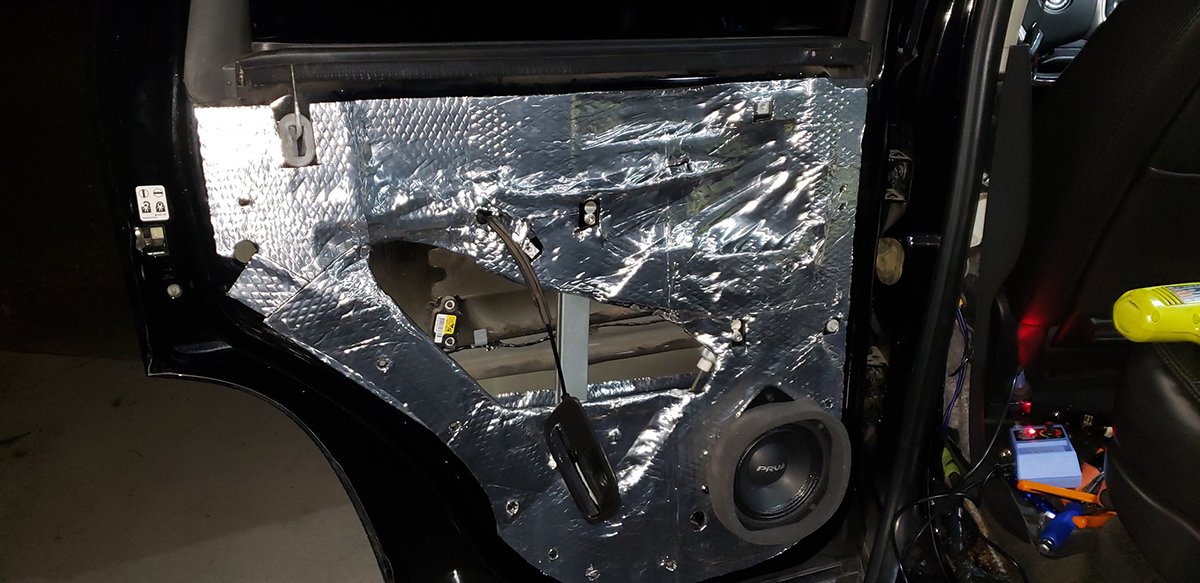

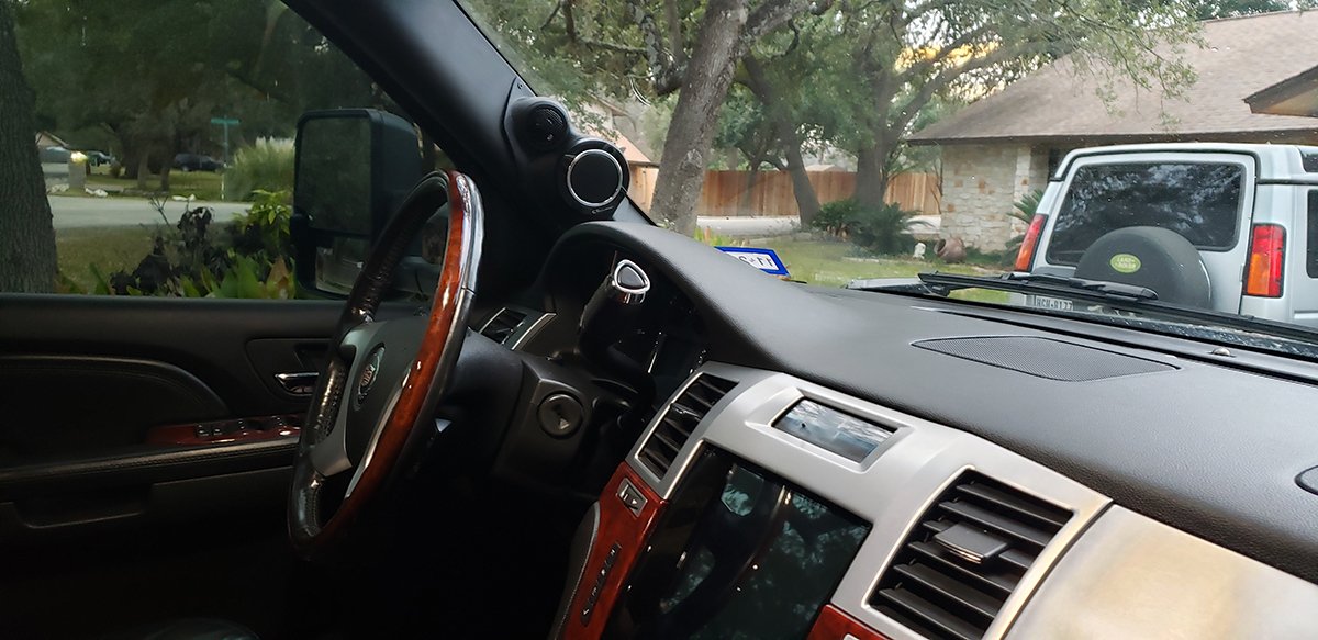

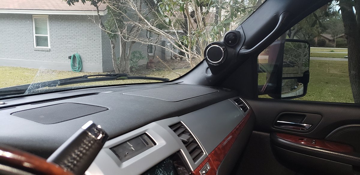

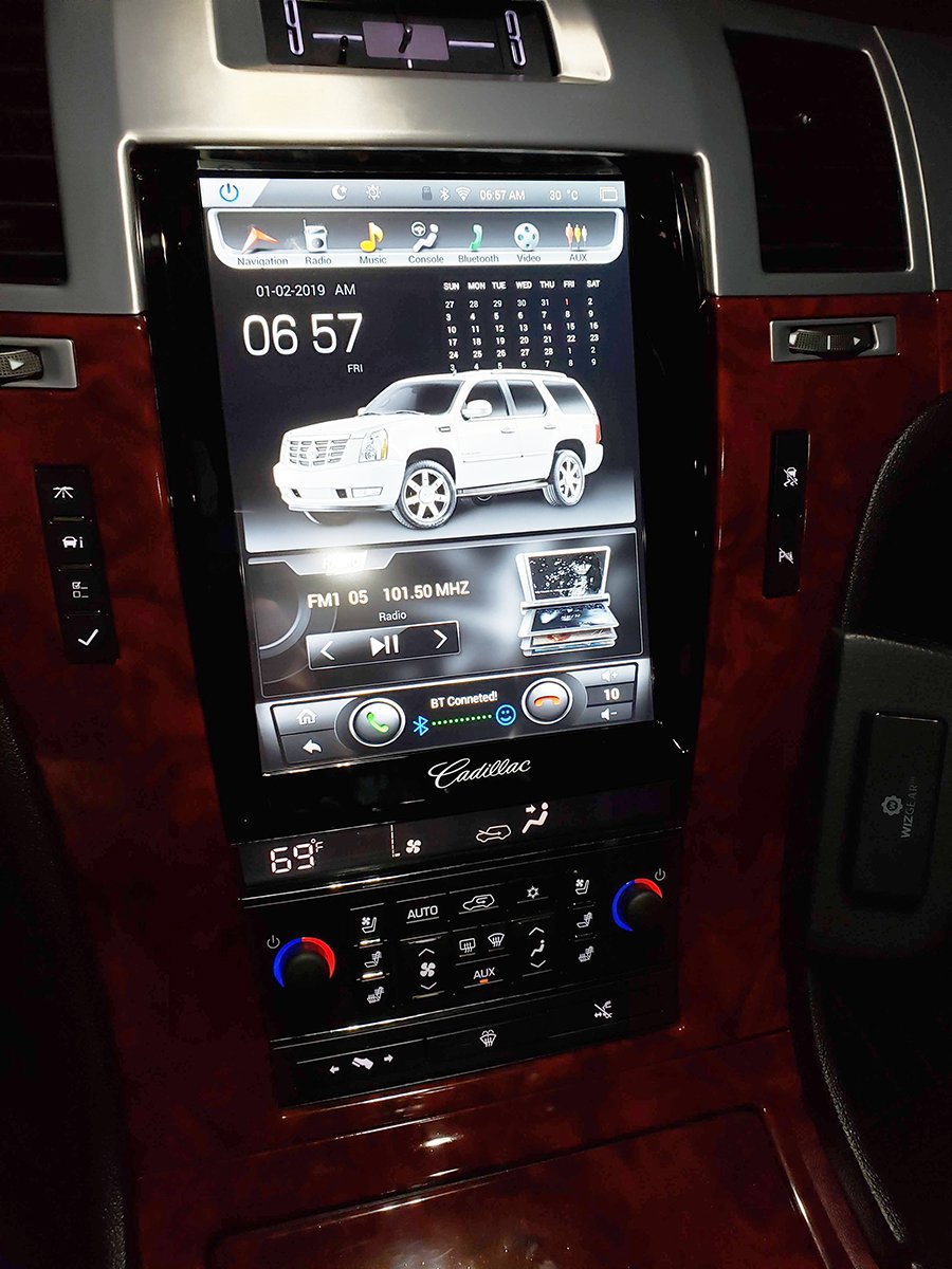

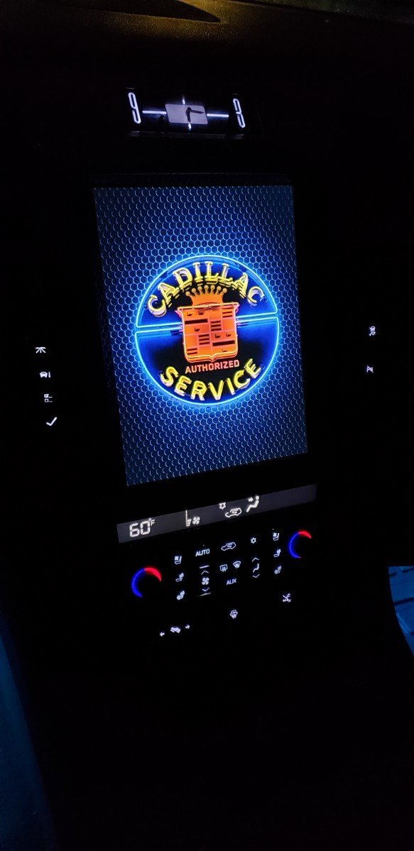

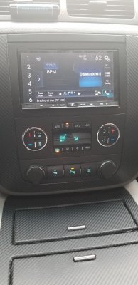

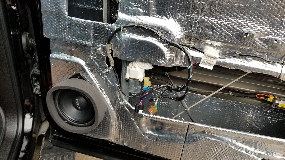

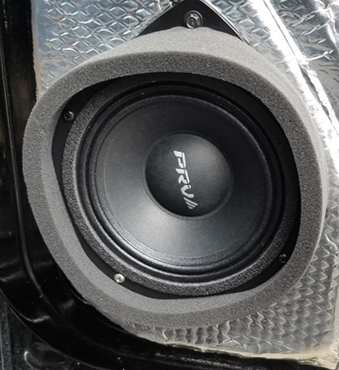

-10.4" Vertical Screen Tesla 1024*768 Android Radio 2GB Ram 64GB HD 4 Core
-PAC SWI-RC Steering Wheel Control Interface
-Mids/Highs Amp - Pioneer GM-DX874 4 Channel Amplifier (100W RMS x 4 @ 4 Ohms)
-Sub Amp - Pioneer GM-DX971 Class-D Mono Amplifier (800W RMS x 1 @ 2 Ohms)
-DSP - Pioneer DEQ-S1000A 48-bit dual-core DSP-based signal processor

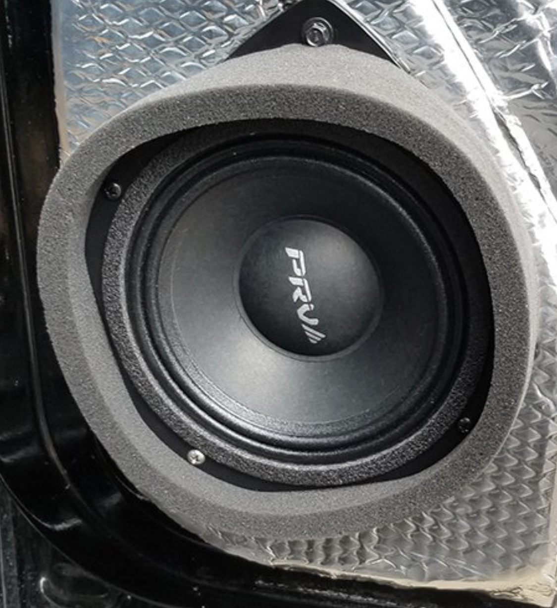

-Noico 80 mil Butyl Automotive Sound Deadener on all Doors
-Road Kill RKFR6 3 Piece Foam Speaker Enhancer System Kit on Door Speakers
-CT Sounds Car Audio Passive 3 Way Crossover
-Front Speakers - PRV Audio 6MR500-NDY-4 Neodymium 6.5" Mid Range 4 ohm Speakers
-CustomSpeakerPods.com A-Pillar Speaker Pods
-A-Pillar Speakers - PRV Audio 4MR60-4 4" Mid Range Speakers
-A-Pillar Tweeters - Massive Audio CT2II - Silk Dome 120 Watt 28mm Car Audio Tweeters
-Rear Speakers - PRV Audio 6MR500-NDY-4 Neodymium 6.5" Mid Range 4 ohm Speakers
-Rear Tweeters - Massive Audio CT2II - Silk Dome 120 Watt 28mm Car Audio Tweeters
-Down Firing Sealed Third Row Subwoofer Enclosure/Box
-Subwoofers - 2 Pioneer TS-W3003D4 12"

That’s awesome!
Didn’t even know these existed...
I thought about doing the sound proofing as well but was too lazy.
Great spot for the amps if I may say so!
What do you have going on under the center console?
Do you have a pic of the subs under your 3rd row? I didn’t think anything could even fit under there.

Yeah I saw those foam surrounds on a youtube video and figured what the hell. I almost skipped the sound deadening, but since I was gonna have the door panels off anyway I just pulled the trigger. I originally had a 5 channel amp under the center console, but that thing was trash and burned up after 5-6 months. Now I have the crossovers for the front speakers and the Pioneer DEQ-S1000A DSP under there. And the subs are just in a prefabbed downfiring box behind the 3rd row for now. Eventually I'm going to build a front firing custom box to go behind there.

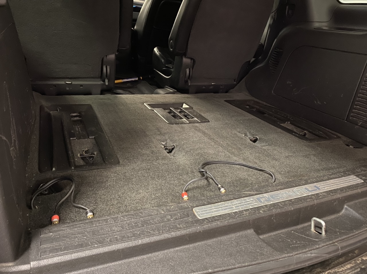

Easy to remove the 2 subs and stick the banana plugs under the rear trim piece...

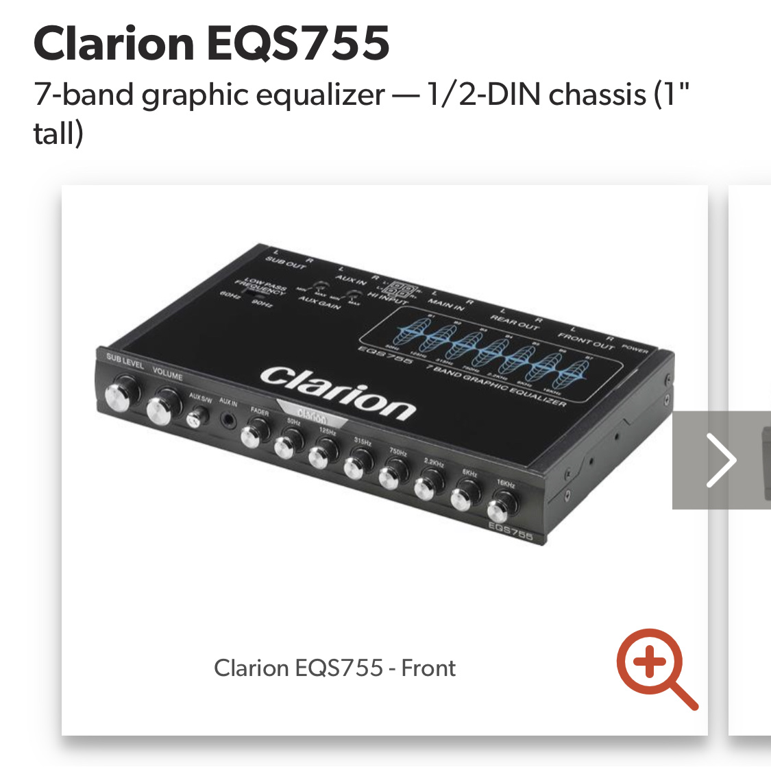

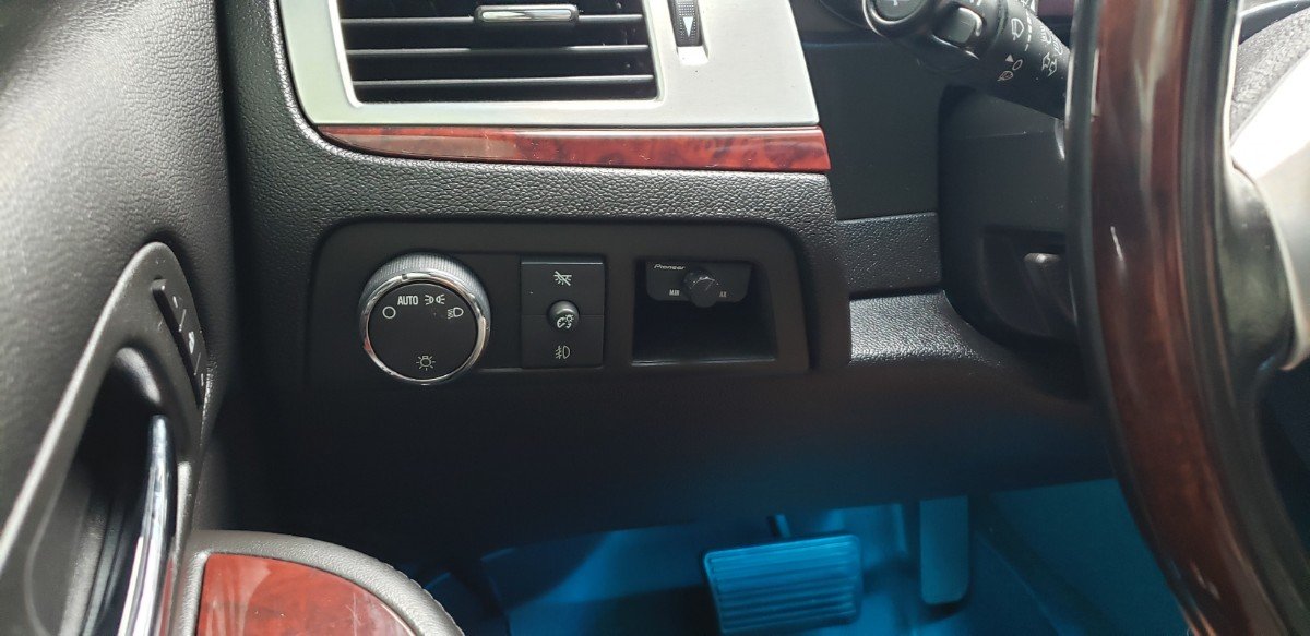

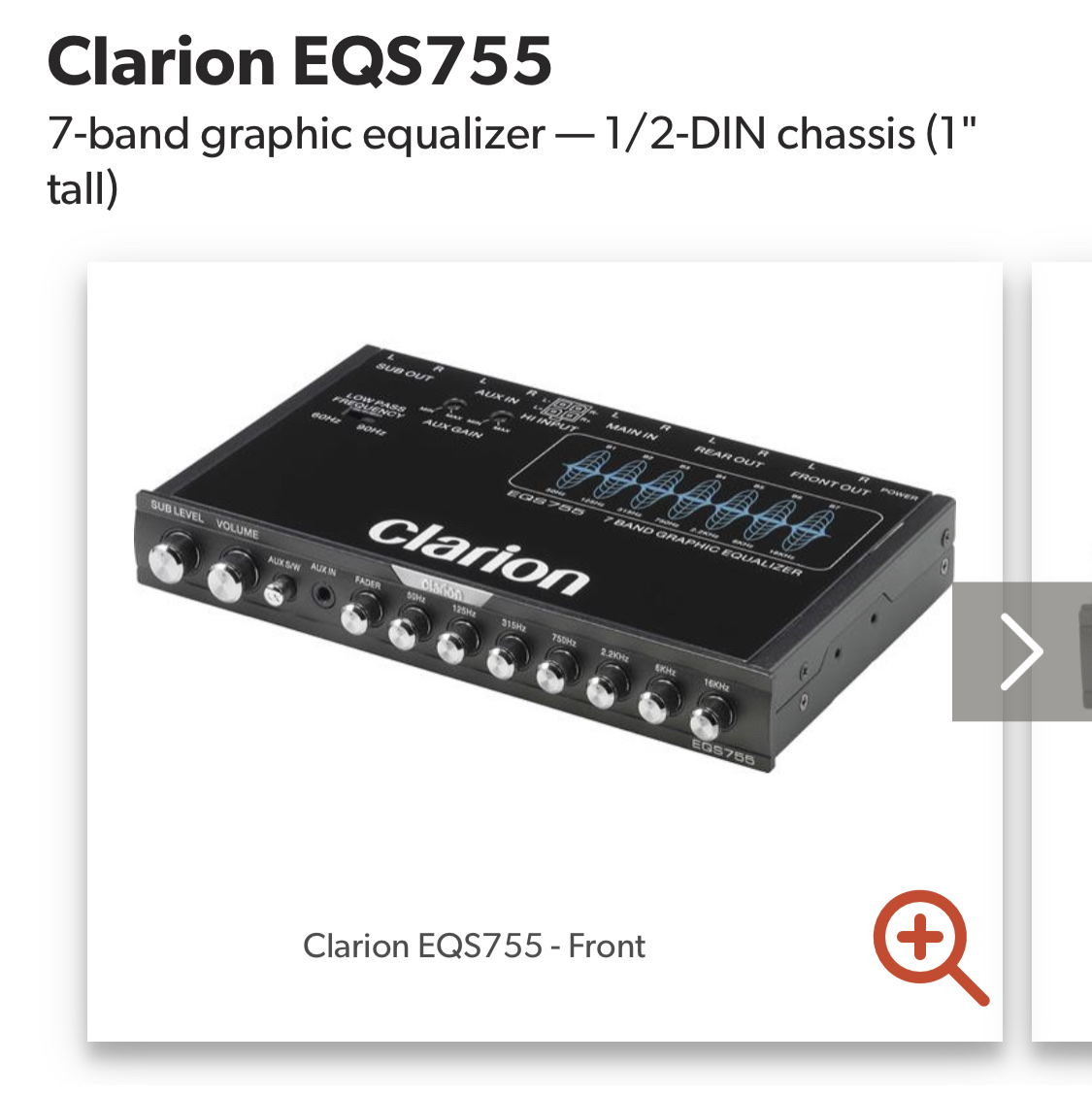

Thinking of adding a clarion equalizer just not sure of where to place it, any ideas would truly help.

sorry...just saw this.
Something like this:
This one is only 1” tall. I wonder how it would look and feel in the knee bolster below the steering wheel and a little towards the passenger side?
Or maybe on the side of the center console?
I don’t think it’ll fit in the little space between center console and hvac controls on dash, but that might be a good spot.
On the headliner above you? Nah... probably not.
Just tossing ideas around.
Maybe in the center console? Probably not as you’d have to open the console up each time you’d adjust it.
Be interested to see where you place it...

If it were me, I'd buy a decent aftermarket head unit, which will already have everything that this Clarion offers as standard built-in features. Then you don't have to look for a space to install it. Various Kenwood and Pioneer head unit models offer these features as standard, and other brands do, as well.

Exactly right! My Kenwood has all the same features and I love it!
