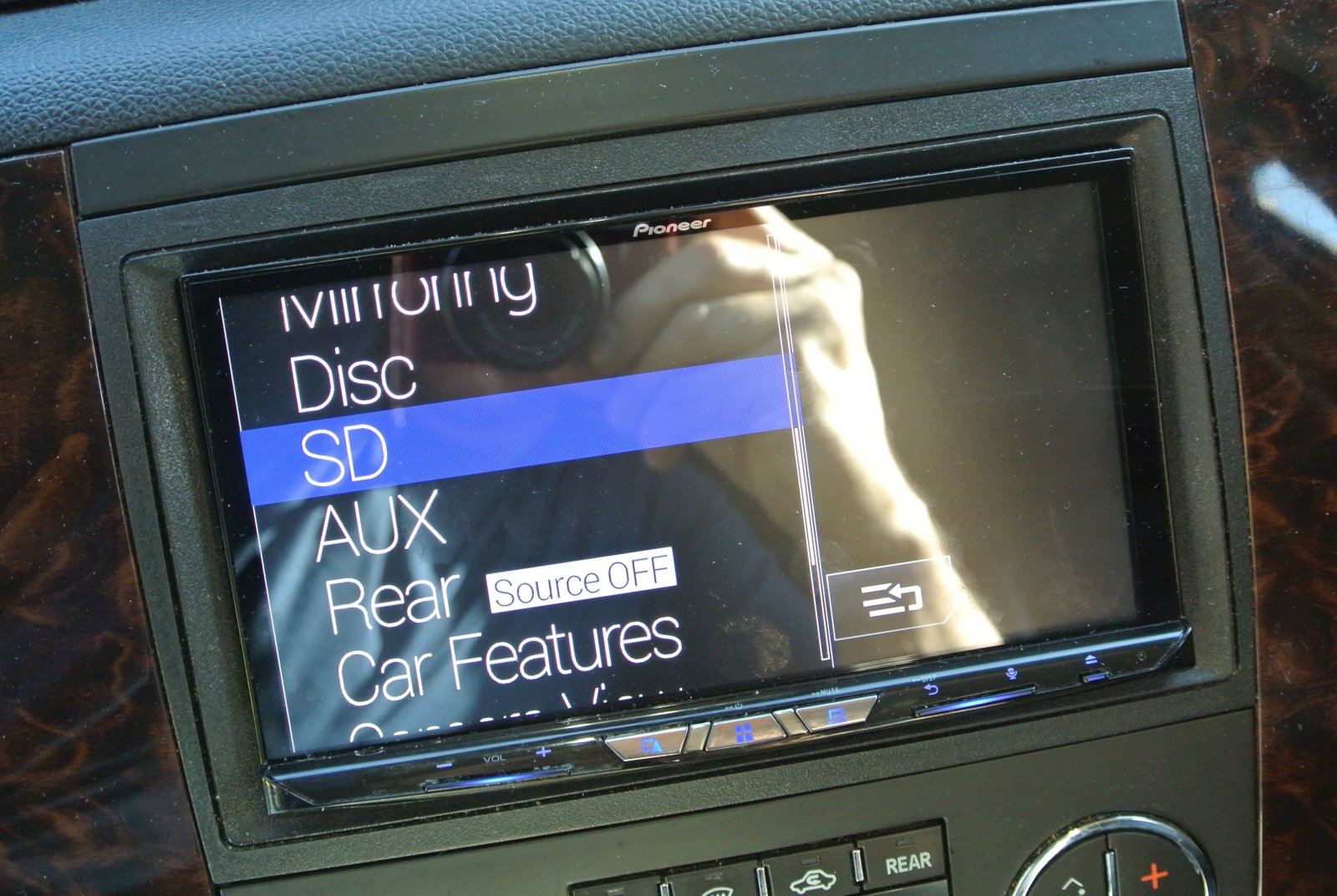

hard to decipher your explanation, but on my pioneer in order to mirror what is playing on the headunit to the rear screens I have to open the menu and select the rear av after the source is playing, then it plays on all screens, and yes the 3rd row screen has to be wired to the 2nd row in order to work period

menu on the headunit as shown below, the jvc might be similar. by default on mine the rear is off until you change it AFTER the source is running.
