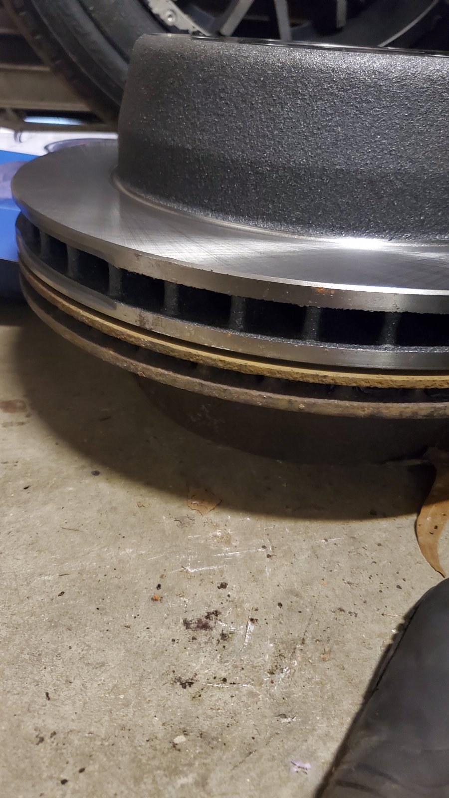

Have a 2003 suburban that says it's a z71. I ordered z71 rear brakes and rotors. The rotors are much thicker and the pads seem to be for a dual piston caliper. Can I upgrade to the larger rear discs and calipers without any other mods than the new rotor and caliper? And what caliper should I get? The rotors seem to be ever so slightly taller as well

Detroit Axle - Dual Piston Caliper 6-Lug FRONT & (330mm) REAR Disc Rotors + Brake Pads Replacement for Sierra Silverado Suburban Yukon XL Avalanche 1500 Tahoe - 8pc Set https://a.co/d/6H5iNTK
The fronts were just fine. Now that I have big rotors and pads I'm thinking about picking up the dual piston calipers from oreillys tomorrow. It seems like the best thing to do at this point.

Yes you can, (the rotors,) the pads and caliper, (with bracket for that caliper) on the rears is all you need.
Don't buy that detroit axle kit. If you are buying new front brakes: there is the NNBS front brake upgrade. Very little price difference if you are buying the components anyways. For the fronts, its a larger rotor a dual piston caliper vs your factory single piston, and a much larger pad. If you really want to go all out there is the 2020+ 4 piston caliper. Which is always great, but still about 2-3 times as much, and kind of overkill for most people.
The NNBS brakes started in 2005, but had a design change in 2007 for the NNBS. If you get new brakes the 2005-2019 (order 2008 and higher) will fit right on. You just need 17" wheels for them to fit. The 4 piston needs 18" and not all fit easily.

I know right? I was very confused. It's a legit z71 with single piston calipers. I just picked up the calipers today.
