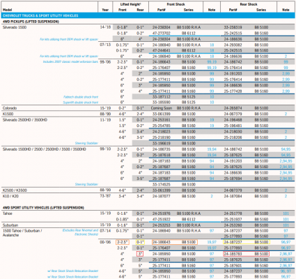

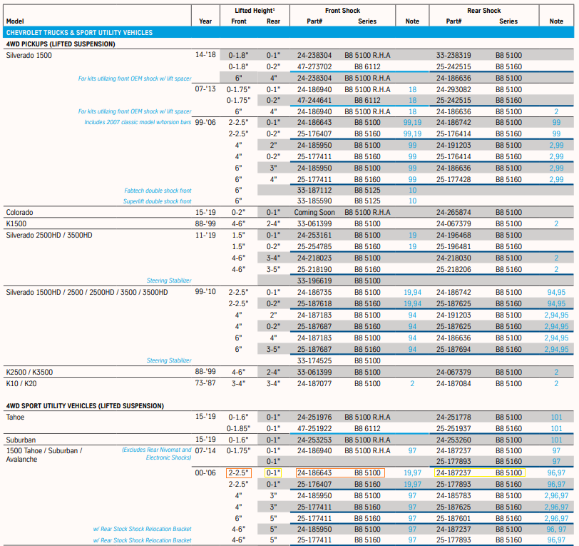

Also, which rear Bilstein shocks would be appropriate for a 2" lift rear spacer? 24-187237 OR 24-185783?
What threw me off is several websites (Summit Racing, Shock Warehouse and Amazon) incorrectly list 24-187237 as appropriate for a 0"-2" rear lift, which is a mistake per the Bilstein product catalog (highlighted in yellow), and actually designed for a 0"-1" rear lift.
Meanwhile, 24-185783 are listed as 3" rear lift, and are the only ones listed on Rock Auto (highlighted in red).
Given that I will not be exceeding 2.5" up front (to avoid the need for new upper control arms/spindles), I was thinking 24-186643 front shocks (highlighted orange) and so a 2” spacer in the rear to achieve a 2.5"(front) and 2"(rear) lift… But, which rear shock is ideal???
Am I confined to a 1" rear lift if I'm raising the front by only 2.5"?

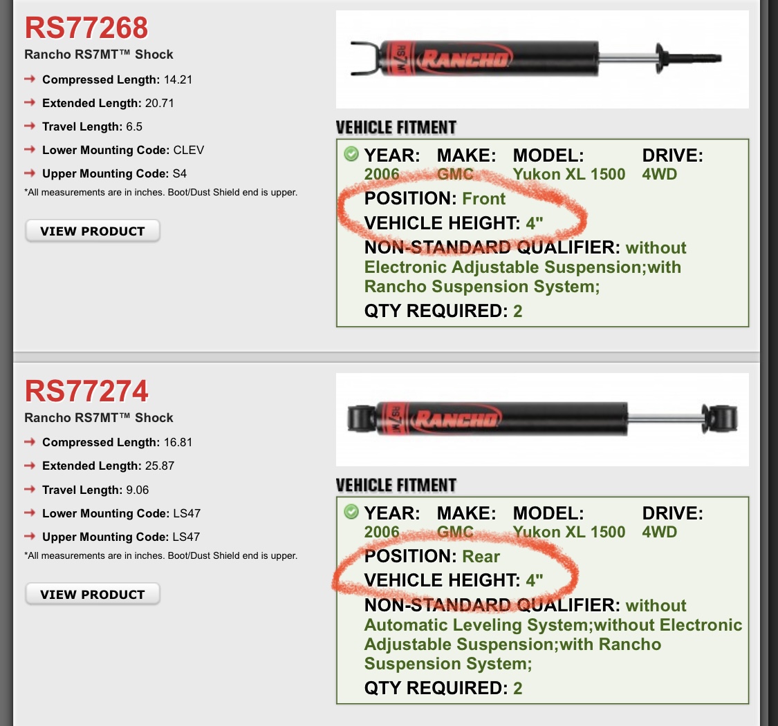

Still doing research… I heard Rancho RS7MT shocks are bit more comfortable/cushiony than the Bilstein 5100’s? Any comparison?
The Rancho RS7000MT (now called RS7MT) come in different sizes for different height applications as well: 0” height, 1” height and 4” height (which I think they mean height of lift).
Would I be safe installing the 4” version of the Ranchos front/rear with 3” torsion keys up front and 3” spacers in rear?
I realize I’d have to upgrade the upper control arms, but would that extra inch cause any issue otherwise? Or is that extra droop okay?

I called Bilstein to ask about the rear lift height discrepancy thing… The product technical support guy told me the stated heights listed are indeed the correct min/max rear lift heights to achieve the best performance/shock travel (and to stay within warranty) as per their tests... Meaning that all of the websites listing the rear lift as 0-2” are wrong! :oops:
It looks like I'll just opt for a 2.5" front torsion keys and 1" rear spacers lift to perfectly match the Bilstein 24-187237 and 24-186643, along with the Moog 81069 (Z71) rear springs, and call it a day.
