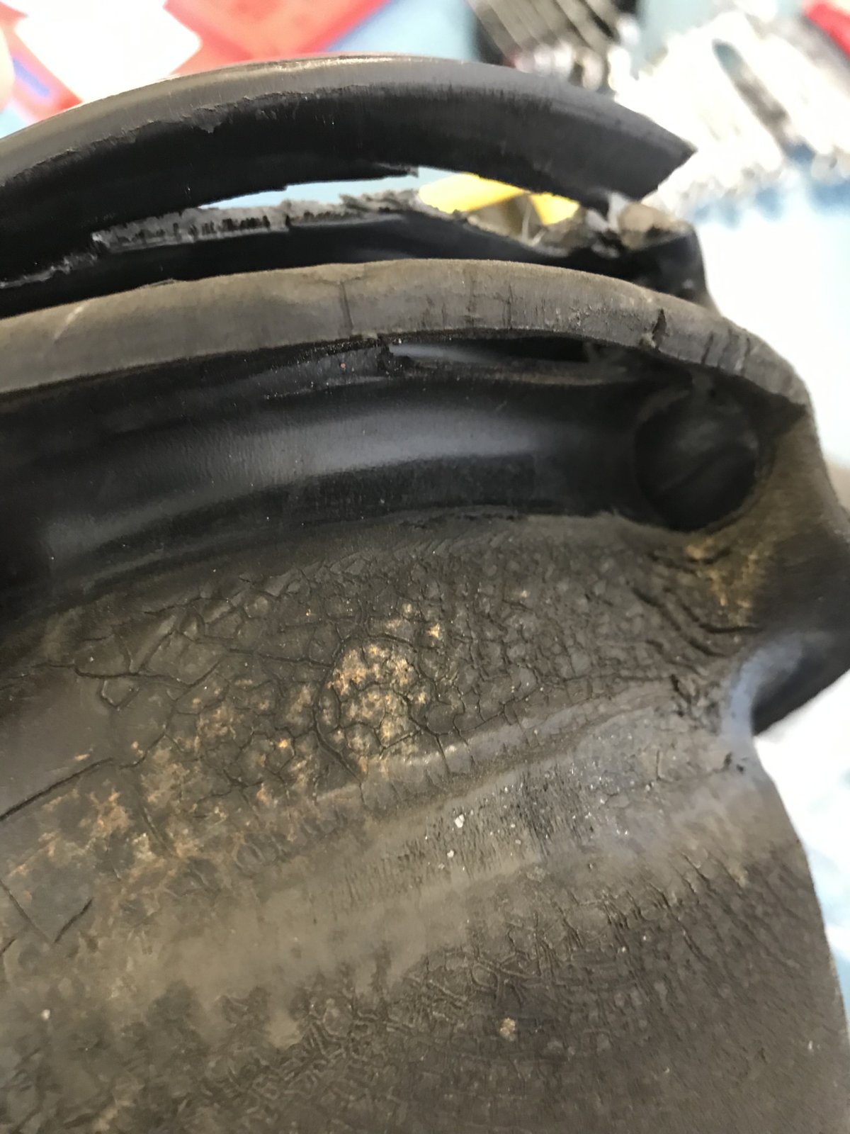

Thank you all for the great recommendations. Decided to replace front and rear shocks with Monroe 39106 for fronts and 911545 for rears. Still a crazy firm ride.
I did also replace strut mounts as i learned one reason for the horrible ride was a damaged strut mount on the drivers side. Now i know why it shook the truck every time i hit a tiny bump.

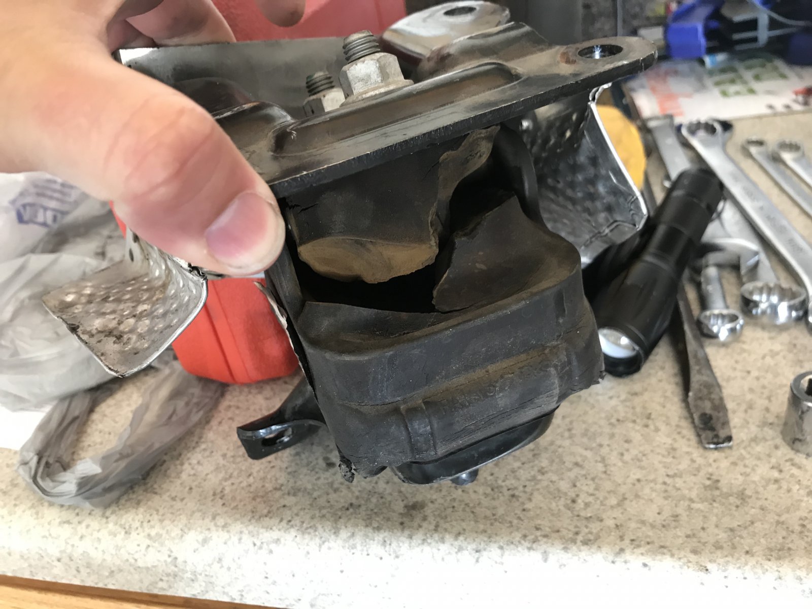

Though my ride is a little nicer, I still get that horrible banging/shake in my dash, steering wheel, and rear when I hit small bumps. Can’t figure out why it’s so bad.
I had an idea that my motor and transmission mounts had to be bad, causing everything to lift when hitting a bump, then hit the frame. The driver engine mount was destroyed. Unfortunately that didn’t help (I did need to change them anyway).
Any ideas on what could be causing the horrible banging/shaking in my suspension? Even on rough roads, feels like my Tahoe is shaking apart.

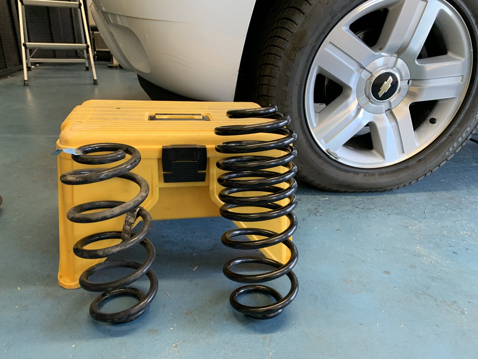

Update to my original post:
I finally got around to the final idea to soften my PPV ride... changing out the rear springs.
i ordered a set of Eibach 2” lowering springs as I learned the PPV rear springs are the main cause of the firm ride (along with the Monroe shocks/struts).
check out the difference between the lowering springs and the PPV springs:
Crazy that the PPV springs are shorter, yet ride about a 1/2” higher when installed.
overall made a big difference in the ride comfort without losing the PPV lowered look and handling. My front and rear stance is close to level as possible.
I bet the variable coil design and smaller wire would have a much softer ride.
