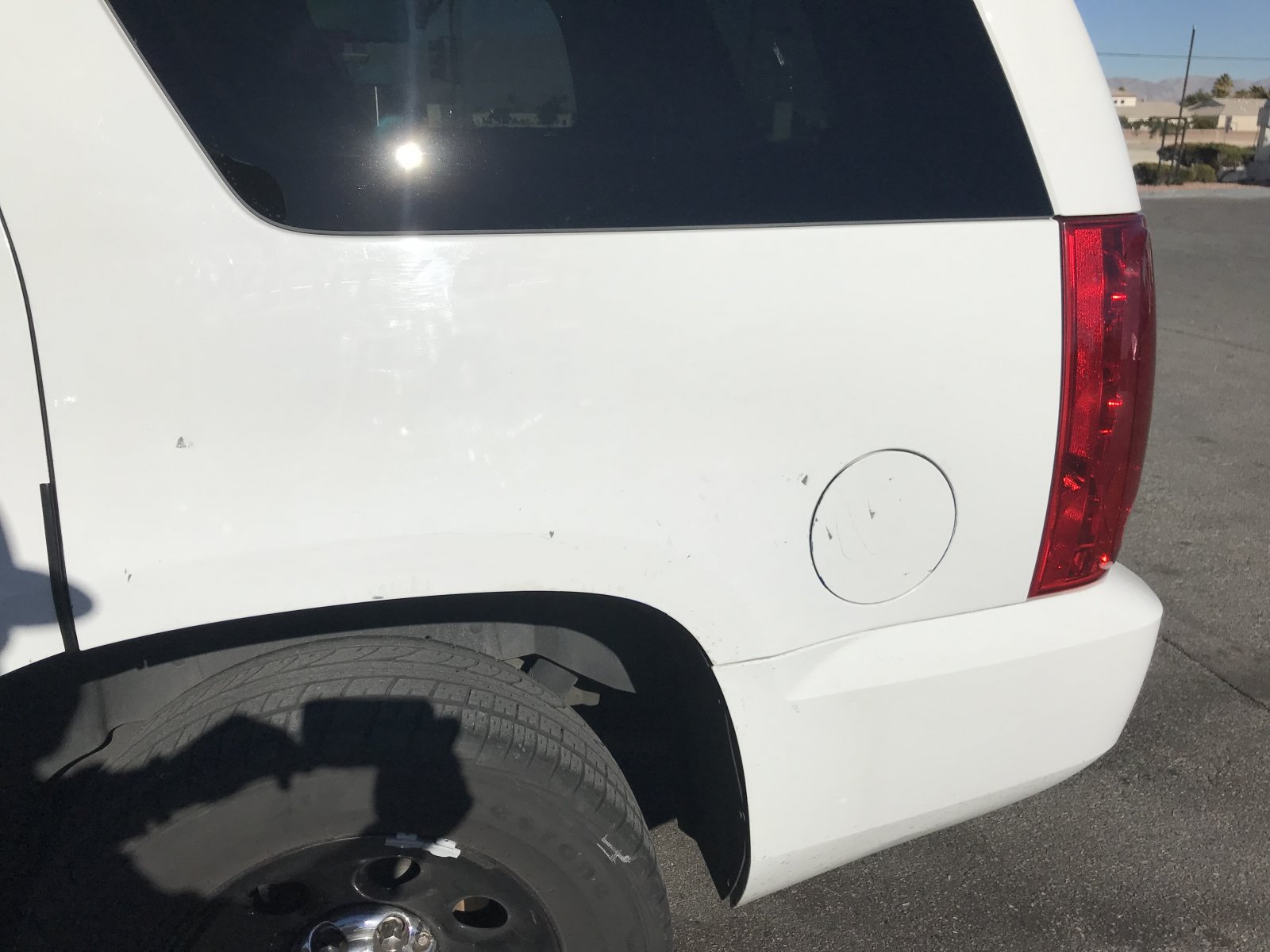

I’m going to Affordable Collision. Shopped around for the past few months. Best offer for the work they will do and what I had seen (base +Clear). They had a Lamborghini and a new Rolls there getting worked on so I figured they did good work. My PPV is in all primer right now. Had so many dings + the savages who did the de-badging used a screwdriver all over and had bare metal scuffs in the paint. Didn’t notice when I bought it at the auction until I brought it home to wash.
Here is a photo right after wash From the Auction, the rest of the PPV was just as bad. Now its all fixed and ready for paint. Anyway, I’m high-jacking my Own post
How much did it run you?
