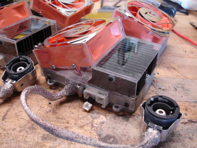

It is more expensive but running oem bulbs, ballasts, and a high quality harness will keep pretty much everything running smoothly and very close to stated wattage. Keep in mind that there is no such thing as an oem 50/55W ballast as none of the major companies (denso/hella/AL Basch/Matsushita/etc) make them, so the only way to get them running at 50/55W is to have them boosted by someone who knows what they are doing ... including potting them, and installing dedicated fans or heatsinks.
---------- Post added at 10:35 PM ---------- Previous post was at 10:25 PM ----------
FYI, this is what an oem ballast (AL Bosch) looks like properly boosted to 55W with heatsinks:
Mucho $$$.

I used to have a set of the modified Denso ballasts that adjusted up to 75 Watts. Been done for years now. Problem is, they don't last very long and are extremely bright. TOO BRIGHT!!! Like said, all OEM is 35 watt. Having anymore is overkill, IMO. to each there own, not hating in the least bit. Been there done that
Lost all my pictures of my old retrofit and ride. But found a pic online of modified Denso ballasts

Yeah 75W is too much ... it will eventually fry ballasts, bulbs, and most projector bowls.
