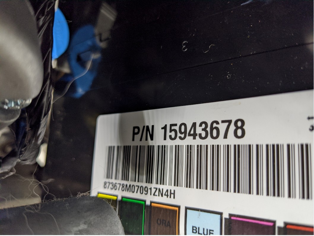

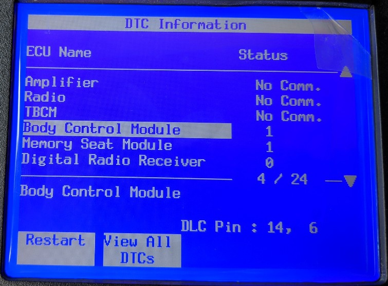

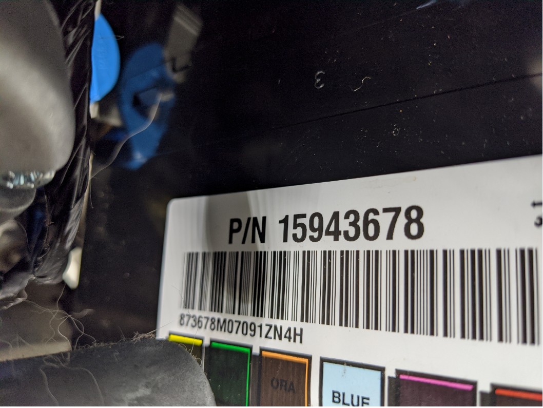

Hi Folks,
I have an update in my efforts to troubleshoot the B1000 Symptom 35 DTC.
I was able to find and access the BCM, and I removed each of the connectors, and each one had clean and straight pins. All wiring appears to be in good shape, as least as far a one can see from the clusters of wires taped together.
While I was there, I took a photo of the BCM part number, in case I need to replace it. This part number, 15943678, is not listed in Rock Auto or in GM Parts Direct, so I did a broad Google search. Turns out, this part number appears to be a re-manufactured Dorman unit.
I used the Tech 2 to reset the DTC codes, and I'll drive the truck around later today or tomorrow, in order to see if the code comes back (which I believe that it will).
If the code does come back, what are your recommendations for my next steps? Purchase an ACDELCO 25835966 BCM from Rock Auto?
I also took another photo of the Tech 2 DTC summary readout, and for the B1000 Symptom 35 code, it has DLC Pin: 14, 6 at the bottom of the readout. Any idea what this is, and is it something that would be useful to me for additional troubleshooting?

Hi Folks,
Thoughts and suggestions welcome.
the scanner is referencing the obd port pin's 14/6 low speed canbus and high speed canbus
30,542
47,986
OK. So, it does not really provide me with any additional information that I can act on?
not from what i can tell, but I think you can run a test on the bcm, if not you can run a test on the all the modules that and would include the bcm that may provide more detailed information
