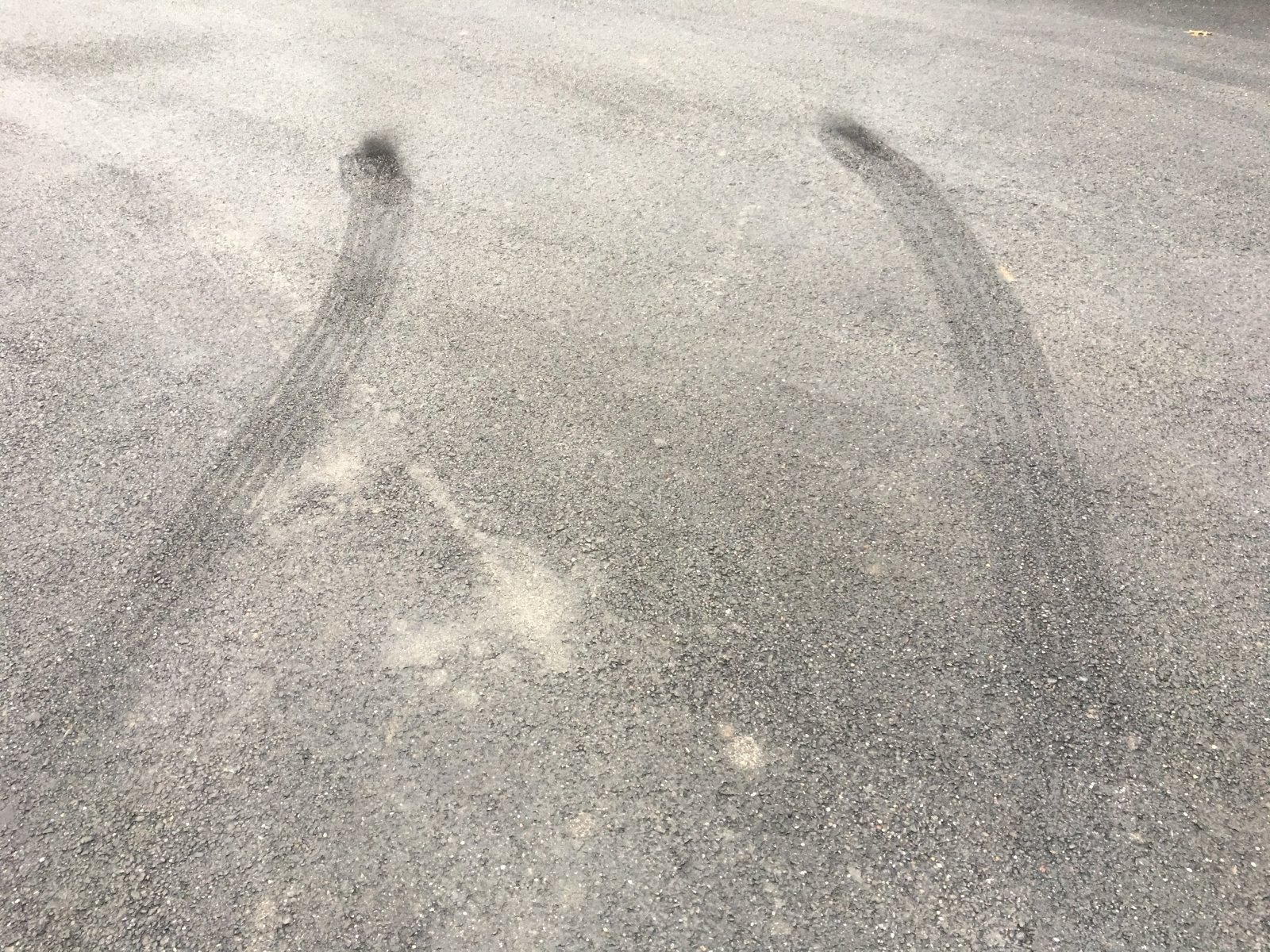

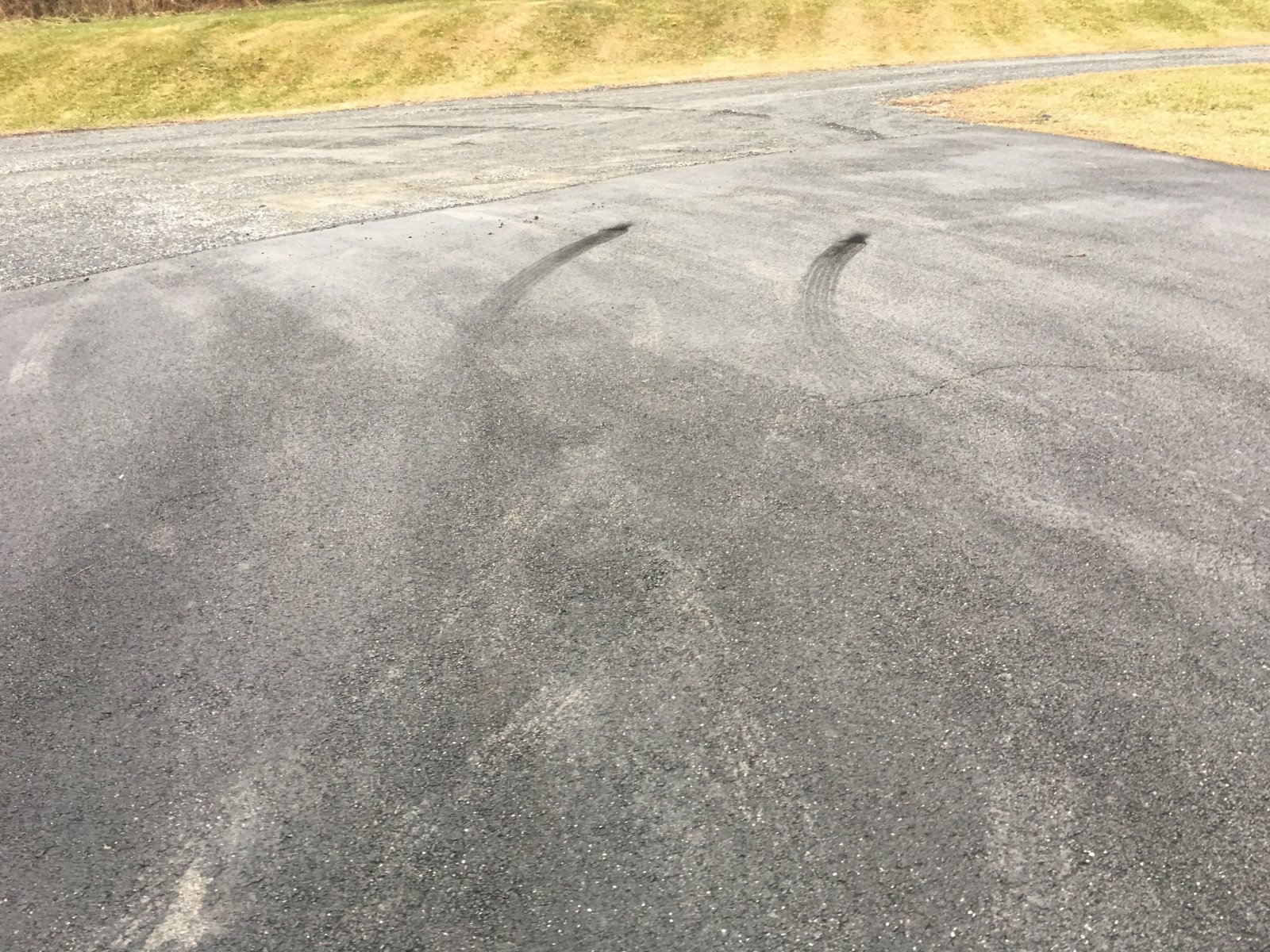

i dunno.... shuts off on mine...

So i push my button and disable the system and power brake it, light up the tires and i have a smokey burny going...but the computer doesn’t really like that, it semi over rides my button push and i can tell it’s still trying to compensate for a ‘wheel skid’ ...many systems involved so that you don’t lose control if the vehicle. in the snow, with the systems active you’ll notice its harder to climb say a hilly driveway because its not letting the tire slip by applying the brakes which doesn’t exactly make for an easy hill climb. push the button and you get slip but no abs pumping and keeping you from moving foward. pulling the fuse or a switch takes it all out of the equation and lets everybody spin as much as they like.
