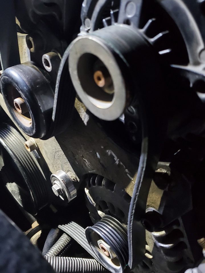

Aaaaannnnd more trouble with the triple alts. Spun a pulley off the bearing on the bracket last night - so now it's parked at a friend's house until I can figure out how to get that replaced. After messing with it in the dark for an hour last night I finally realized what had happened. I couldn't figure out why I threw the belt and why when I put it back on it wasn't tight...
<sigh> It's always somethin'.
That's a new bearing - we replaced the bearings on both of those pulleys. The top one was just squeaking a little and felt a little grinding, so I thought I'd replace the lower one prophylactically at the same time. Looks like I shoulda just left that alone. :(

So last night I pulled that bearing - had to do some additional stuff to shift the #2 alt out of the way, but really wasn't too hard. Remove one bolt, loosen another, tilt the alt and then pull the bolt holding that bearing.
Interestingly, I found my other pulley in the grass about 10 feet from my truck. So apparently the pulley came off the bearing when I pulled into the driveway, which explains why I didn't get any failure lights from throwing the belt prior to that. I don't know what would have caused it to come off the bearing right there.
But anyways, since it had failed once, instead of pressing the bearing back into the pulley, I went to O'Reilly's and just bought another complete pulley assembly. Another $68, but what's that when you're already this far into things, eh???
So I got back, put it all back together and it fired right up, belt is tight, alternator(s) charging, no squeaking or squealing, everything is good. For now (crossing my fingers!). My friend is driving it to his job today, since this was all done in his driveway and I had 2 vehicles there. It was a bit late and I didn't want to drive home and then have my wife drive me back across town to pick it up, I was exhausted after a long day in the office, then physical therapy at lunch, then more office, then climbing in and out of the engine bay - a couple of Maker's Mark probably helped relax me to the point I wanted to do nothing but crash, also.
