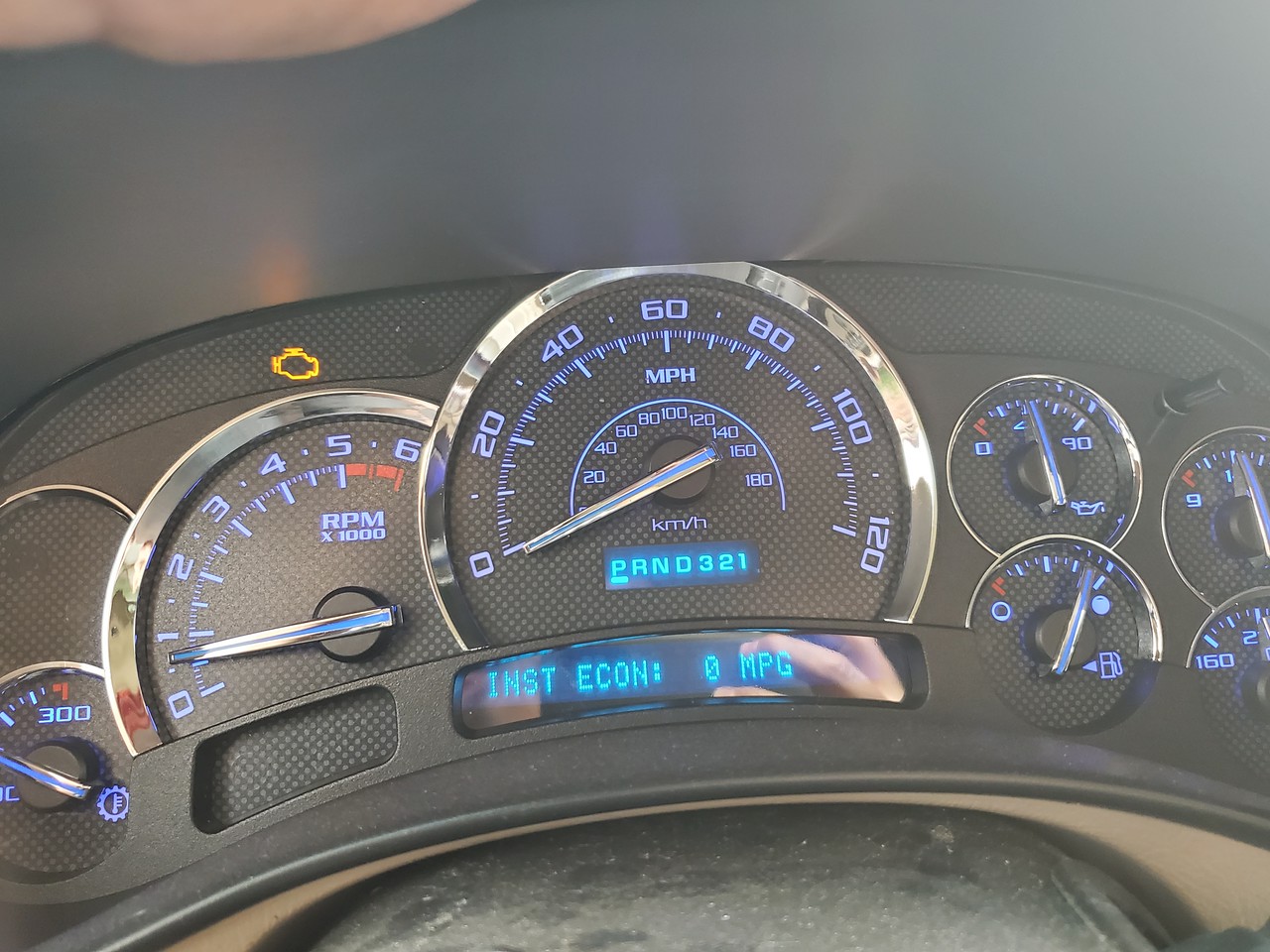

Here's a pic of my new dash cluster in place:
<edit> Ok, my photo hosting site is messing up this morning, so I'll have to do it later...
tRidiot
tRidiot
Dec 21, 2011
377
293
Here's the pic of the gauge cluster. Super happy with it, Digital Dash Solutions did a great job!

Whats that Check Engine Light?
Have you scanned it?
Why do you think your power steering suddenly had a problem after an engine swap?
