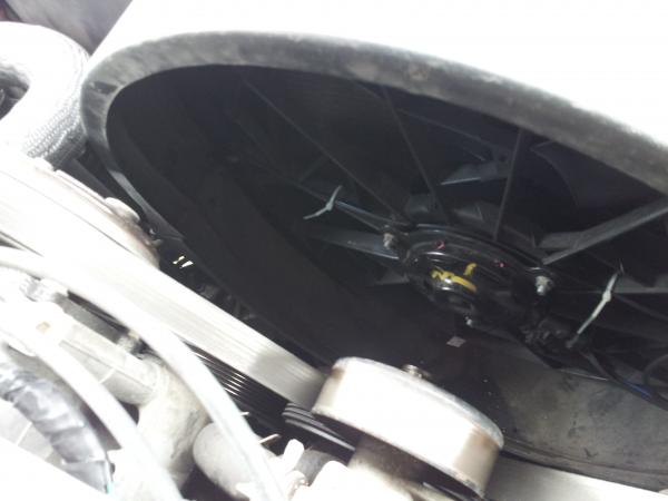

heres mine..........
qukon 95
Apr 7, 2011
556
i did the same thing (kaotic) did with his i mounted it in the shroud.
I used a volvo 2 spd fan relay, a temp switch with the probe, 80 amp seloniod , **** 40 amp fuse holder , wire , connecters, and ,
another small relay for the ground to operate the 1 & 2 spd in the volvo relay and the efan i got out of a 2002 grand marquis. i got
spare volvo relays out the jnk yard i need to get a spare efan. i got pics in
photobucket.com/qcp. one more thing you will need to upgrade the alt.
