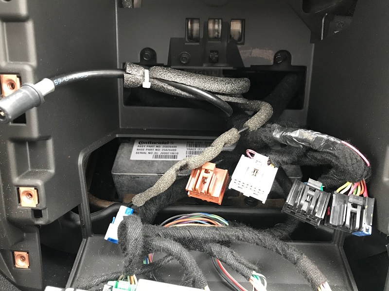

Help identify the stock Stereo plugs

I purchased a Cheap Android Unit for the 07 Yukon XL Denali with factory NAV/Bose/RSE/Cam. You can read my initial review here if you'd like: https://forum.xda-developers.com/an...s/review-hizpo-7-1-2-gm-vehicles-px3-t3755202
I have some kinks to work out but the two main concerns are factory rear camera and factory RSE. I purchased the GMRSAV and BACKUPCAM adapters after extensive research online. I believe these are correct for my model. The confusing thing is the Android unit is supposed to be plug and play and uses all the factory plugs except the factory GPS antenna(blue plug i think). If that is true, either my settings on the unit need to be tweaked or somehow they utilize the harness but not the functionality of those two factory systems.
Can anyone help me identify which of these plugs does what?
Thanks

Brown plug has VSS and backup cam wiring in it if my memory serves me.
Thanks for Confirming. So I am guessing that would mean the gray one is for RSE. I guess I can understand why they would use the brown plug as it provides the VSS but it does not give me video feed from the factory cam. I wonder if I can splice the Video feed wire and solder up an RCA to feed the head units Cam Input?
Yes you can.

So I pulled everything back out and looks like I didn't use the brown plug so ill pickup my Metra BACKUPCAM adapter tonight and see if she works! Also I took a better look at all the inputs and outputs left available after the install and by trial and error I got the rear screen to work but only when I choose DVD. I need to figure out how to get it to mirror the screen all the time.
