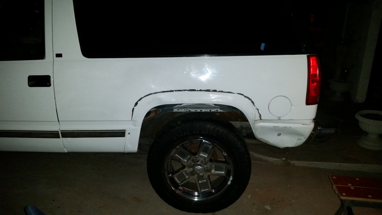

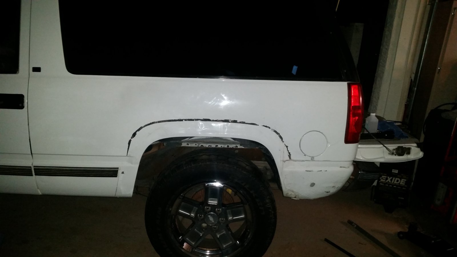

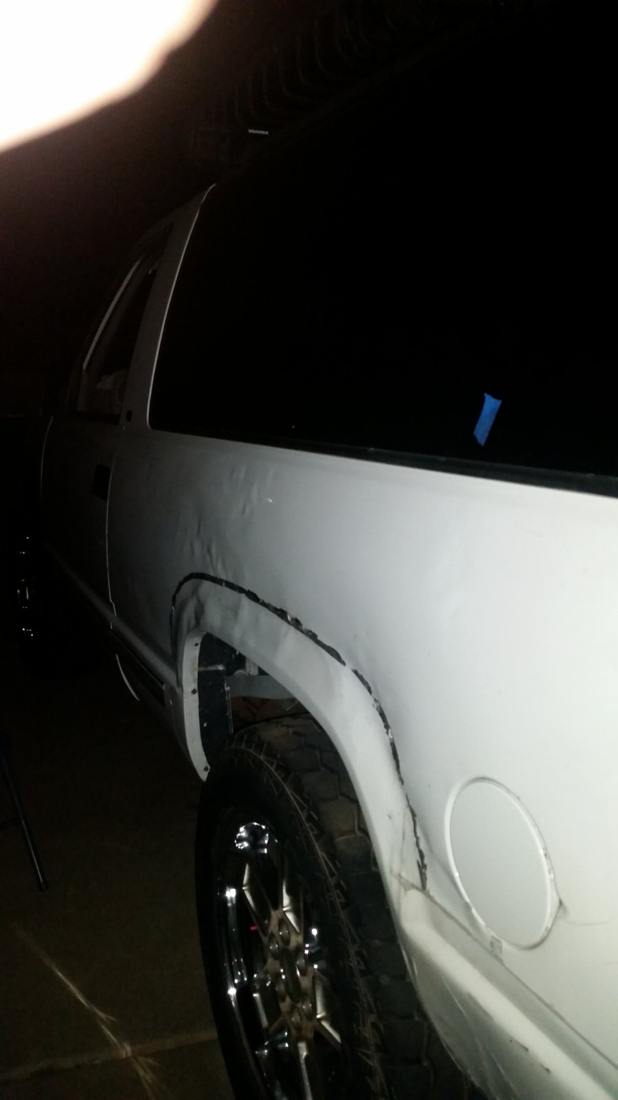

Did you find one? or did you have to cut one off another 2 door and trim it to fit. I have the same issue, daughter was hit at the rear wheel, by a GM Denali. I've done the first round of pulling the dent, using the paintless dent repair methods. 2nd pic shows work in progress. The 3rd is another angle to see the dent... Could skim coat it and be done... but I want to grind it down and use my stud welder to bull some more of it out and hope to use just a high build primer on most of it. Found prior filler below the fuel door, will need to be DA down as it's all cracked.
View attachment 207196 View attachment 207197 View attachment 207198
No one makes it. I cut out the rust, used great stuff expandable foam and bondo. Sanded, painted, then bed liner .
