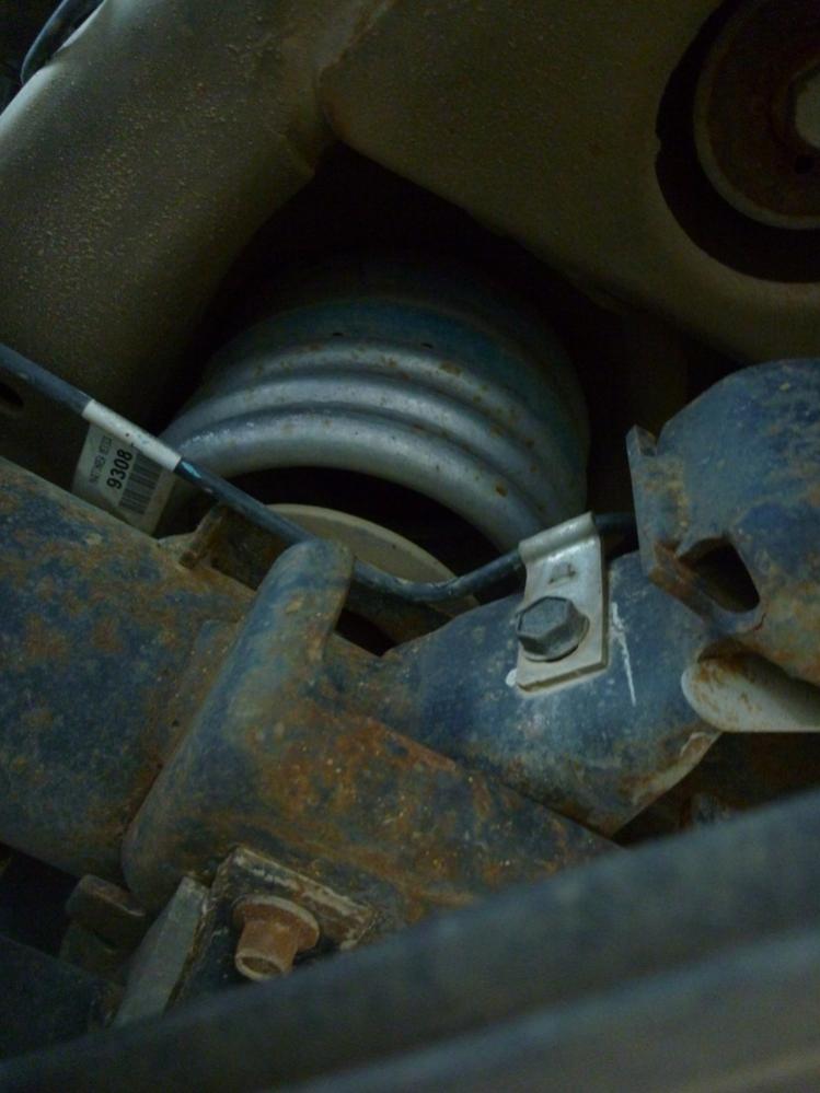

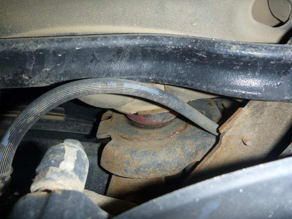

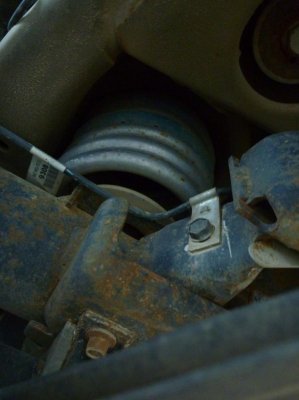

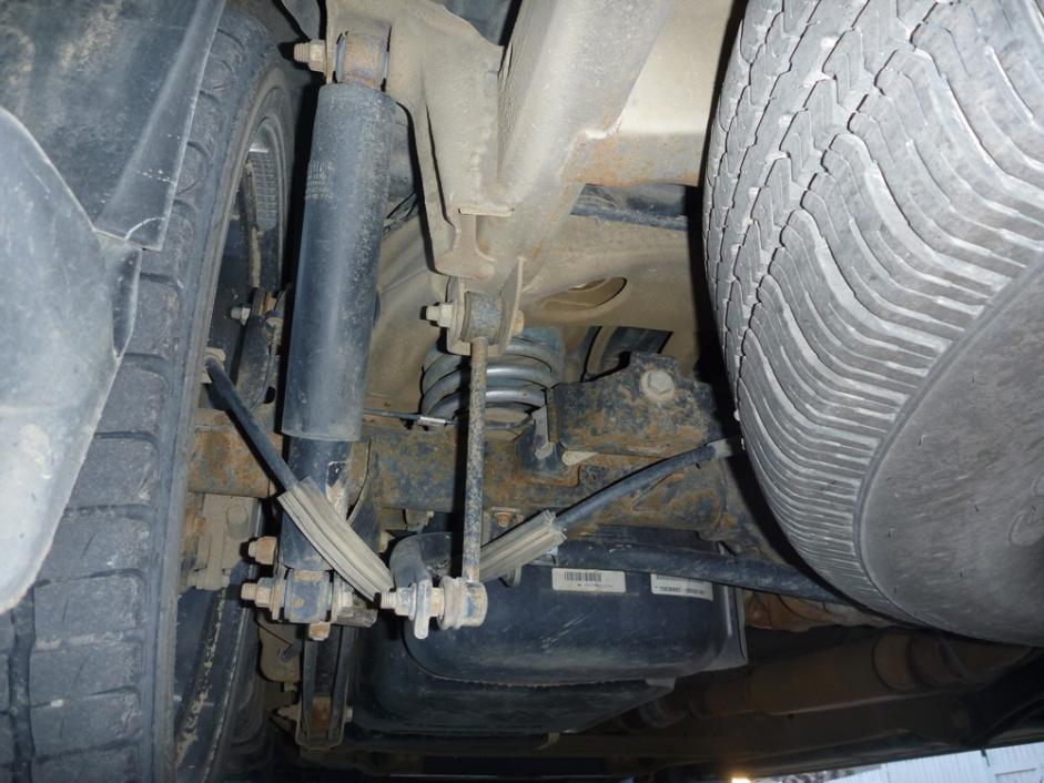

Here are some pics. I know they are bad angles, I lost my lug key so I cant take off my rims right now :emotions122:
If you look at the pic with the bump stop, its only about 1/4-1/8 of an inch from the frame, that might be my prolem!?!?!?!
I think im going to put some air lift 1000 bags in tomorrow to see if that helps. I will need them down the road when I pull my jet ski and other trailers around.
Any other suggestions on how to improve the suspension??

ok theres the problem on ride.
1) cut the bumpstop brackets off the frame that will get you more clearance.
2) the rear belltech kit comes with spacers id put the spacer in to lift the rear back up that will make it not look like rear is lower than the front.
trust me do what i said above and ride will be much better.
man look at that swaybar angle. This is why i recommmened the rear djm hardware kit with trailing arms fixes that and when you adjust the swaybar back up ride and cornering is improved.

you can drill and tap the frame and use those mounts. If not i have the ultra thin djm ones which are like 3/8 in width and work very well also.
that rear drop is a 4-4.5 drop ive noticed the belltech springs tend to sag over time. A member i just sold a kit to put up pics of his rear brackets cut in this section and you can look at that for reference. Once you cut the brakets off and put washers for the shocks it should ride a lot better. Oh yah get that spacer to lift it up so rear wont look lower than front and your set to go :)

That is def. a 4.5"-5" rear drop, and that has good chance of sending impact into the frame to cause that clunk. Also looks like Belltech 23302 coils, though rust has taken a toll on your frame.
Trim your bumpstops as low as possible like I did to get more travel. Mine are about .75" from the frame, and I only bottom out over certain bumps. But with my new 5125 shock install tomorrow, I bet I will not bottom out mush anymore becuase those are some high pressure shocks.
Also Helper bags are just gonna stiffen your ride and jack up the rear at the same time, most likely you will not like it.
I would just pull the bumpstops completely if I were you.

He was referring to people with aftermarket Belltech shocks that amke noise. That does not include you since you have stock shocks.
Also you have the non Autoride shocks (by your pic), so you could always get drop shocks to make the ride slightly better.

derk at this point i would look into new rear shocks. your stock shocks have been set up at this height for how long and most likely valving is damaged anyway. I would get shock extenders/new rear shocks belltech street performance.
Lets start off with the basic stuff. Cut the bracket off and add the belltech 1 inch spacers and then see how it is at that point.
