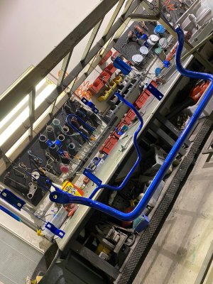

I did go with Hellwig for the Duramax. Solid heaveier firm setup. Had them powder coated before installation for added protection and the look I settled on for r

Just ordered Front and Rear Hellwigs for my 2013 Tahoe. What did it cost to have yours power coated? I like the look. I will give an update on my install
