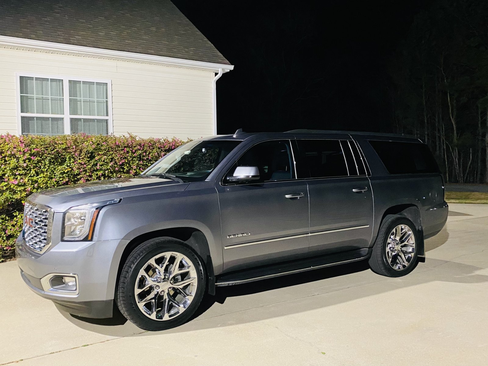

It has the 10 speed auto in it. It has 80k miles on it. This is the only pic of it I have. Wife took this pic when we got it home the other night. It's very clean, was a one owner car, previous owner took it to the dealer for everything.

The range disables the DOD which cause lifters to collapse. It only works for the 2018 not the 2019-2020 with rhe 10-speed. Also you should change the oil using Dexo 1 certification. The lifters usually have issues around 60k and up. I would change the VLOM right away if your truck has not had the lifters done yet. Your truck is beautiful. The Michelin Defender is a better tire. You should change the license plate bulbs to LED 921 which they sell at autozone. Check the A/C filter to see if it has been changed. I updated my map data to 2023.
