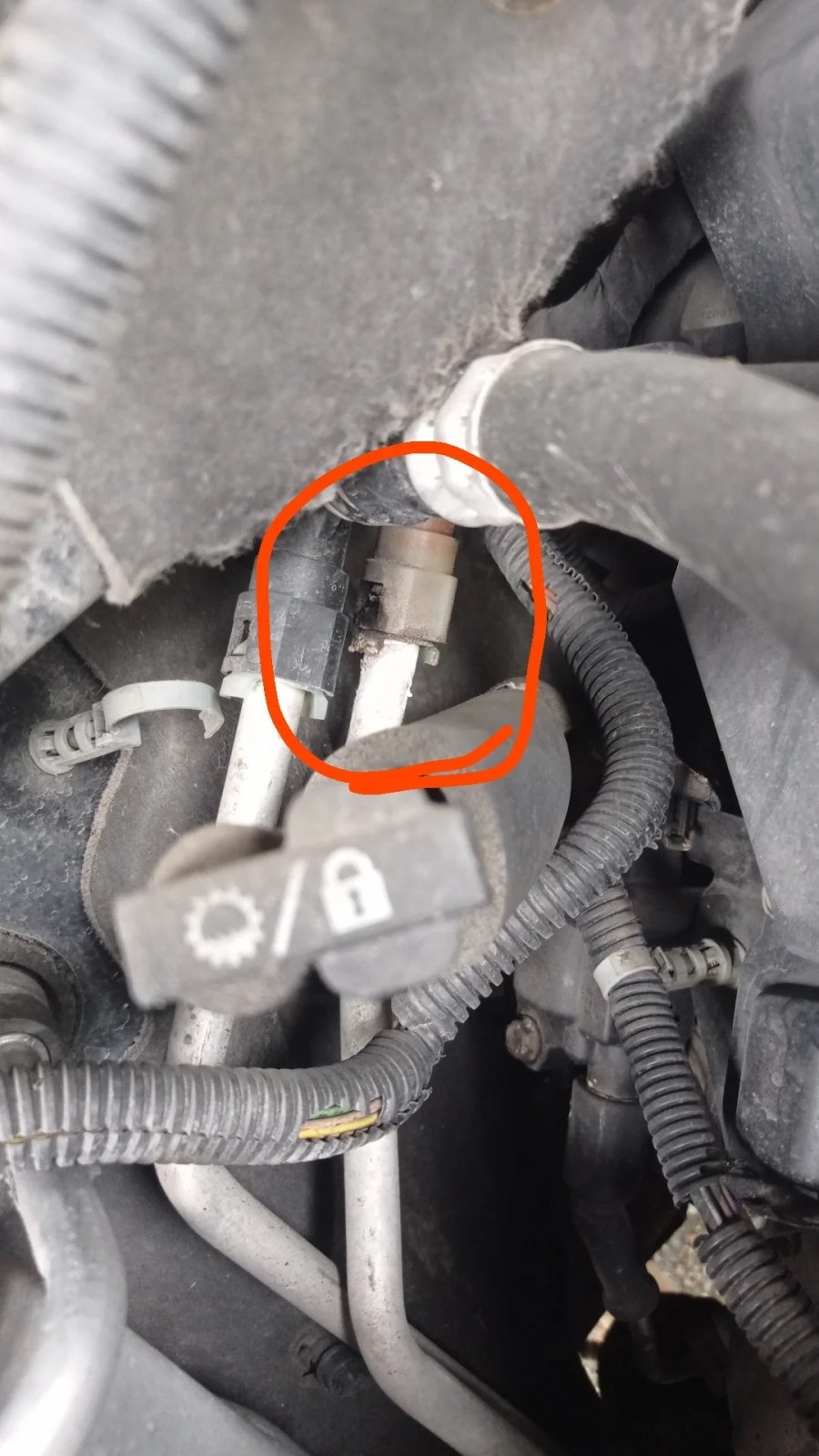

Yes, if the leak is on the engine bay side of the firewall, and you have rear heat/cooling, then it is most likely related to one of the plastic Tees, or one of your heater hoses is close to imminent failure near the Tee. The plastic Tees get brittle over time from the heat.
If you find the leak to be directly related to a Tee, then you need to replace both of them, and there are existing threads discussing how to best remove these Tees, as they can be uncooperative. IMO, use only OEM replacement plastic Tees, or the Gruven metal Tees. When you change out the tees, be sure to wear gloves, as the firewall insulation is quite aggressive, and your hands will itch for days.
Last, if you have not changed ALL of your hoses related to motor cooling and heating and reservoir, you absolutely should do this as part of the project. The manufacture year is often stamped on these hoses, and they definitely deteriorate over time, and it could leave you stranded somewhere.

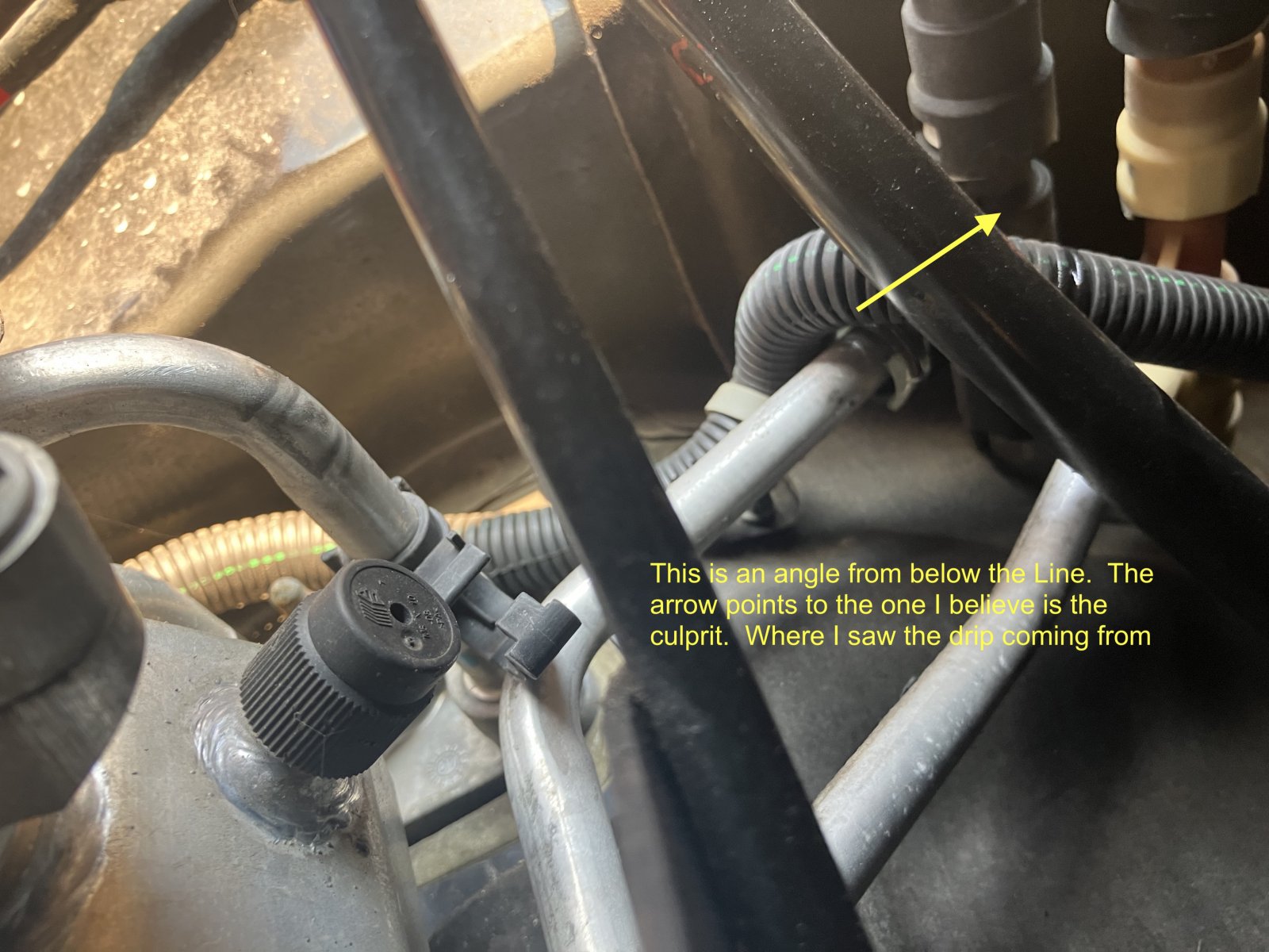

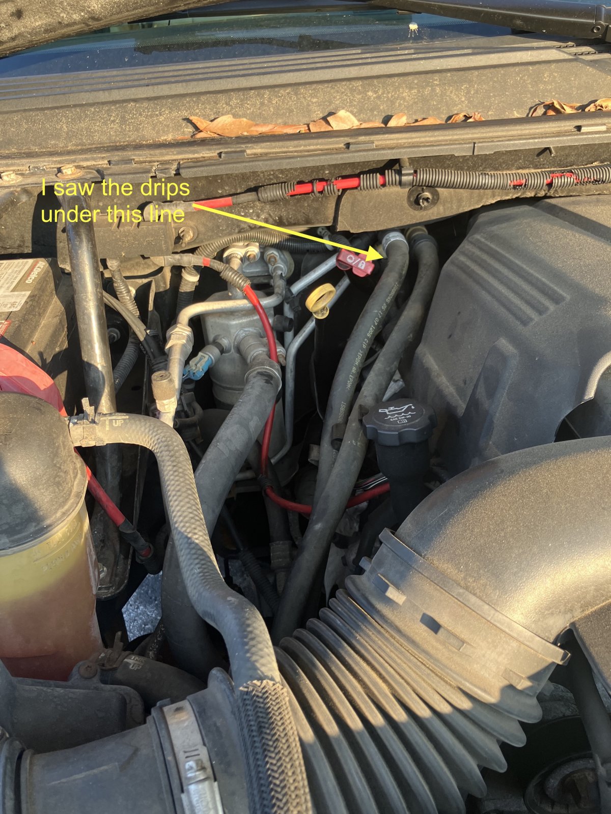

Hello Everyone. Thank you for the advice. I apologize for not getting back sooner. I just saw these replies. I think I must not have set up notifications properly, ... or something.
And, yes. It would have been a good idea to post photos. So, here they are. It looks like you are all on point. I will see if I can find the threads that talk about r&r the Tees. If you happen to have a link to any of those threads, to make it easier, I would
p.s. I agree. The photos also show the truck needs som TLC.

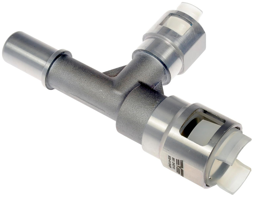

Worthy of adding a Sticky Thread here for the Dorman Metal Coolant Tee's:
Vehicles with rear heat use these Tee's, you need one of each:
#800-414HP
#800-413HP

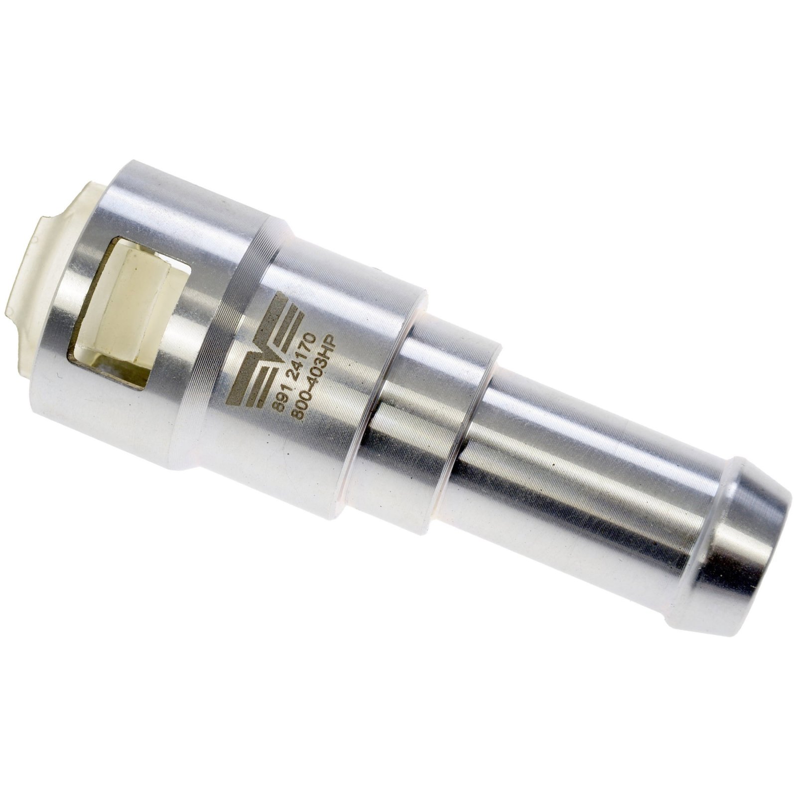

Added 10/1/2025: Dorman metal fitting to replace the straight plastic fittings that plug onto the ends of the above Tee's:
#800-403HP (use 2 each)
They install just like OEM but being metal wont get brittle and break.
How GM should have done these from the very start.
