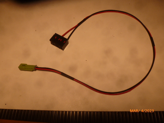

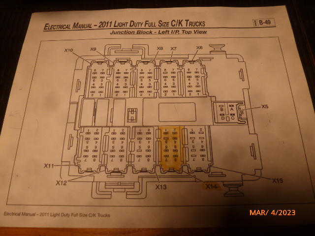

Picture is the harness I made for my 2011 Silverado to connect the column side of the clockspring to the under-dash Junction Block, cavity x14. This is for switch power and a ground.
I am not sure if the Tahoe has this Junction Block and an empty x14 spot for a connector. P1090040.JPGP1090041.JPG

Where did you get the connectors/ends? And which PIN numbers on x14?
