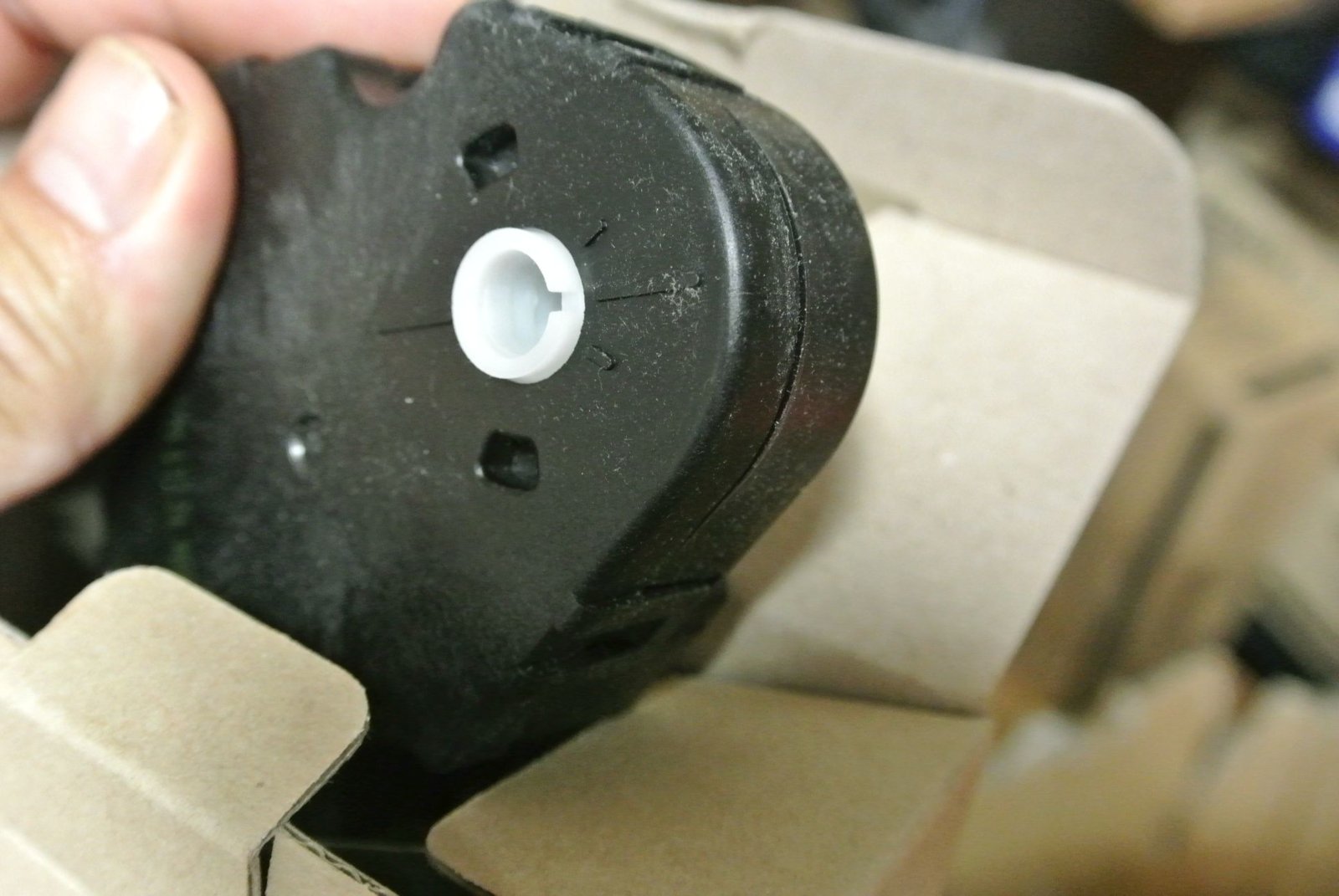

you can pull the cover off under the glove box and visually watch the actuators to see if they rotate when making adjustments on the controller, they have a round slotted/hole, watch the hole to see if the mechanism moves or not.
some have a plastic slot and some are metal not sure which anymore on the nbs but they all operate the same, but this what you want to watch move
**also different actuators do different things some direct air up/down, some divide the hot/cold, so if you don't see one move then just move the controller to up/down etc. if it doesn't move for any setting then it may be bad.

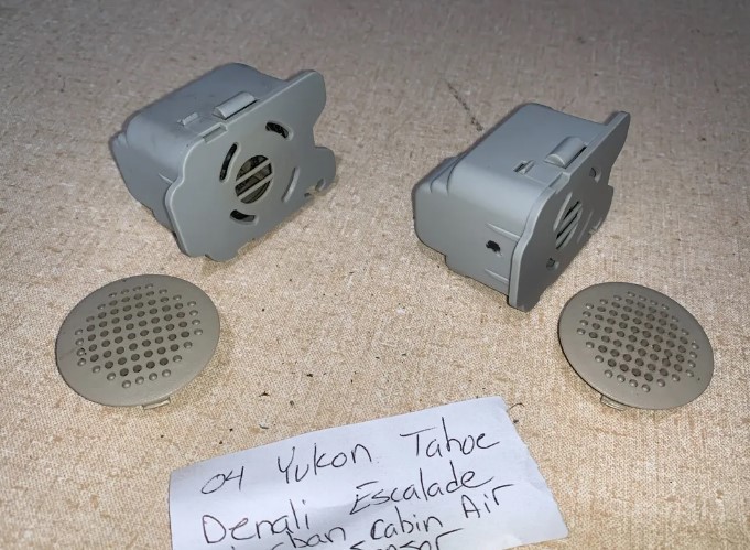

I'm not sure if this applies to all GMT800 GM trucks and SUV's, mine is a 2003 Yukon Denali. If your heat only blows hot when your dual climate control is set to 90 degrees, I can tell you what is probably not the issue. It's probably NOT blend door actuators, your climate control module, blower motor resistor or recalibration of your blend door actuators by removing fuses. And if it's blowing hot when set to 90 degrees, your heater core is likely fine. My issue (and dozens others with the same symptom on different forums) was the cabin air temp aspirator (air temp sensor) right above the driver's left ear in the headliner. You can still get these genuine AC Delco parts (P/N 22834330), they're about $40 and they are upgraded with better support for the thermistor. The fan inside mine was fine, the thermistor failed. The fan can also fail too or make a buzzing noise. There are lots of replacement videos online, should take about 15 minutes of carefully peeling down the headliner to access. Good luck.

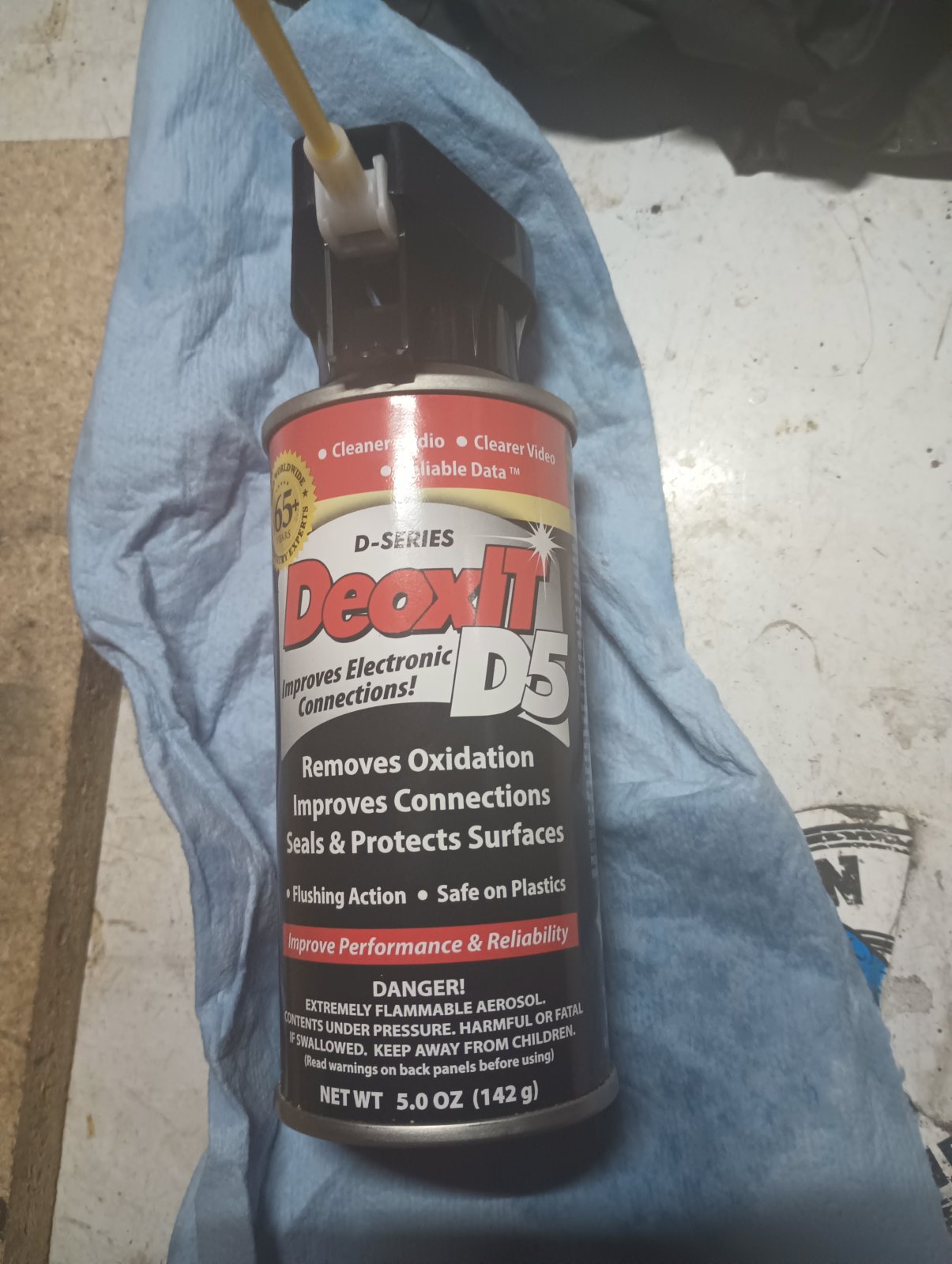

Thanks posting this! I've been having this problem since I bought my 06 Suburban a few years ago. I thought it was my controller.
Last night I popped the little grill cover and sprayed some Deoxit in there and this morning my temperature worked!!!
I also sprayed the knob (removed the dial) but it's kinda tight in there and I don't really know if anything got inside.
