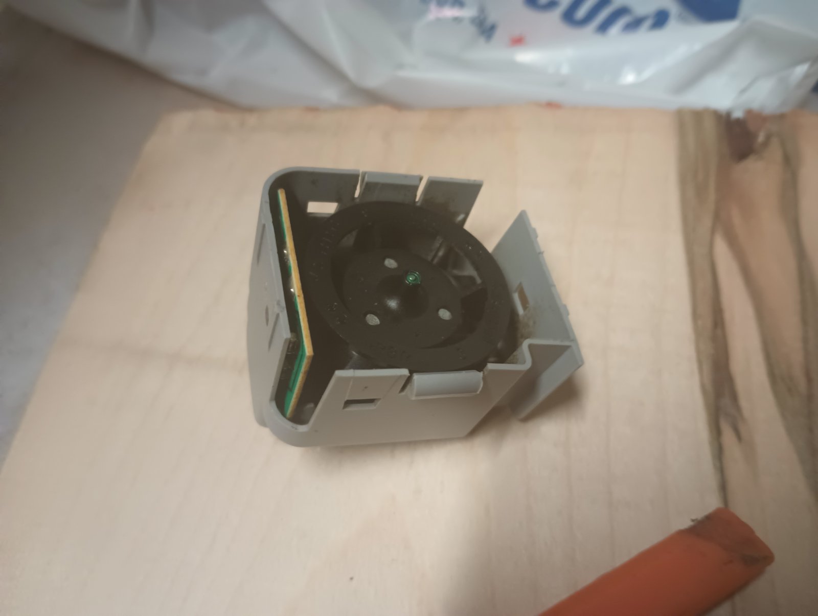

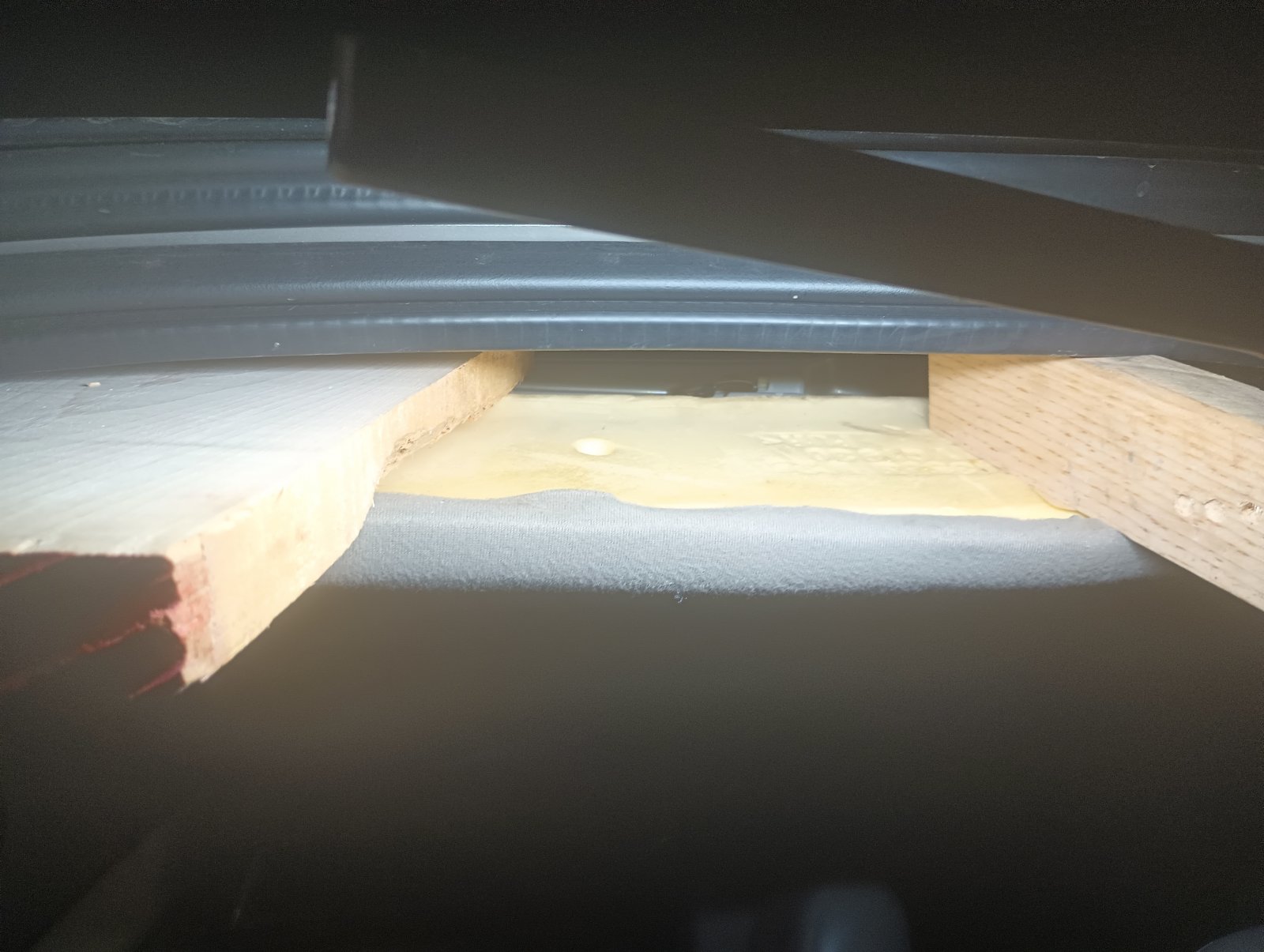

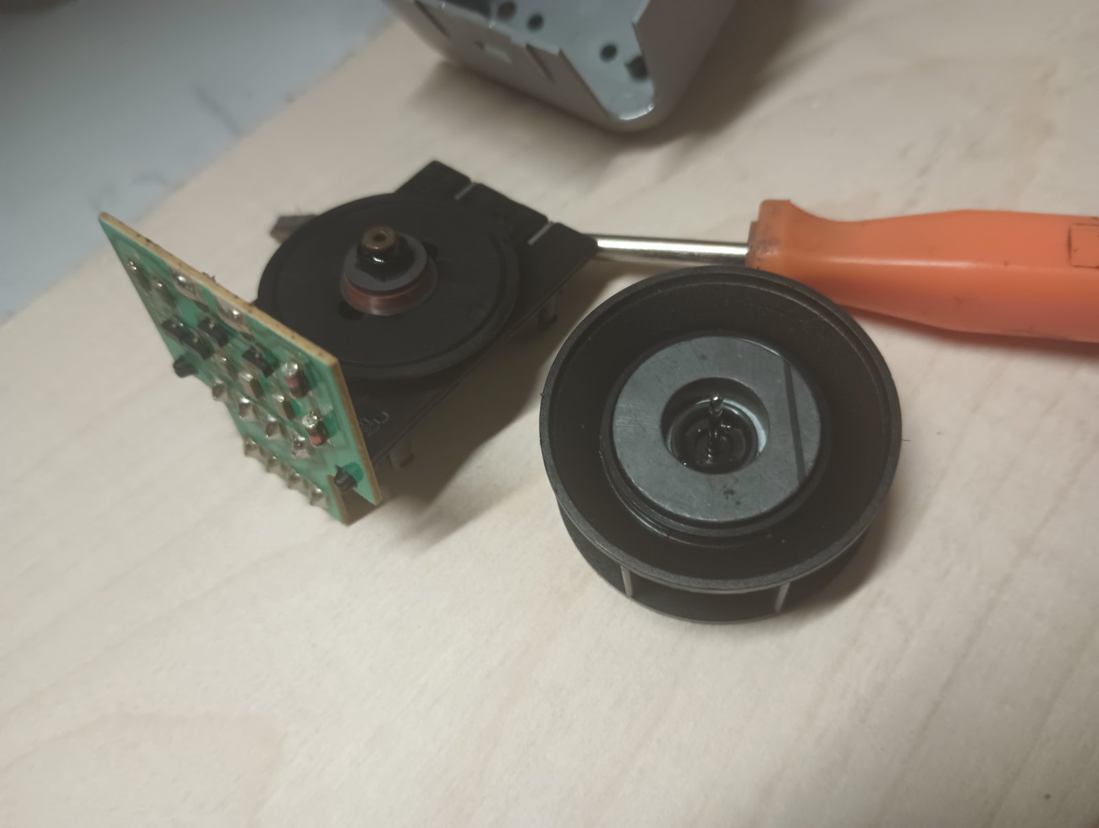

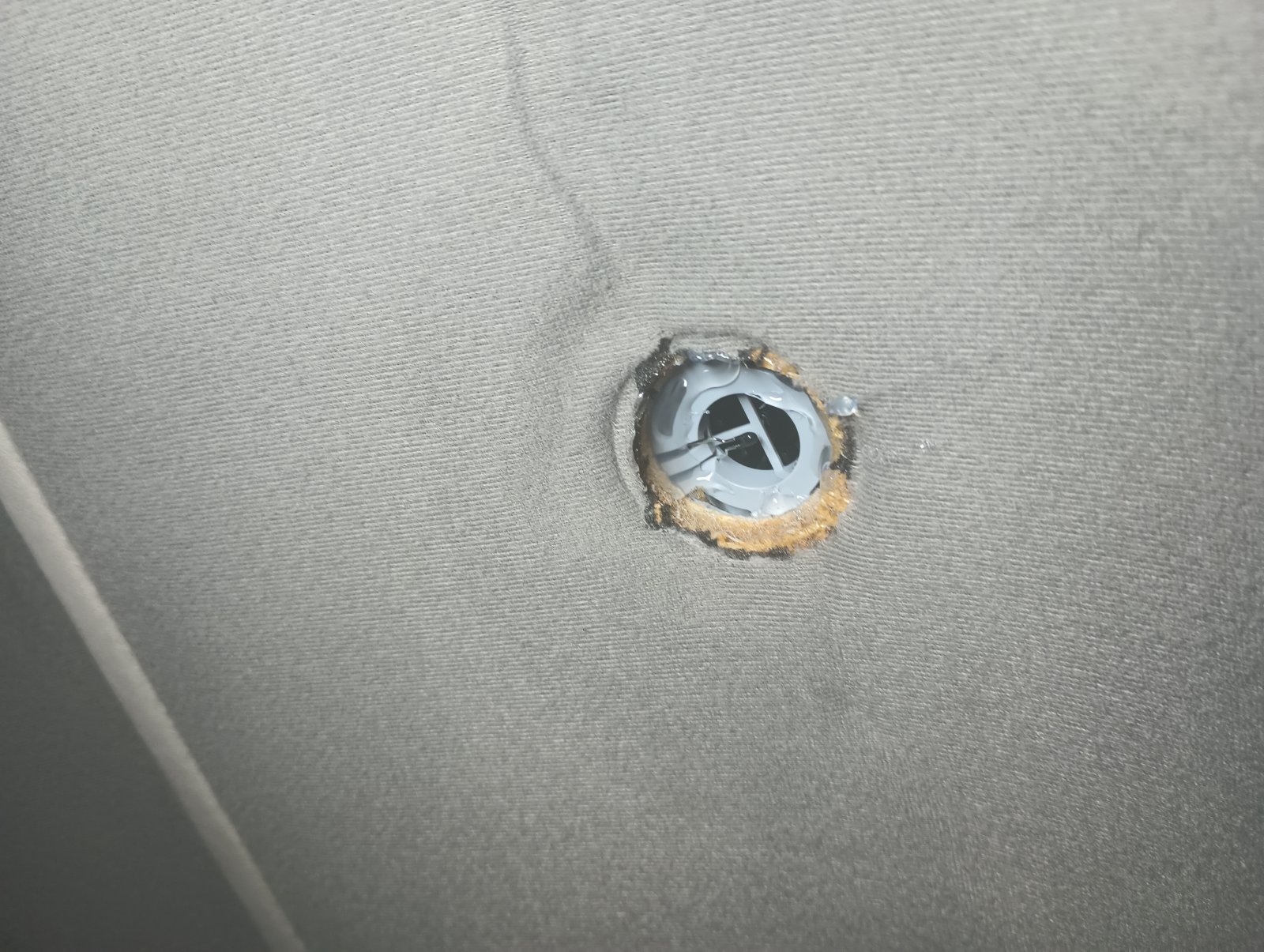

Actually, I spoke too soon. Truck is back to doing the same thing. Doh!
I ordered a new temperature sensor...
Ok, I just installed the new sensor. It's fixed!!!
I did add a bit of hot melt glue because it wanted to get push out to one side such that the fan was not on the hole.
I wedged some boards in there to get the harness unplugged, but still a little tight. I took apart the old one and the wheel didn't spin freely, even after adding a drop of lubricant. The wheel just slides out.
