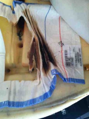

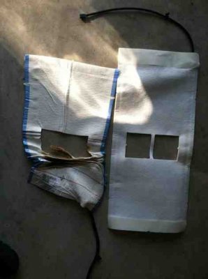

Turned out to be a burned up element. Take the side trim off (7mm up front and some clips) then look under the seat for where the leather clips to the frame. One big clip on the front, one small on the side and another Velcro piece toward the seat back. Pull the leather up and over the cushion back enough that you can see the heating element.
The element just sticks on so it comes off easy. The harness runs to the back, toward the middle of the vehicle. Just trace it back and under the seat and unplug it. Be careful as the metal used on the seat frame is extremely sharp. Then just install the new pad, stretch the leather and clip it back into the cushion and you're done! ImageUploadedByTapatalk1359026990.024927.jpgImageUploadedByTapatalk1359027002.133938.jpg
Element was just under $50 at the dealer. Works like a charm now.
