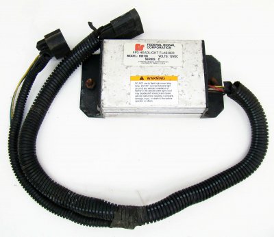

take a couple screws out of the passenger side front splash guard between the front wheel and the back of the bumper they should be 7 or 8 mm when you have a couple out you can pull it back and look inside with a flashlight. basically behind the front right headlight.
should be a black module with wires, could be aluminum also depending on the module, should look something like this

that one was for a Impalla, but there not all that much just depends on the name I guess a few different company's make them and a bunch of china brands out there also.
