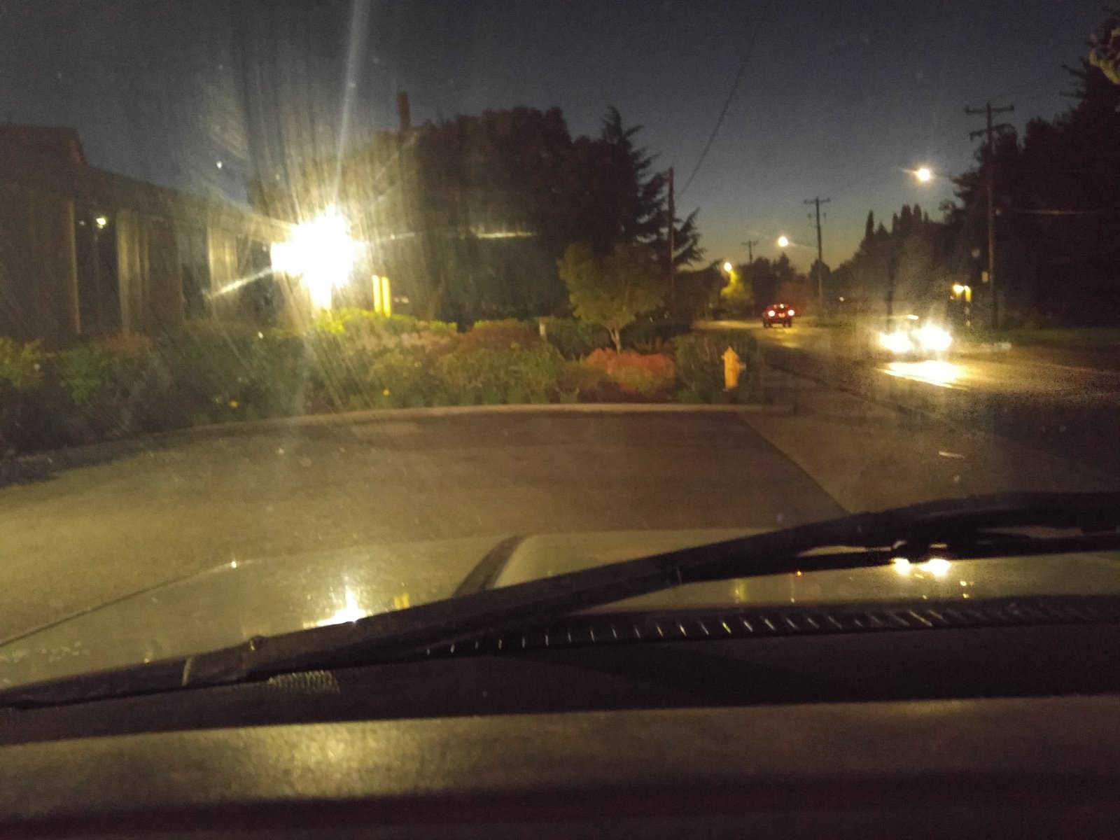

So. Got my Yukon a while back and was not impressed with the headlights... not very bright, yellowed out lenses, etc.
Picked up these stupid things:
https://www.ebay.com/itm/FOR-94-99-...741046?hash=item5926f5eef6:g:Y~MAAOSwhEdc-dDD
... along with some new bulbs.
Put them in and THEY SUCK... I mean they are an absolute HAZARD.
Here are some pics:
This is driving along a lit street at night/dusk
Here, TWO pics... Im in a parking lot and the bushes are about 50ft ahead. Pic one is lights off, pic two is lights on
Finally, this is a pic driving along an unlit road in my neighborhood.... note the orange light... my TURN SIGNAL is actually lighting the road better than the headlights....
This, obviously wont do.
SO what the hell is wrong with these lights I got? Is it just the design of the reflector inside? Is it the glass? I dont get it.
What do you recommend putting in there for MORE light hitting the street?
Ive been looking at HID kits, but if the headlight housing is the problem, either the reflector or glass, putting in a brighter bulb isnt the answer.
At this point I am ready to remove these scumbags and do whatever is necessary to get some light on the pavement

They were adjusted. They hit the same point on the garage that I line my Tahoe and Silverado up on.
Bulbs are Hella 55w halogen
High beams appear a little different because they are not as white as the low beams. Still, insufficient lighting

Sometimes the aftermarket reflectors in the housings can be crap, only thing I can suggest is try some different ones, when shopping for new ones try to get a good brand name like eagle eyes, look at the reflectors in the photos they should look like the stock reflectors, the clear ones are certainly nicer looking than the ones with Amber marker lens.

I'd suspect you got what you paid for, cheap Ebay Chinese aftermarket knock-off junk. I'd chalk it up to a "cheap" loss, find yourself a brand new set of new OEM GM Lights, you'll pay more, but get the quality you want. LMC Truck might be another option, and again they'll cost more but might likely be OEM.
You've probably noted just how cheaply made they are built in regards to the adjusters, and everything about them.
I know many such lights and housings come with Lamps-Bulbs included, they too are likely garbage. Again you get what you pay for. I've had good luck with PIAA Lamps on both low-high beams.
Were your stock lamp housings really that bad? Is it possible you might be able to clean these up with some varying grades of wet sand papers and compounds and polishes? Then coat them with a good Ceramic Coating such as Carpro CQuartz, or Carpro DLX. Regular Waxes and Sealants just won't last, and hazing-clouding will quickly return since you then likely removed any-all UV coatings that might've been left on the lenses.
Lastly, and while not much help when using low beams, but are the icing on the cake when needing your highs might be to install a Hi-4 Kit, thus when needing High Beams, all 4 Beams light, rather than just two. It makes a considerable difference on dark country roads.
I've always felt the stock lighting on these Tahoes were absolute shit to begin with, inadequate.

I understand what you are saying, cost wasn't a factor, and that you initially thought you'd be fine with these new sets of housings.
I do believe your first thoughts in that no matter what Lamp you install in them, they just aren't going to do the job, that I'd agree something is not correct with the reflectors and the design.
I'd say something like this would be the way to go.
https://www.ebay.com/itm/OEM-150349...mzFdefkR:sc:ShippingMethodExpress!60612!US!-1
They sell both sides. You might get away with all the other existing lights in your kit if they behave OK, aren't fogging from leakage. Those other front lamps aren't really what lights up the road.
As for alignment, and rather than relying on how the lamps aim from only a few feet away in a garage and where the beams hit the wall, you'll need to get further back. I'll try to quickly find another tutorial in which you back further up, about 25' or so, and then adjust.
