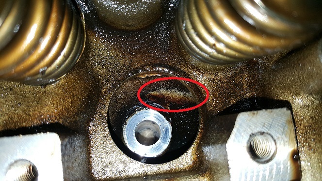

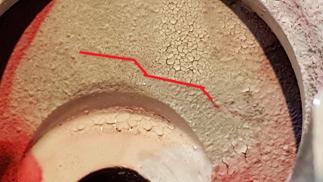

Got done cleaning all the valves and rebuilding the lifters. The washed out area on the passenger head that looked suspicious seems to be a crack. I used a two part red penetrant and developer. I had to edit/highlight the crack because I sprayed too much developer and it covered it up.
This is all preliminary checking and I still want to pressure wash the head today and redo the developer test. Still wondering if it is worth having a machine shop do their own tests regardless of what i find? At this point I am tempted to just slap on a head gasket, button everything back up and live with it. Although re-torquing the head may result in elongating the crack.
Really looking for ideas here. A new GM cylinder head is $400. thanks.

I'd look for another head, or even a set. They're plentiful in the yards, unless this is your dd. Or even repair the crack.

what did you find when you lifted the heads? head gasket obviously failed?
the updated valve covers just come with an internal baffle to help slung oil stay out of the pcv tube, not sure of outlet size but shouldnt be hard to adapt.
heads??? id say bring it to the machine shop and let them decide, they look at heads all day and would probably have a better idea of what may be acceptable and could prob tell you before doing any thing to it (spending money on it). machine shop may also have a head laying around, check craigslist...i wouldnt buy a new one from gm.
Unless your 110% sure headgasket was your issue, I wouldn't reuse the head, would suck to put it all back together just to have same symptoms all the gaskets, tty bolts, fluids youd have to buy again would have bought a new head

The local engine shop said they will pressure test it for leaks. The charge would only be $25 if they find a leak. $150 if it's found to be ok. They would then continue to resurface..etc. If I chose...new valve guides and seats would bring it up to $250. My lifters, rockers, valves and Springs are A-ok.
They said they can hook me up with a another one if need be but my concern is that they may be used.
Not sure what Tony was recommending as far as repairing the head. From what I've read online cracks in cast aluminum heads are supposedly irreparable. GM even says to discard the entire head if found to be cracked.

I've never repaired a cracked head myself, I was just going under the assumption that a cracked aluminum head could be repaired. Depending on how bad the crack is, I don't see that it would be impossible--BUT--if it is cracked, I'd try to buy another head, if possible.

Definitely not impossible depending on the extent of the damage. A quick google search shows you drill and fill the crack with a screw. Supposedly it stops the progression of the crack.
Advance Auto has a refurbished head for about $230 after core return.

Is it possible that you have Castech heads? They crack from bad design--reinforcing ribs left out which allows the head bolts to compress the head too much. One sign of this compression is a clean spot around the head bolt and slow leakage of coolant over several months usually. They are not repairable. The problem is inside the casting.

Apparently it doesn't matter. My local machine shop said it almost always happens over time to one of the heads.

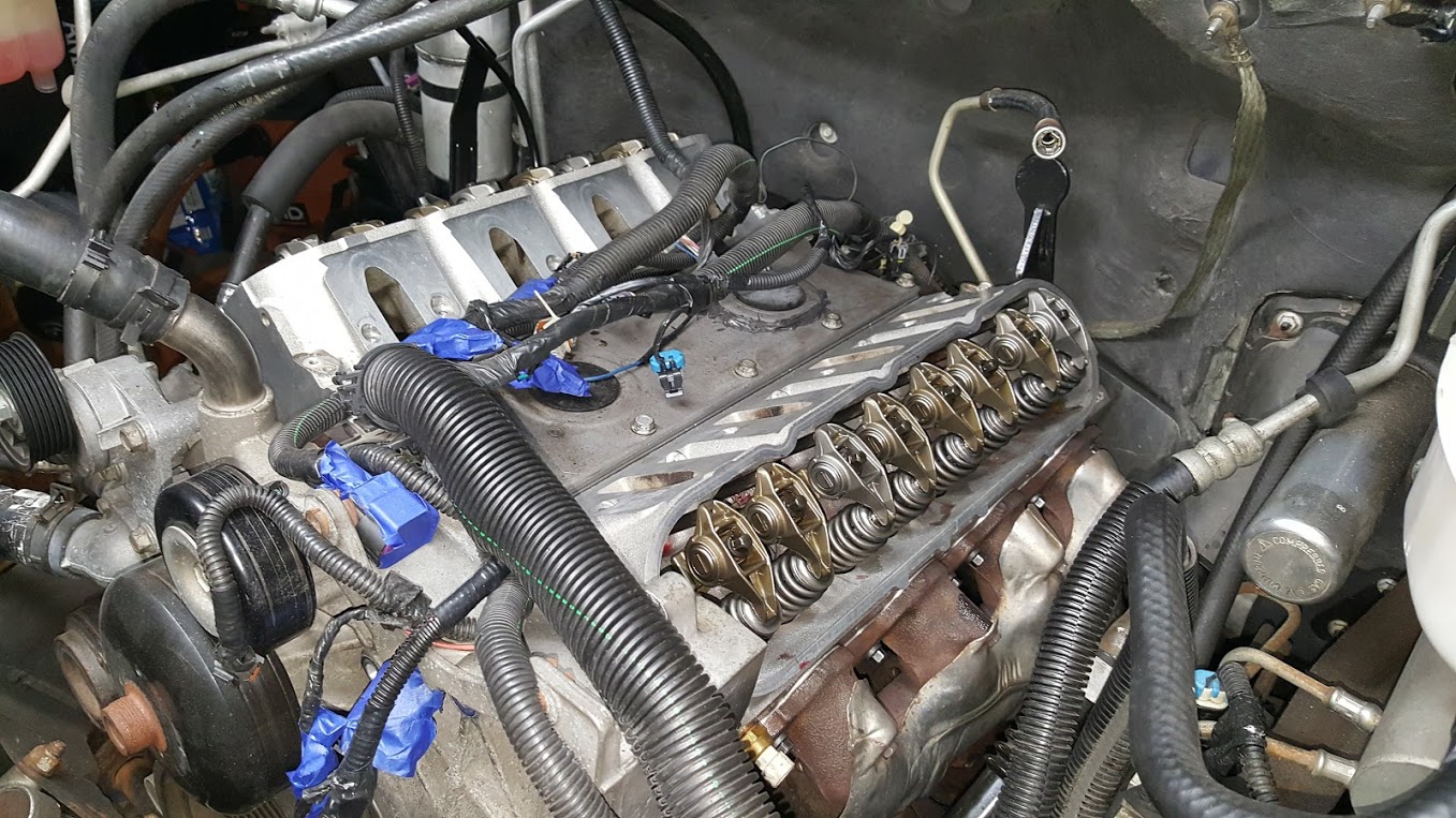

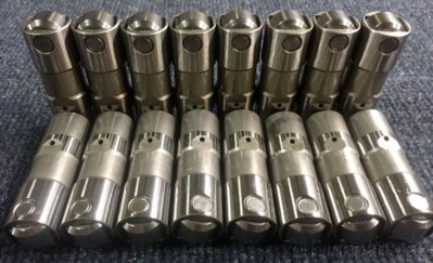

Just an update. It has been a while to complete this project. Taking my time I guess. About 3-6 hours every weekend.
As it turns out most of the time I have spent making orders and waiting for shipments to come in. I have had to replace all 16 lifters, 5 push rods and 5 rocker arms, clean and sand both exhaust manifolds, clean and degrease everything, heads and remove and install all valves, have heads machined to .006 thousandths. Clean, pressure wash and do all that. Cleaning engine block deck took a long time using a razor blade, carb cleaner and wire brush. Also had to check all clearance measurements and replace oil dipstick tube.
I only have the rocker arm covers and intake left...plus all the little stuff. Shouldn't be more than a day or so left.

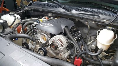

I am going to change the oil and put back in the old coolant (filtered somewhat) so I can flush it again tomorrow. Here is what it looks like thusfar.
Your eyes aren't deceiving you. The alternator, water pump, hoses, throttle body and sight shield are newer. last owner a few years ago replaced water pump and I replaced the alternator 2 years ago. The whole engine was also lightly pressure washed just before replacing the intake manifold gasket 2 years ago.
