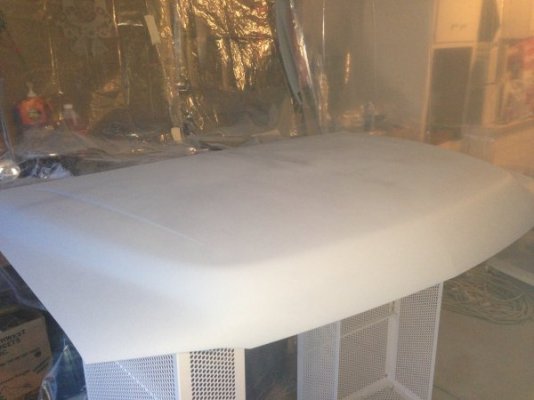

my vote would be HD

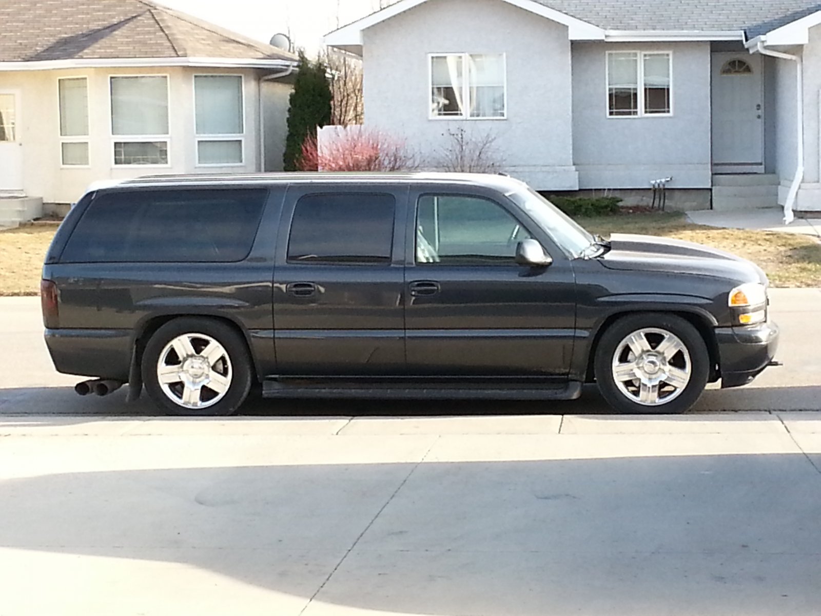

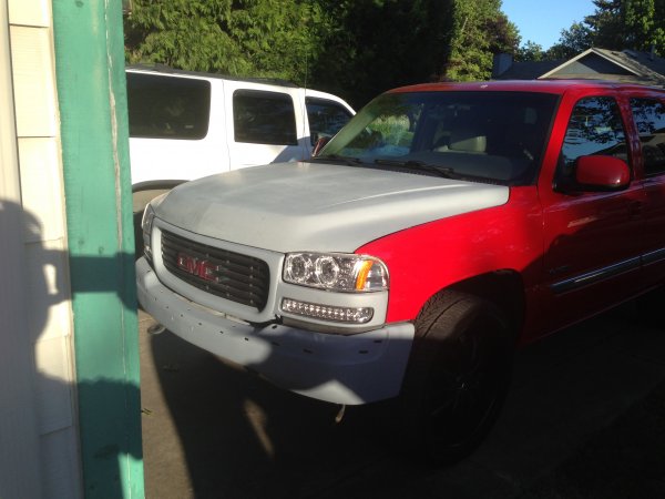

Failed searches for white Yukons with H/D hoods. Any pics out there?
32,215
48,685
Kind of.
