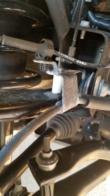

Dearmosd
Nov 10, 2018
226
44
Something to consider. I found it very obvious in the ride quality for the front suspension. A lot more bounce and doesn't feel as stiff when you hit bumps and pot holes. Just used a M6-50mm bolt and 1" nylon spacer.
