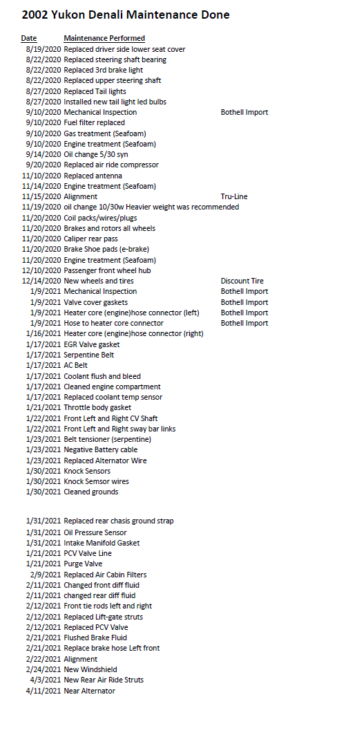

Hey guys,
I have done a lot of work on my truck and will try and post a spreadsheet of items, but again I am faced with a struggling start especially when cold. I thought I had this solved when I replaced the intake manifold and other parts on the manifold, but apparently not, it is back. I have also noticed a little build-up of carbon on exhaust tips, and the car seems to have a not as healthy sound to it, kind of described as a sputter when driving, a little loss of power if not mistaken as well. Any help is always greatly appreciated.

After the last seafoam treatment, I don't see an oil change. Also don't see any spark plug change after that. Wonder if they're gummed up? Did you change the camshaft position sensor while you were doing the knock sensors and/or oil pressure sensor? Maybe knocked the wire around? Check for codes? What brand of knock sensors? These rigs do not like anything but OEM.

AC Delco knock sensors. Didn’t know about cam shaft sensor :(, i feel like idid oil pressure sensor. I’ll check spark plugs. I do oil changes regularly, should be on there. Thanks for reply!
