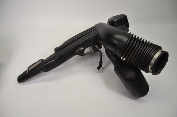

I've read a few things about the cold air intake tube, how do you check it for leaks?
This is just a picture from google, but if it has an open seam it could probably wreak havoc with drivability. seems like a real stupid design :confused::2cents:
The best way would be to find a brick wall and throw that thing at it as hard as you can. Now your KNOW it leaks, and you can get yourself a decent MIT.
