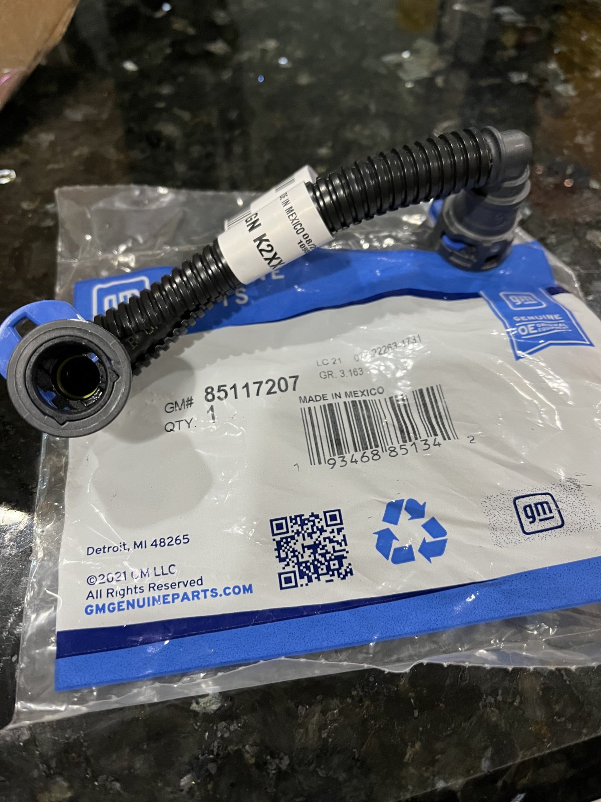

Braided fuel hose was delivered a couple days ago and the OE hose, after being passed around the local USPS hub for two days, was delivered today:
It has a 4.5" offset for anyone taking notes.
I kinda mocked up the braided hose last night to try to get an idea. Basically, it's gonna come down to squeezing the sensor under the engine cover or mounting it out to the side. I wanna do what the factory would've done, so I didn't go any further until I had the short OE fuel hose in hand.

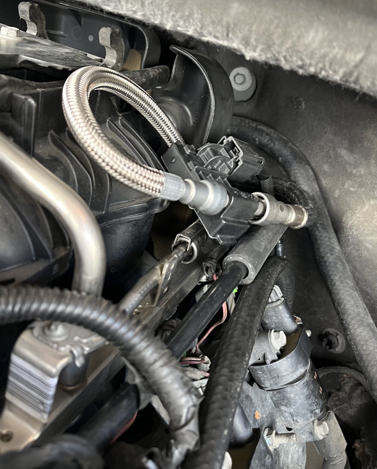

Went to mock up the sensor and decide on which hose I wanted to use. I tried to use the OE K2XX one, but coudn't come up with a clean-looking location for the sensor. Even at 4.5", the offset was still too far and the sensor would interfere with the engine cover. I could probably slice the hose to remove one of the fittings, trim the hose much shorter and press the fitting in to make it about a 2" offset. But then the factory flex line that comes up above the bell housing would be kinda pressed against the firewall. A solution for this might be as simple as tweaking the hard line or the bracket on the top of the bell housing. I didn't make it any further.
I twisted the braided hose in a tight coil to get a feel for the flexibility. I would liked to have heated it a little, coiled it and let it cool to form it. But, once I clipped it on the sensor, I wasn't gonna be able to get it off with the style of disconnect tool I have:
So, long hose it is. I found that by keeping that one loop in it, the factory flex hose clipped on and it sat naturally, as-is, with no stress on anything. The sensor weighs almost nothing and is just kinda floating there, supported by the stiffness of the hoses. The 90° end of the braided hose is on the fuel rail and its arch is lightly resting on that rib on the manifold. The factory flex hose fitting was lightly resting on the EVAP purge line, which I cushioned with a piece of 1/2" heater hose. The harness adapter I made to plug to the VLOM plug isn't contacting anything, either. I pressurized the system and moved everything around and saw no indication of leaking:

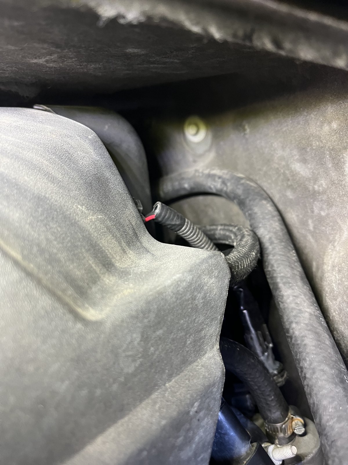

With the cover on, the harness comes out of the upper opening at the back. The factory hose clears the lower step of the opening:

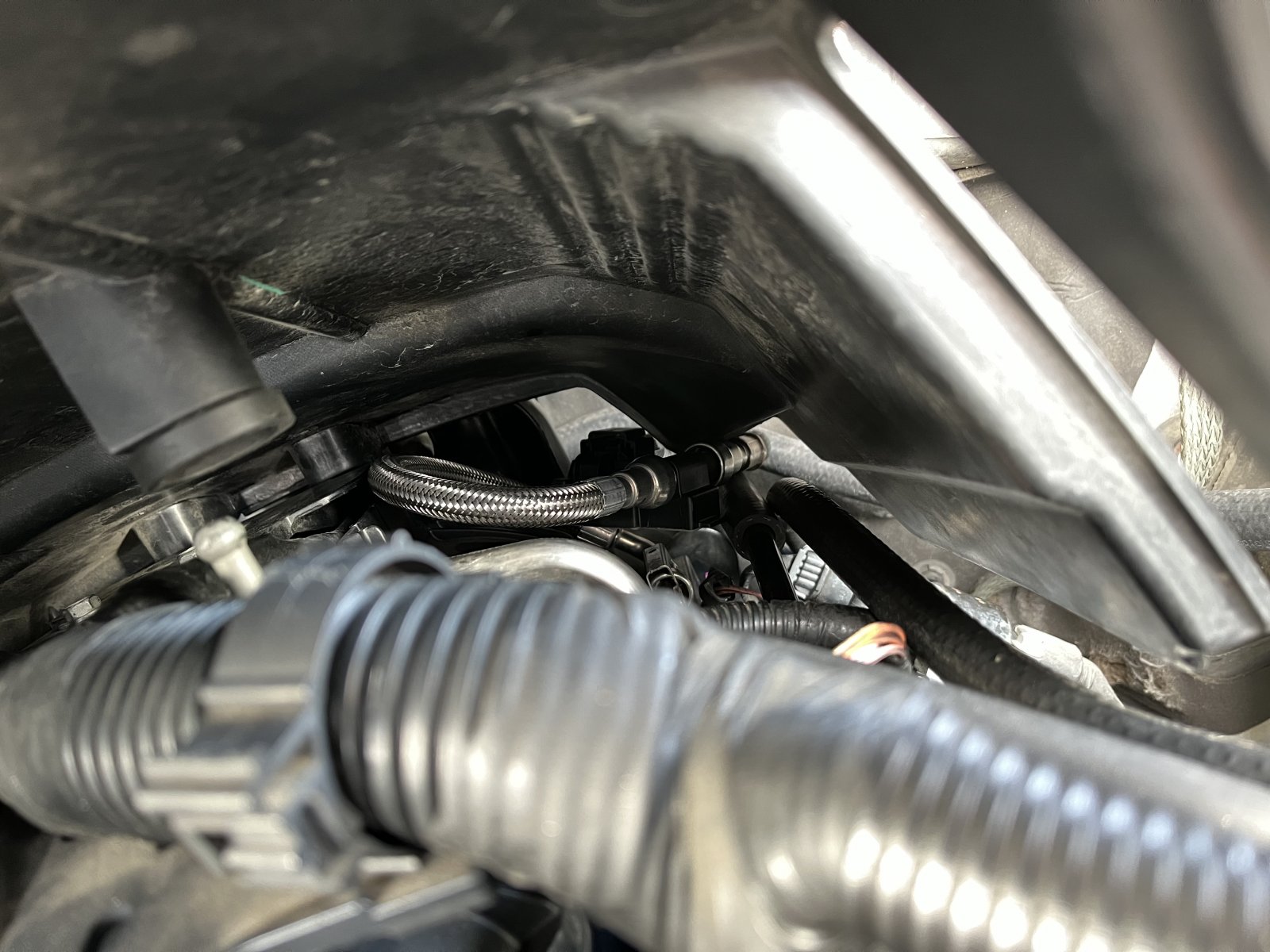

Looking under the cover with it raised a little off the supports, but rear hooked into place, you can see the harness, sensor and braided hose all have plenty of clearance. That one bottom point is barely contacting the fitting on the factory hose. It might pivot off of it when the front is snapped down into place. Either way, it's not a problem. I'll probably trim it, anyway:
So, my little oversight in clipping the fuel lines on the sensor forced me to just roll with it and everything fell into place. It's not "factory", like I was aiming for, but it seems to be perfectly functional and safe.
I took my fuel sample and will be headed to get groceries soon. I'll monitor the calculated alcohol content for what I hope will be its last time doing so. I'll upload the updated tune when I get back home. I'm changing it to the physical sensor as well as a small tweak to the TCC settings.

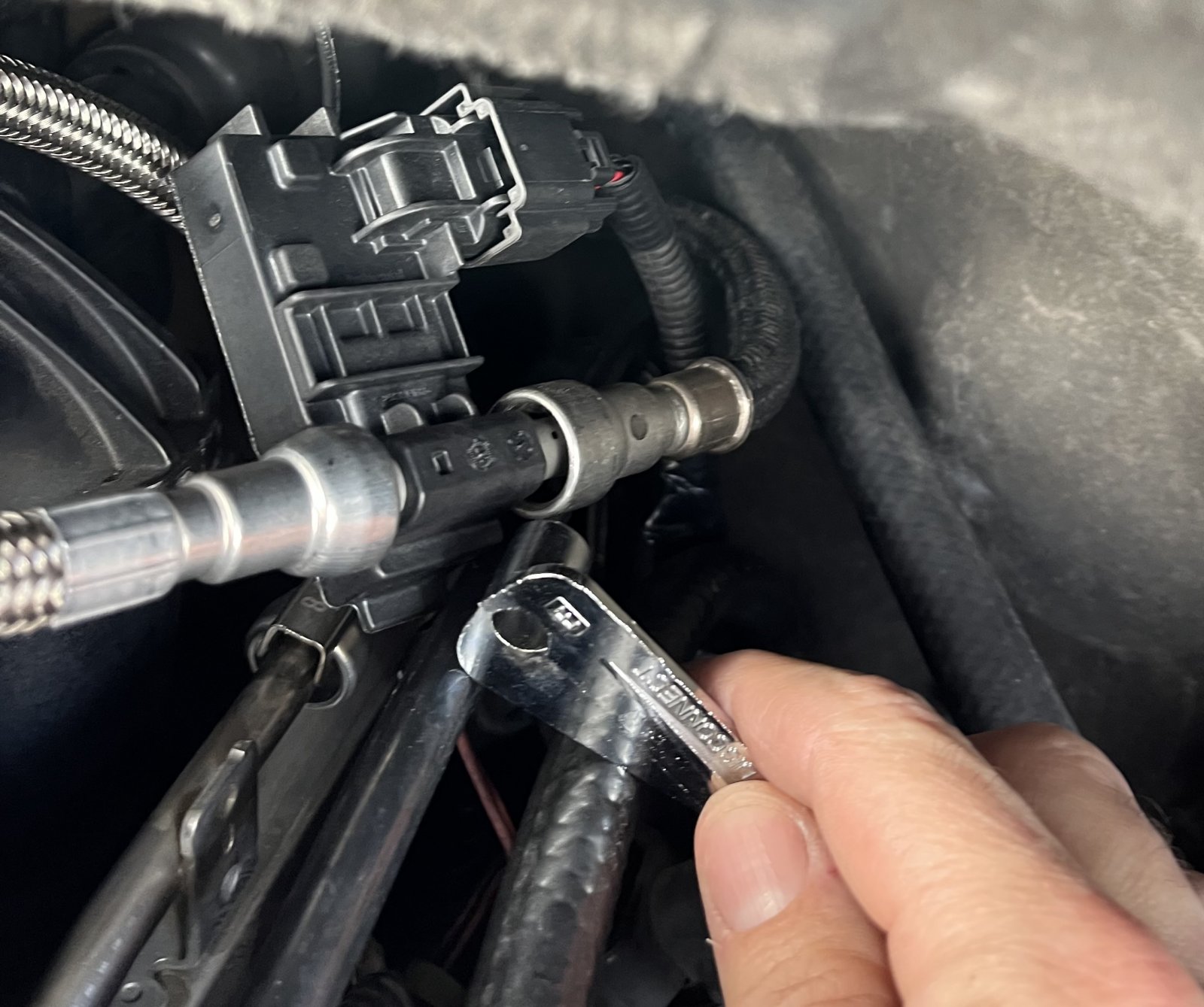

Hey yea, don't clip the oe quick connects to the sensor it's a mfer to get them back off

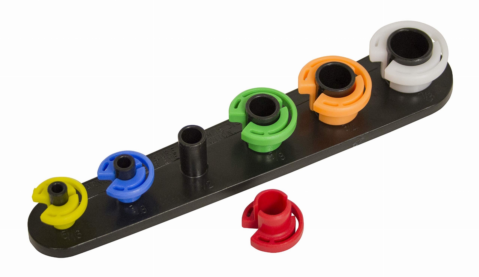

Thanks, brah. Lemme guess- I need this style, huh?
Haven't found one that works yet, I grabbed a split one from lisle still wasn't worth a shit
Or maybe it does..last time I had to pull the one on ctsv before I brought to dealerahip...I think I ordered that one and didn't come I time. Had to pick it off with a couple small screwdrivers

I have yet to find any disconnect tool worth a shit in my experience fwiw. I know I am just a shit bird in here but that’s my .02.

the problem with the FF sensor is that the ends are short, with the hose qdc on there there isnt any room to even get the tool in there to work as ****** as it is on an easily accessible fitting

Well, damn. That looks to be about as low-profile as you can get. If that one still fights it, then either there's probably some overpriced Kent-Moore tool that the factory uses or it's designed for a different type of retainer in the fittings, like the push-to-unlock style on the plastic fittings.

That metal scissor style has never given me any grief at all. Just put it around the hard line and push into the fitting and the fitting comes right off. Used it many times on my Jeep and countless LS engines. Never fought it once.

You can see what Randy is describing here. Note how close the two metal fittings are on the inlet and outlet of the sensor. Black braided is the incoming hose, stainless braided is the outgoing. The black plastic sensor body doesn't allow room for standard release tools which go down inside the fitting to spread the locking tangs apart:
Of course, this isn't really a thought until after you click it on there then wanna take it off. I think the idea is to use this style of fitting, which has an external, sideways-sliding lock:

Didn't like that back to back 90 for flow anyway, glad it didn't work lol
Do like that gto hose tho, I've seen it before and thought it worked good but forgot where it came from
