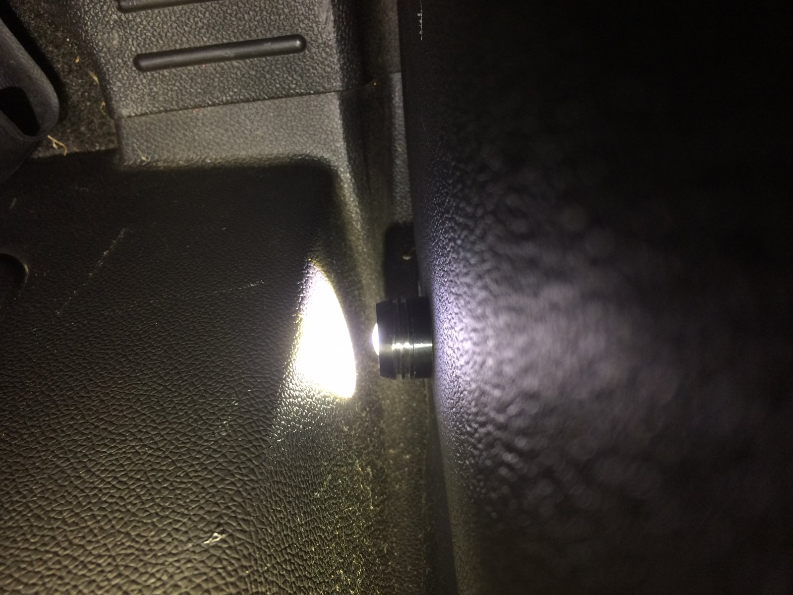

Did a little something today. A Jeep buddy sent me pics of some LEDs he bought to mount in the hatch of his wife's XJ. This reminded me of some similar projector LED pods I had left over from a project years ago. I figured I could put 'em to use as some downlights for the cargo hatch on the Tahoe.
I don't know the wattage, but I tested them prior and decided they'd be plenty bright enough for the purpose:

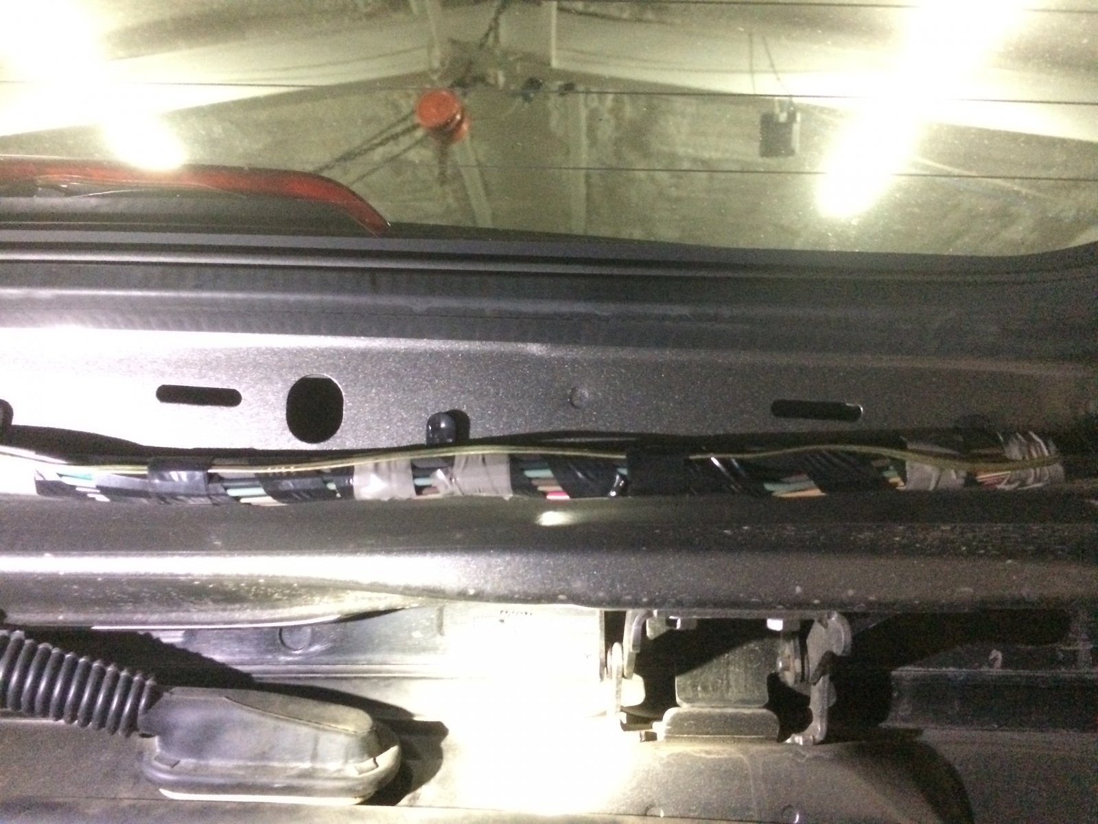

I mounted the lights and ran the wiring along the factory harness, taping it with 3M Super33+ every 6" or less:
I tucked about 12" of slack under the jute padding near each light so I'd have slack should I ever need to replace a light:

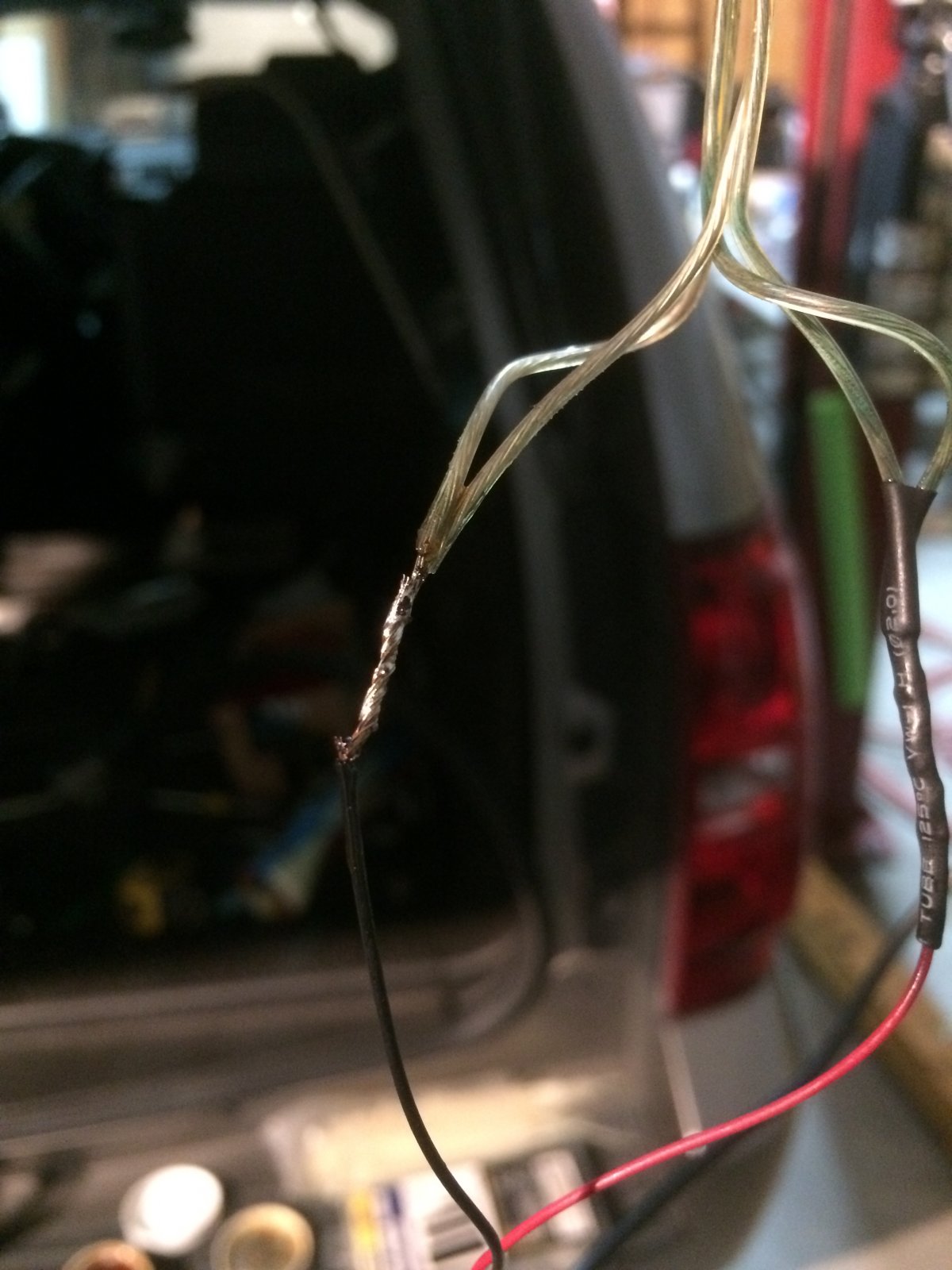

Soldered and heat-shrinked all connections:

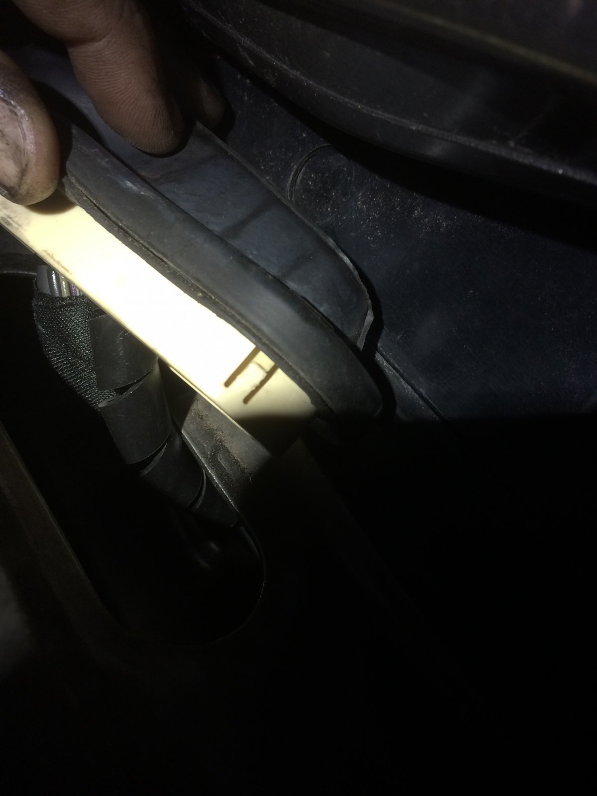

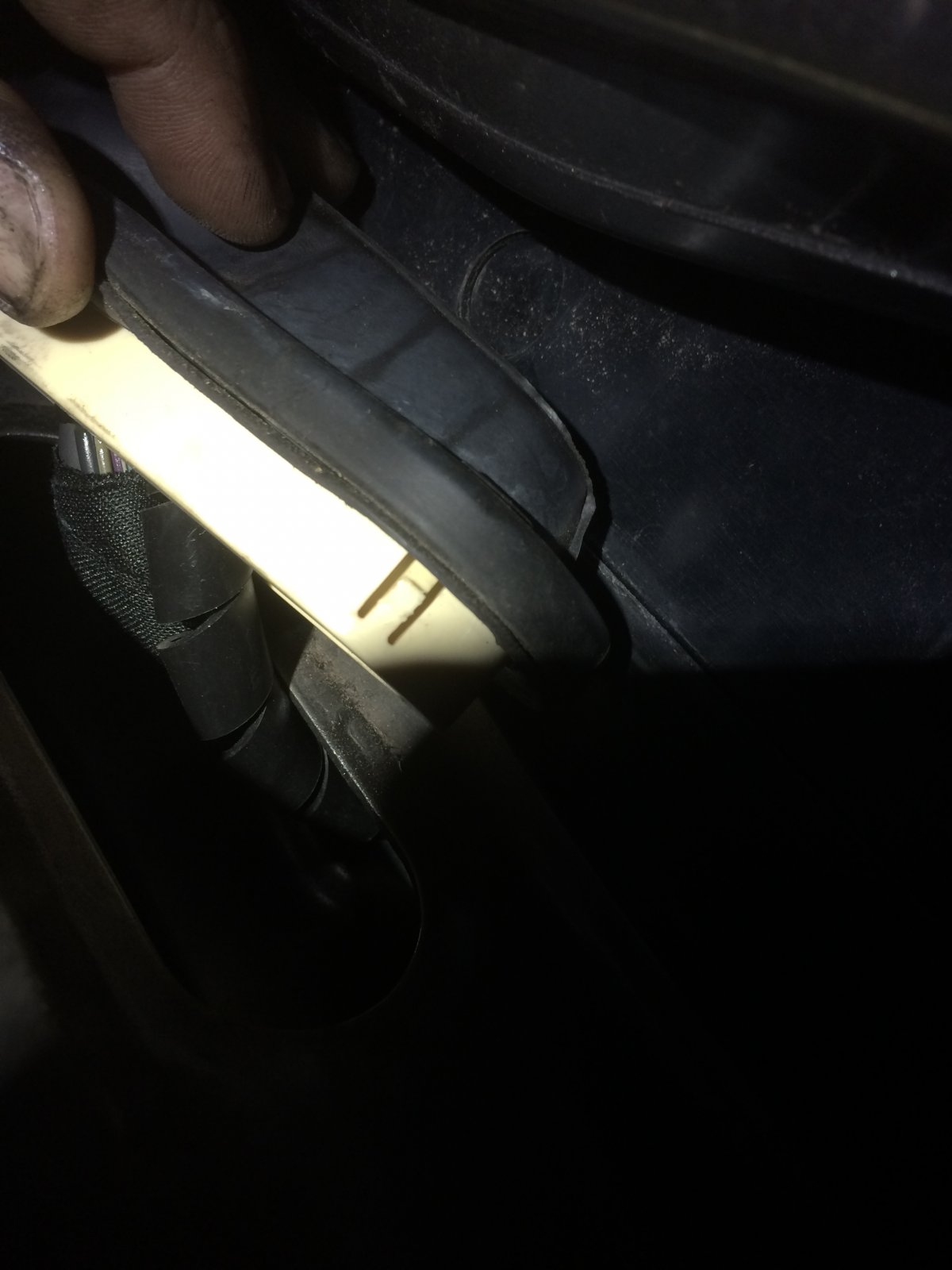

I ran the wire through the factory jamb boot and added a piece of spiral conduit as extra insurance where it passed through the metal body on it's way to tap into the cargo light about 2' inboard:
I located the lights so that they'd be in the gap between the hatch panel and side panel. This would shield them from firing forward when the hatch was closed and a door was opened as well as protect the light from getting sheared off should luggage or cargo slide along the back panel:

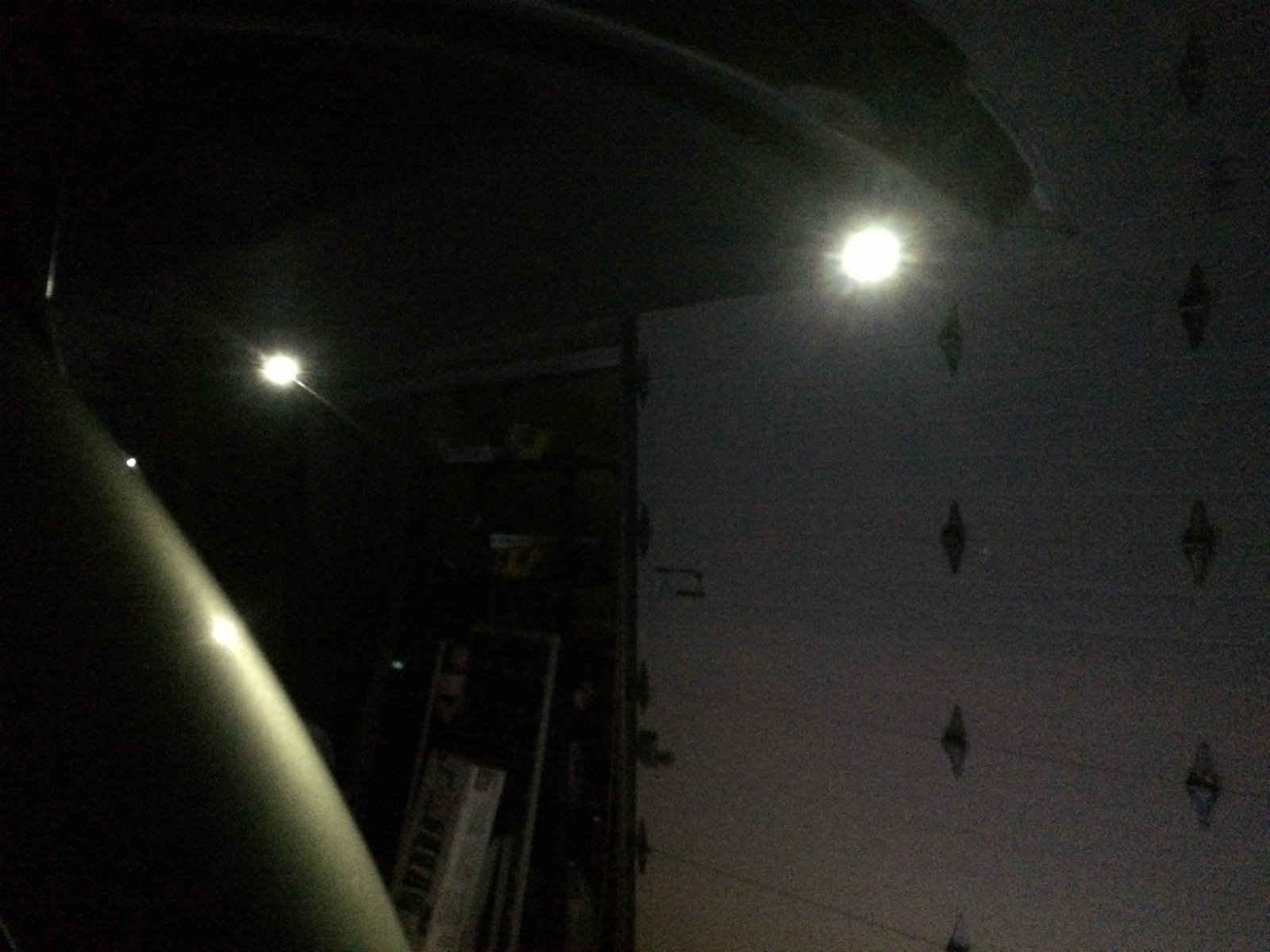

The light is focused downward so they're not overly bright as to blind you from overhead:

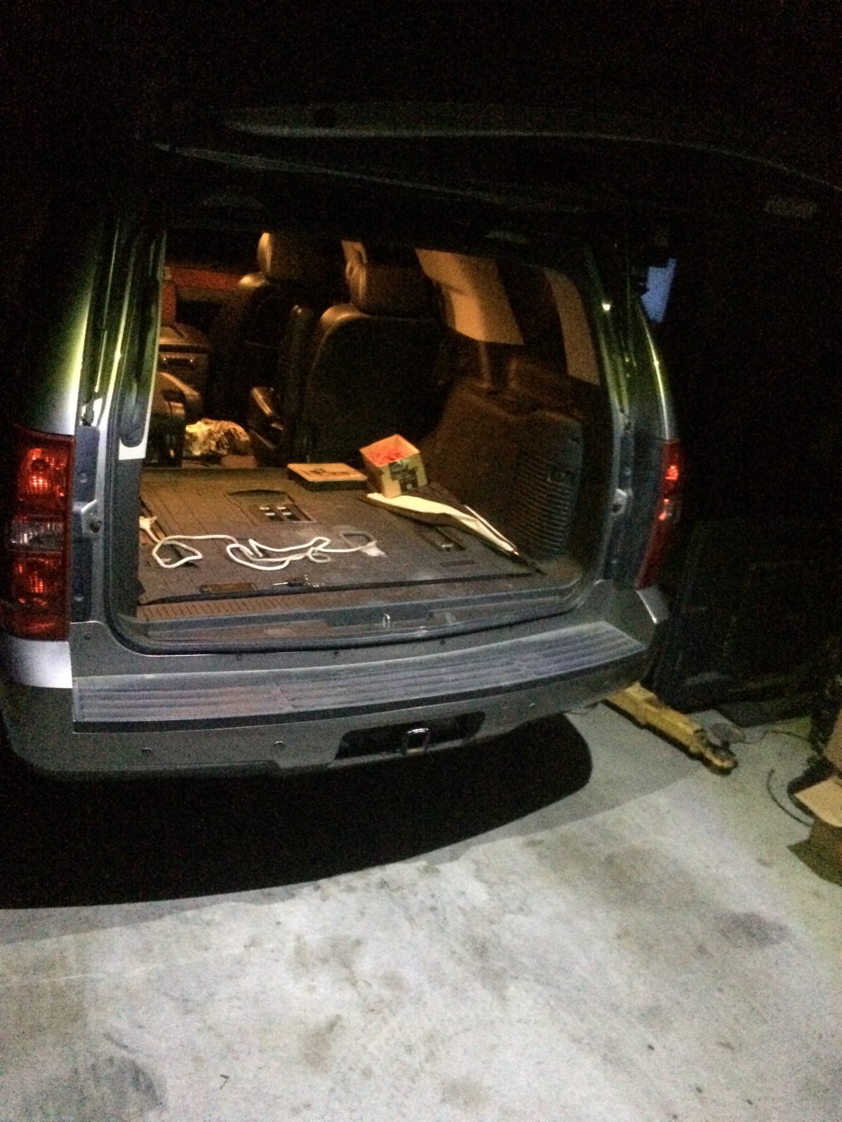

...But they put out plenty of flooded light to be a great help when in the cargo area or hitching/unhitching a trailer at night:
Now I'm wanting to replace my dome lights to match.
