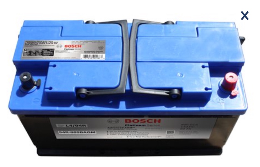

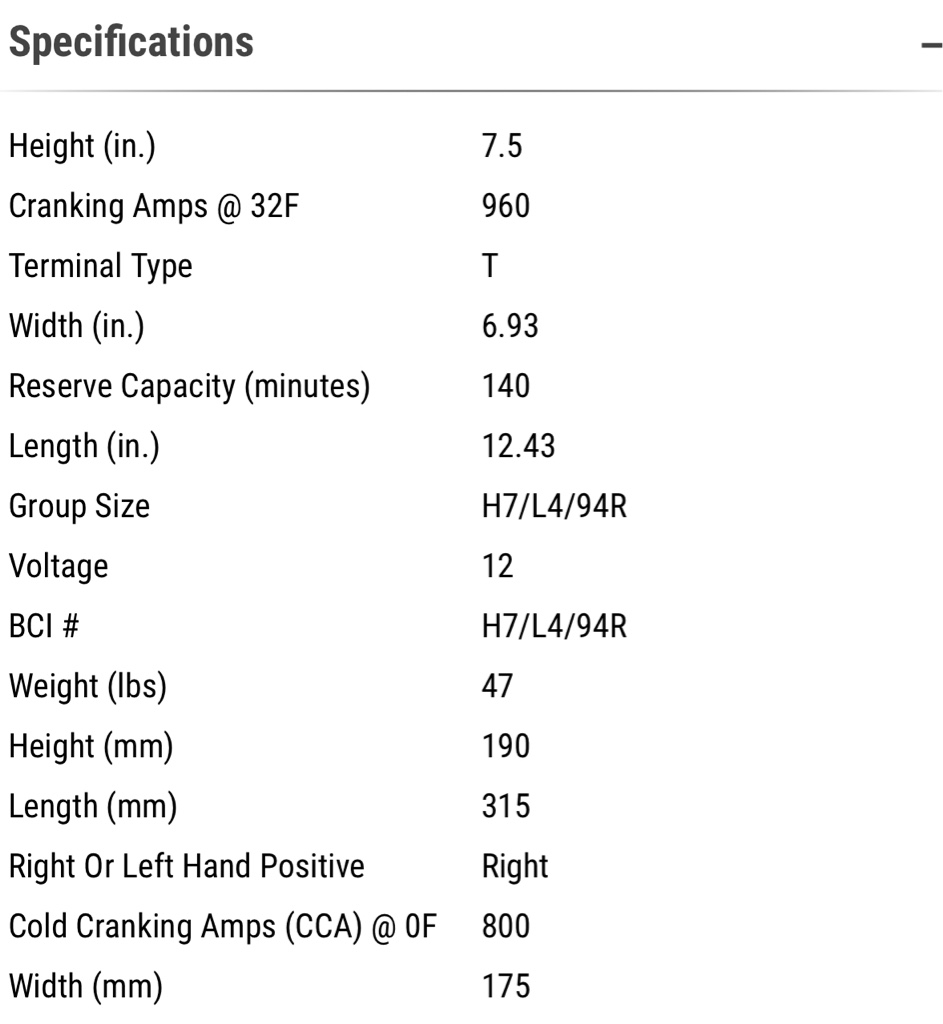

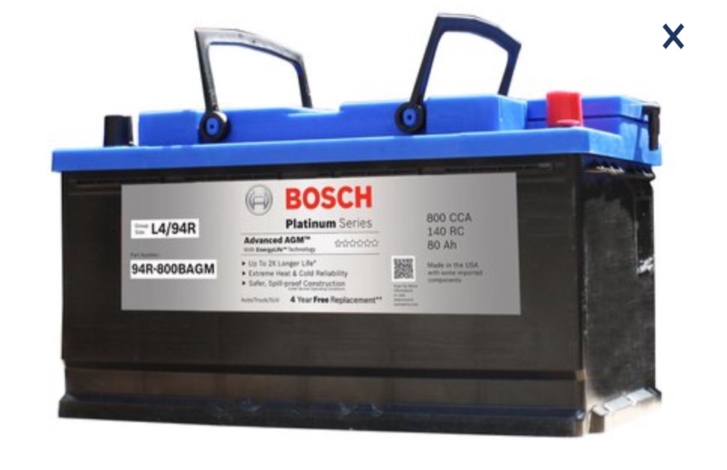

Bosch Platinum Series AGM Battery Group, Size H7/L4/94R Typically $145 when on sale 25% off. Won’t crap out due to extreme hot/cold. Made by Varta in USA. Use them in all our cars now. Optima’s quality went down the toilet since Johnson Control purchased them and moved factory to Mexico.
The Bosch kisses the coolant overflow tank but fits like a glove for 800 CCA and 4 yr nationwide over the counter, no questions asked replacement. Doesn’t leak if your alternator fails and overcharges it.

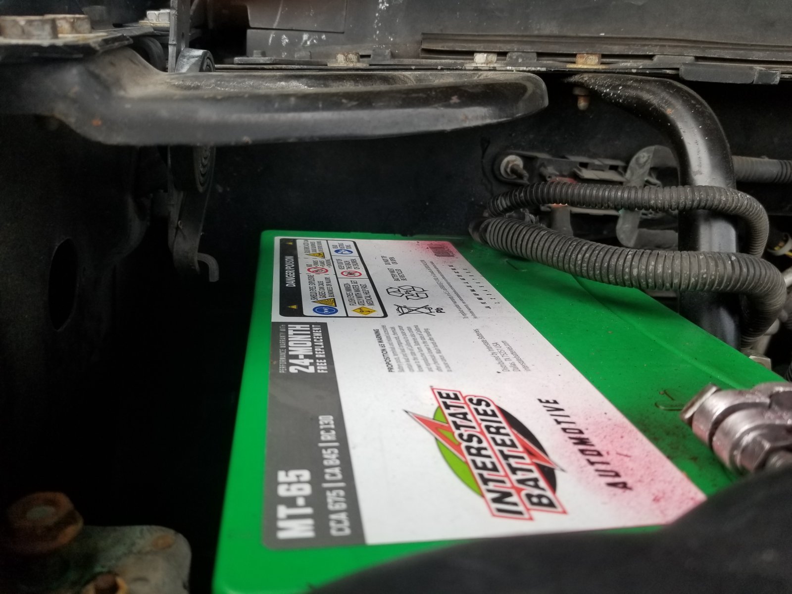

Well I got (2) like new batteries for a total investment of 110. One is a duralast gold 880CCA, and the other is interstate 675CCA. Both have date codes within the past 2 or 3 months and tested good at the local oreilllys. I'm going to do the dual batteries...because why not. The specs are 1/2 wider, I'm sure I can make something work.

Just an update on this, I wanted to reply to my original thread but search wasn't working. Google got me here thankfully.
The verdict is in.
The 65 battery fits and works fine in the main battery box. I did have to take a few swipes of the file on the fitting block but it works fine.
Will report back on the secondary battery tray soon.

I have a cheese *** undersized battery in our 09 Esky that’s throwing codes if left in accessory mode for more than a few minutes. Time to get another Bosch H7/L4/94R AGM like the Denali is fitted with.

Bosch Platinum Series AGM Battery Group, Size H7/L4/94R Typically $145 when on sale 25% off. Won’t crap out due to extreme hot/cold. Made by Exide in USA. Use them in all our cars now. Optima’s quality went down the toilet since Johnson Control purchased them and moved factory to Mexico.
https://www.pepboys.com/bosch-platinum-series-agm-battery-group-size-h7-l4-94r/product/838845
Exide is no longer making Bosch AGM batteries or any that I can see. Pep Boys now sells Champion branded AGM made by Exide which now shows owned by .... wait for it .... Johnson Controls. They also sell a clone battery wrapped in AC Delco packaging with a smaller 3 year warranty and for $100 more. The Champion battery is still at a 4 year warranty exactly like the Bosch units.
