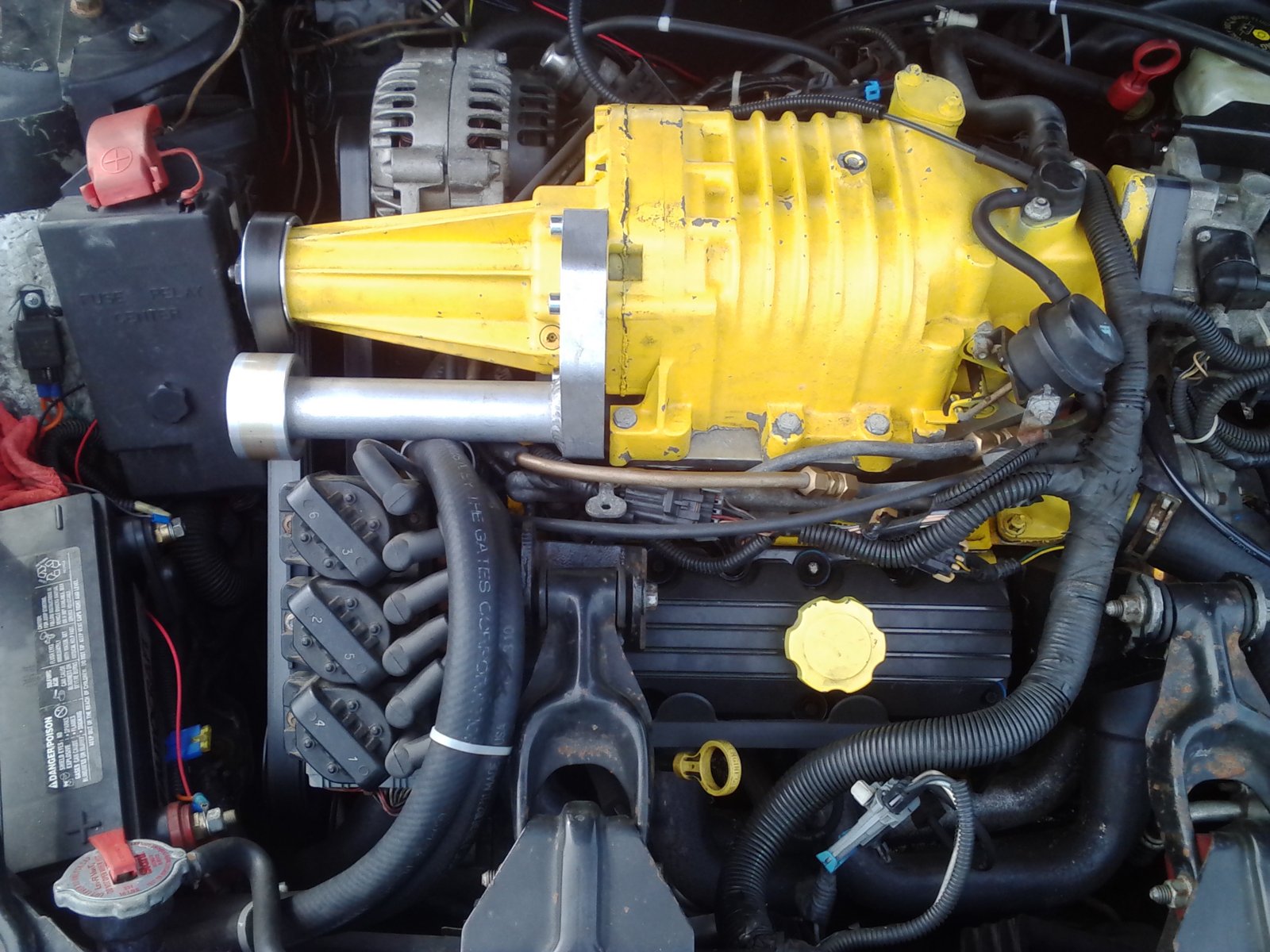

ive got studded terminal bolts, meaning i can bolt on a eyelet for power or ground. they are sold at most parts stores.
best ground you'll ever have. all my gauges are grounded there as well as a ic pump relay power lead and ground.
