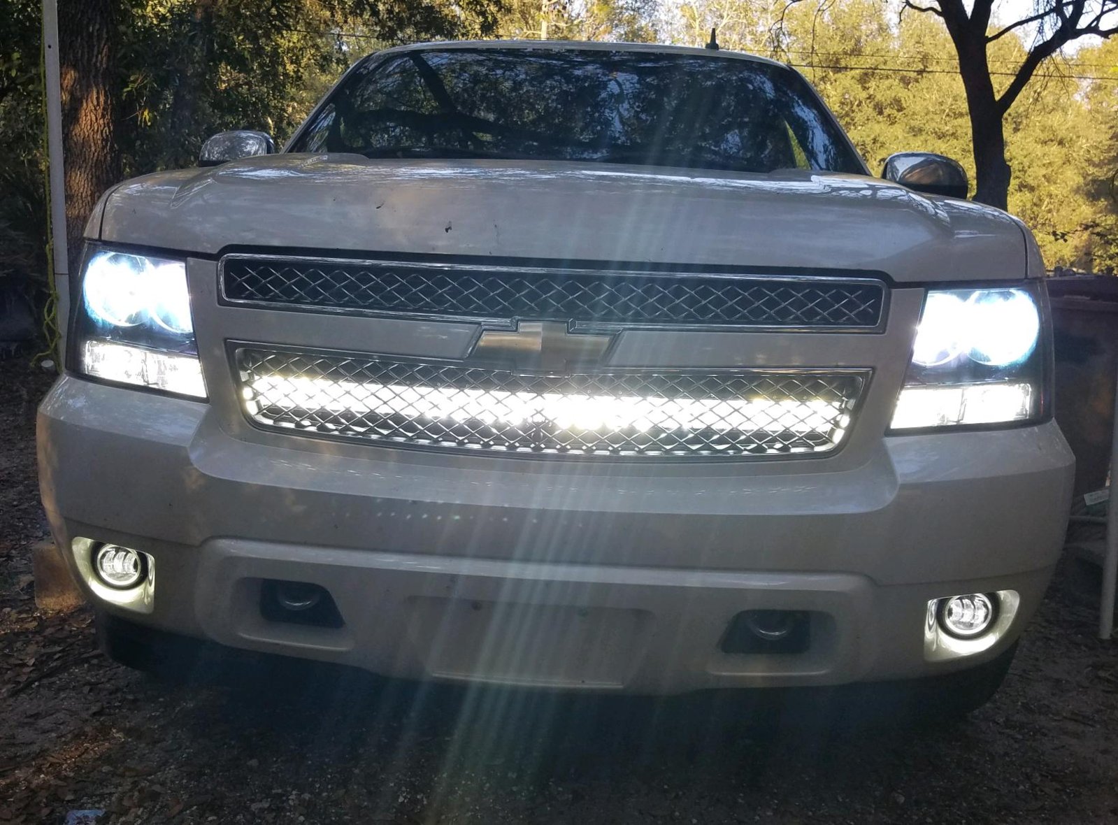

Beat me to it haha, a 42" straight will also fit as well regardless of straight or curved I can tell you it's a tight fit but it looks much better than just having a light that doesn't go all the way across.

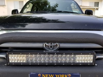

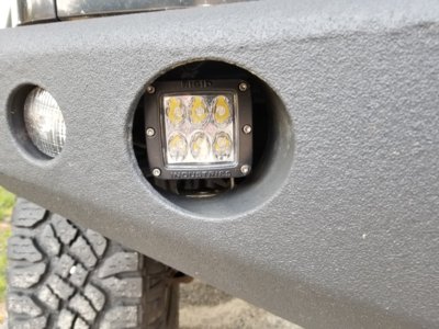

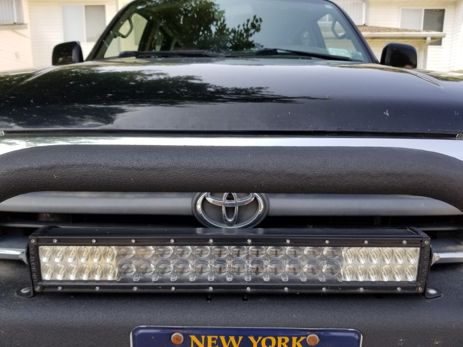

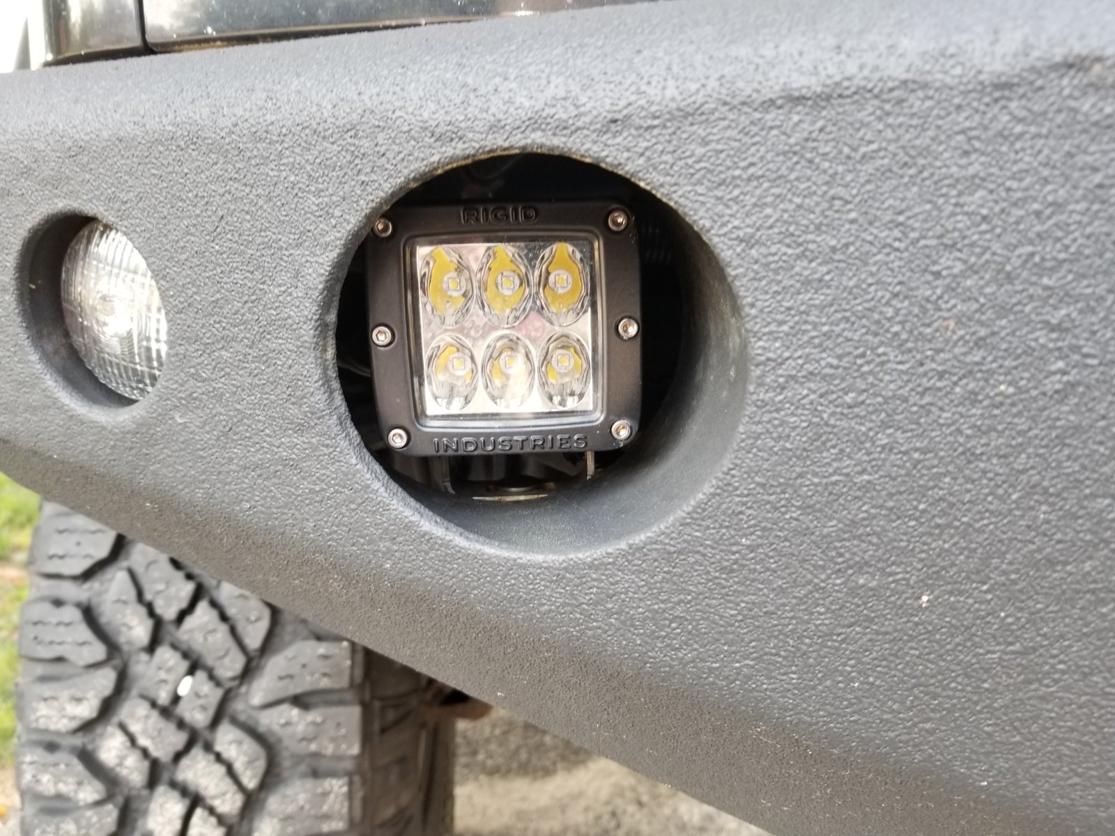

Ridgid's are expensive... but worth every penny... I have em in on my 97 4 runner... on the bumper and in the corners.. when i become a Tahoe owner... you bet ur A$$ it's coming with me.. but i'd like to mount it In the grill not behind it. I think there might be an kit or bumper that i might be able to find that will allow me to accomplish this.I'm sure it ain't cheap either. My Bar isn't anywhere as big as yours is..... some folks wont install a bar when they know that it might get stolen. I took as many precautions as i could.... but if someone wants it... they'll get it.

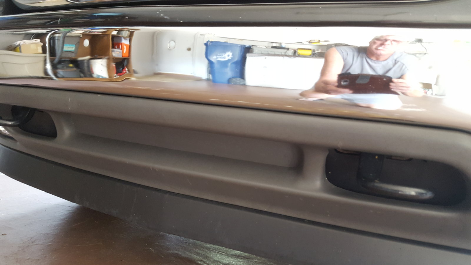

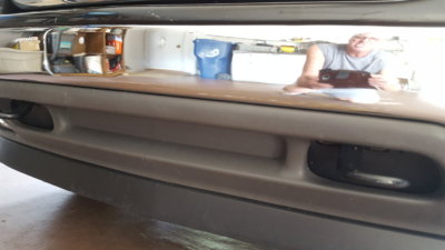

I had a similar idea, but using that empty space between tow hooks. Even though the plastic is a little "wiggly" . The space is about 20" x 2".
I figured you could secure it better from behind.
..... That is,..... if you have the same style air dam.

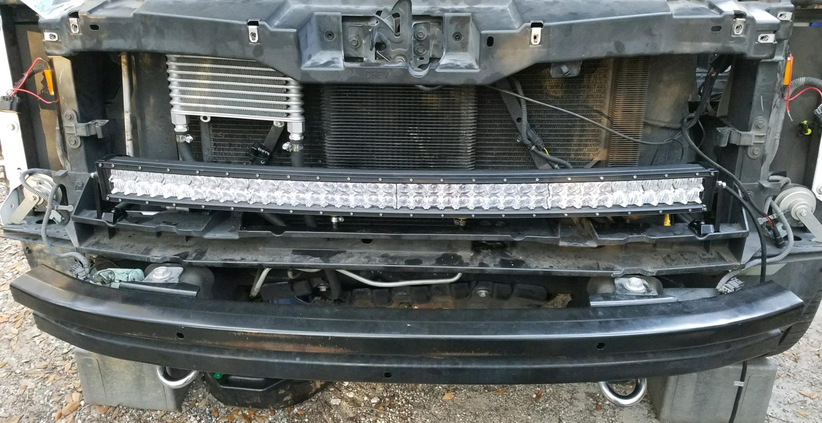

1st attempt - aborted
I have a 2011 Z71, and the 42" (Nilight 42" 240W curved)
curved I purchased didn't fit. I was able to squeeze it in place but when you try and make space for the side mounts you run out of space. Perhaps if you remove the bumper and grill, you could make room, but that was more than I wanted to get into on a rainy Saturday afternoon. Will look for a slightly shorter, or bottom mount bar.
Also, on the 2011 Z71, there is an trans cooler mounted in front of the radiator. It looks like a 42" curved will barely fit, assuming you can mount it, but I don't think a 42" straight would. Will take some pics on my next attempt.
