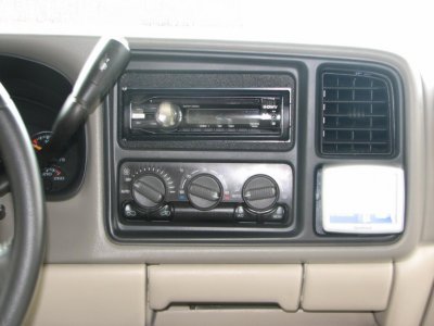

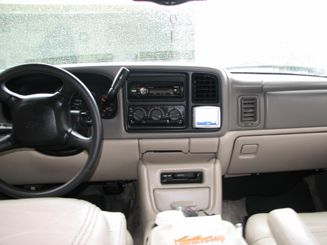

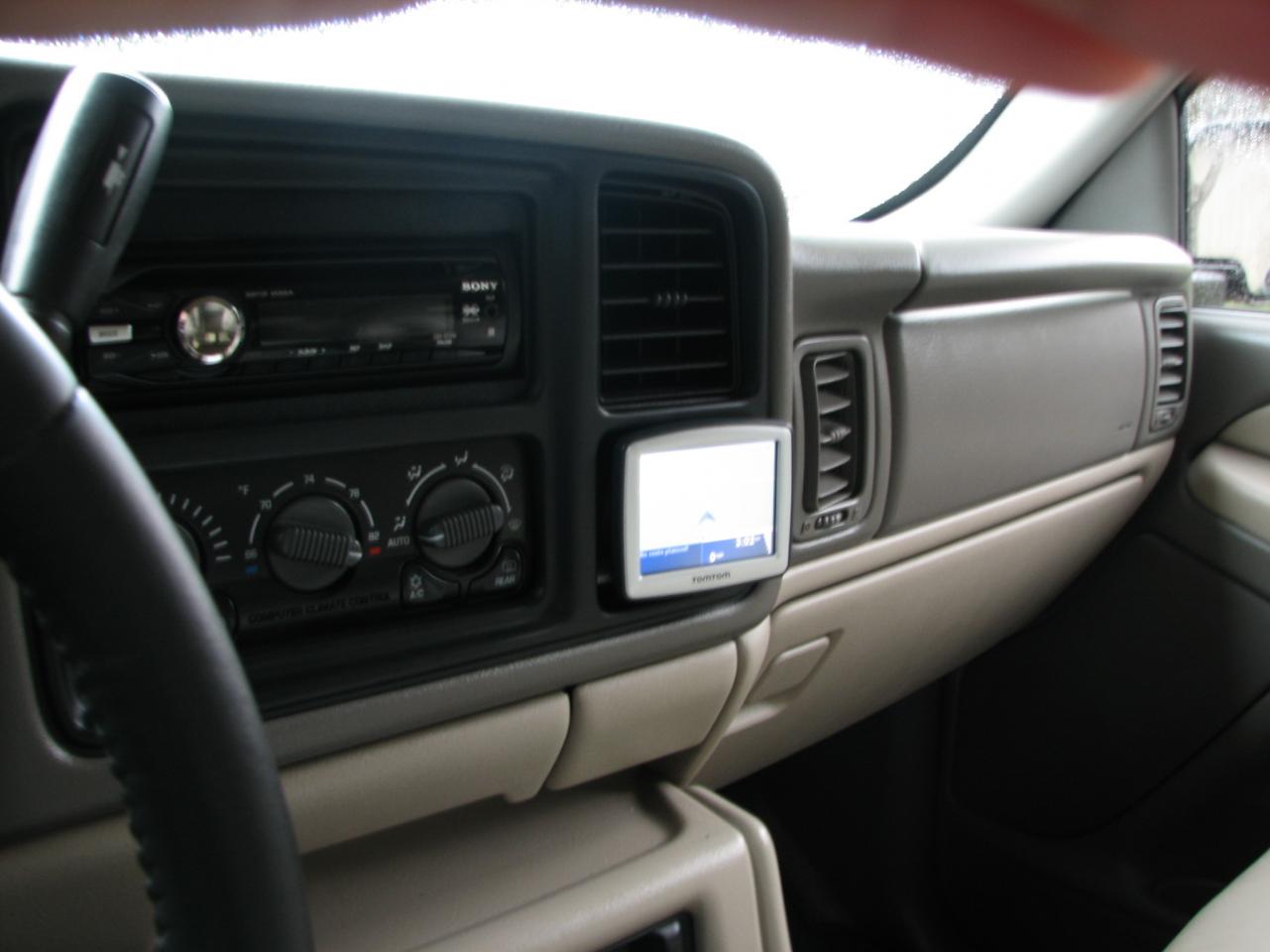

Alright here are the pictures of my GPS all installed finally..
I hardwired the gps with a female cig connector to the fuse box so it charges the gps while the ignition/car is on. I had to make a plexiglass cutout to fit inside the old Onstar pocket so that the gps suction cup had somethine to stick onto. I would've mounted it perfectly flush inside the dash however the TomTom power button is on top so instead it is mounted a 1/4" out but still looks really clean IMO. Let me know what you guys think!

Not bad lookin! how is it looking down at the screen? any trouble reading it?
rogue status hoho
rogue status hoho
Jun 28, 2009
172
No it actually works out perfect because I avoid all the glare from the light outside and it's slightly angled for the driver so it's easy to punch addresses in and look at.
