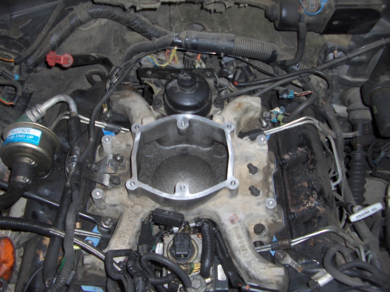

Here's the new intake installed; you can see how it's much more free-flowing:

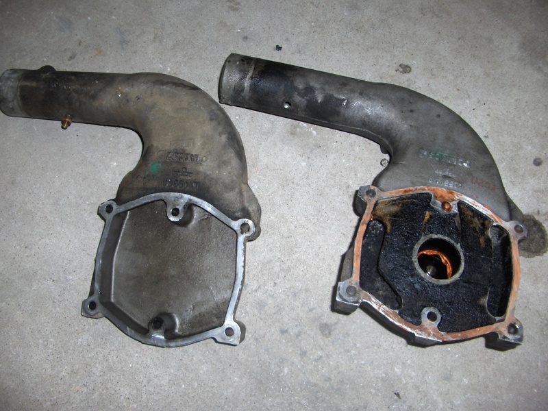

Here's the upper plenum that goes from the turbo to the intake manifold; non-EGR on the left, EGR style on the right:
