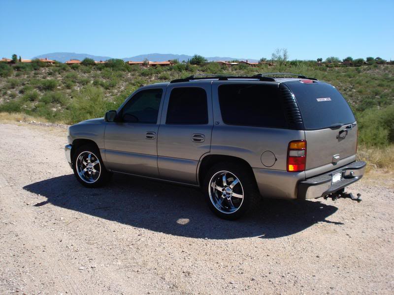

Here are the pics. They're a little old, from 2007, right after I did most of the work. The only difference now is no front window tint and I took out the hitch ball.
