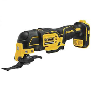

Here's the door -
...and two piece cabin filter. A one piece filter will fit but you'll mangle it getting it in and out.
I used a multi-tool with the blade set at 45º to make the cuts. Worked like a charm. Use the foam on the door as a guide for the length and width of the opening.
