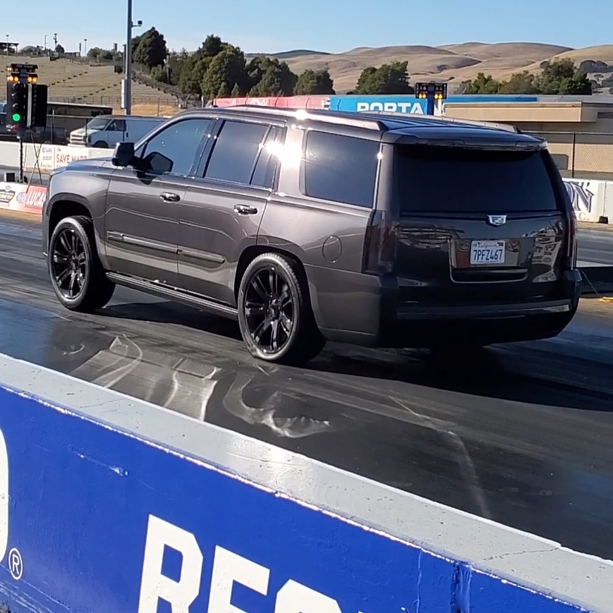

Goal. 10.9 1/4 2wd Escalade on 26s
NORCAL SS
SUV SUSPENSION GURU
Jun 9, 2009
8,744
610
Sold my Escalade but new owner will start off where I left off...10s on 26s and 22s and 2wd.
norcal_ss instagram for complete build.
Stage 2 combo will start soon and the goal/record will be 10.999 with cam/more boost/fuel mods/stock trans/stock converter/stock 3.23 gears on a street tire.
No drag radials or slicks. That's right we will be using 22 inch all season tires with 285 45 22 Michelins and then doing it on a 305 30 26 Lexani if that's not hard enough this Escalade is 2wd. I will be working on suspension side and so far im happy with results i'm seeing from testing.

Ok here we go
Pump gas
Whipple 2.9
6 psi
Long tubes
3.5 cat back
12.2@114
On a 295 30 26
New owner took it out ran 12.8@100 on 285 45 22s letting off cause he's into bracket racing.
Next round mods
102mm tb
Custom 5 inch intake
Meth
Keep same boost
Run it
If runs 11.99 we are happy on 22s
After that will up boost to 12 psi where the 2.9 shines and run it again.
Then comes 416 lmr
New owner drives daily and just having fun.
