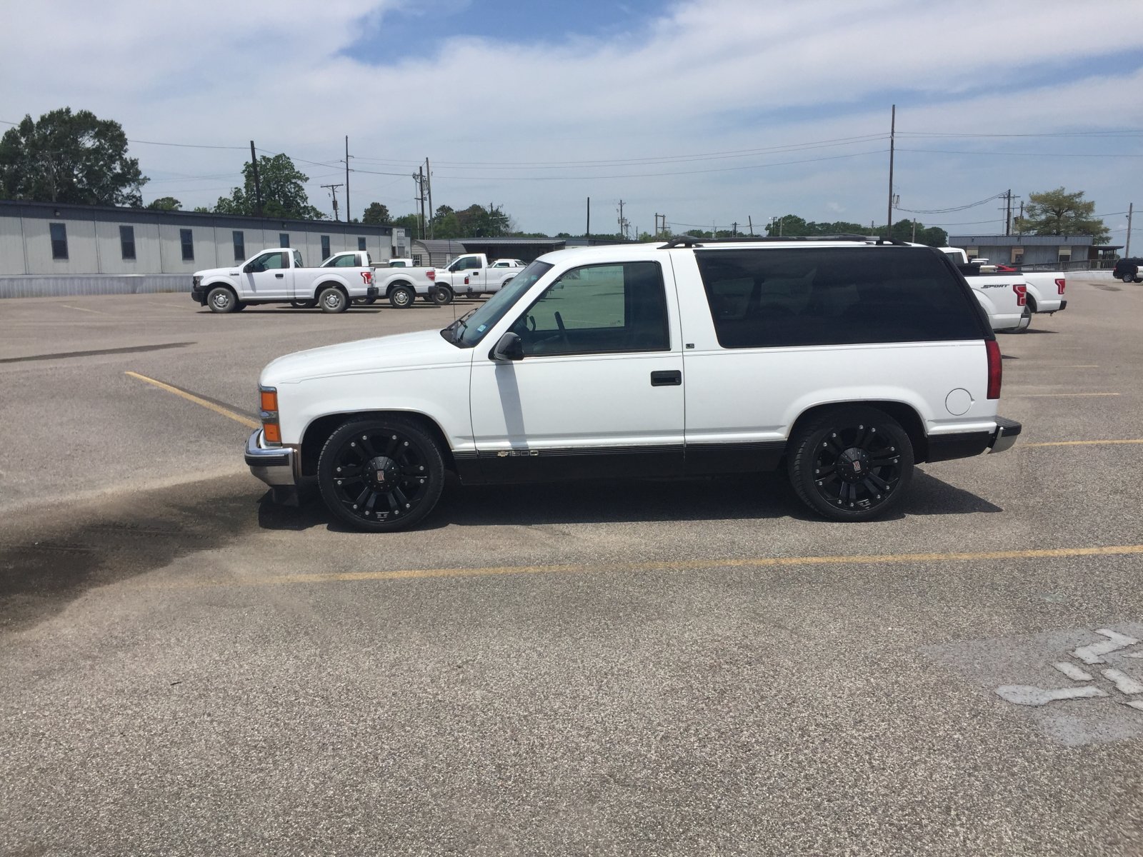

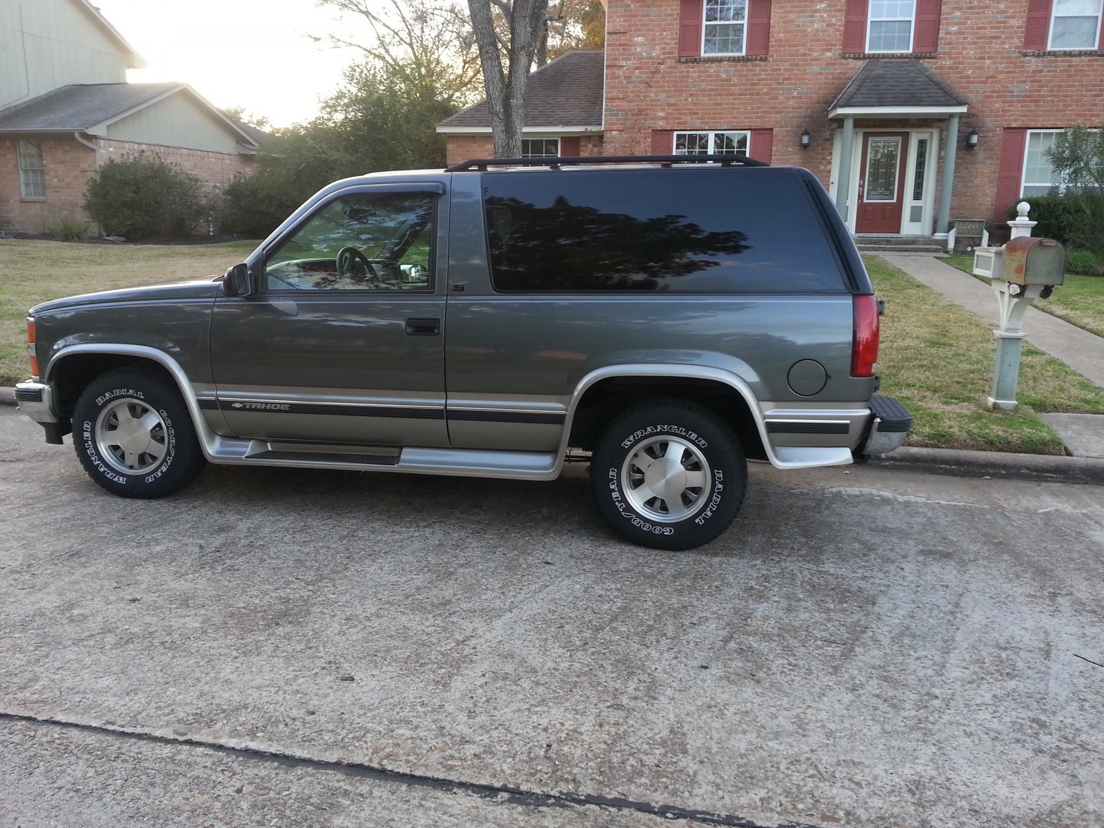

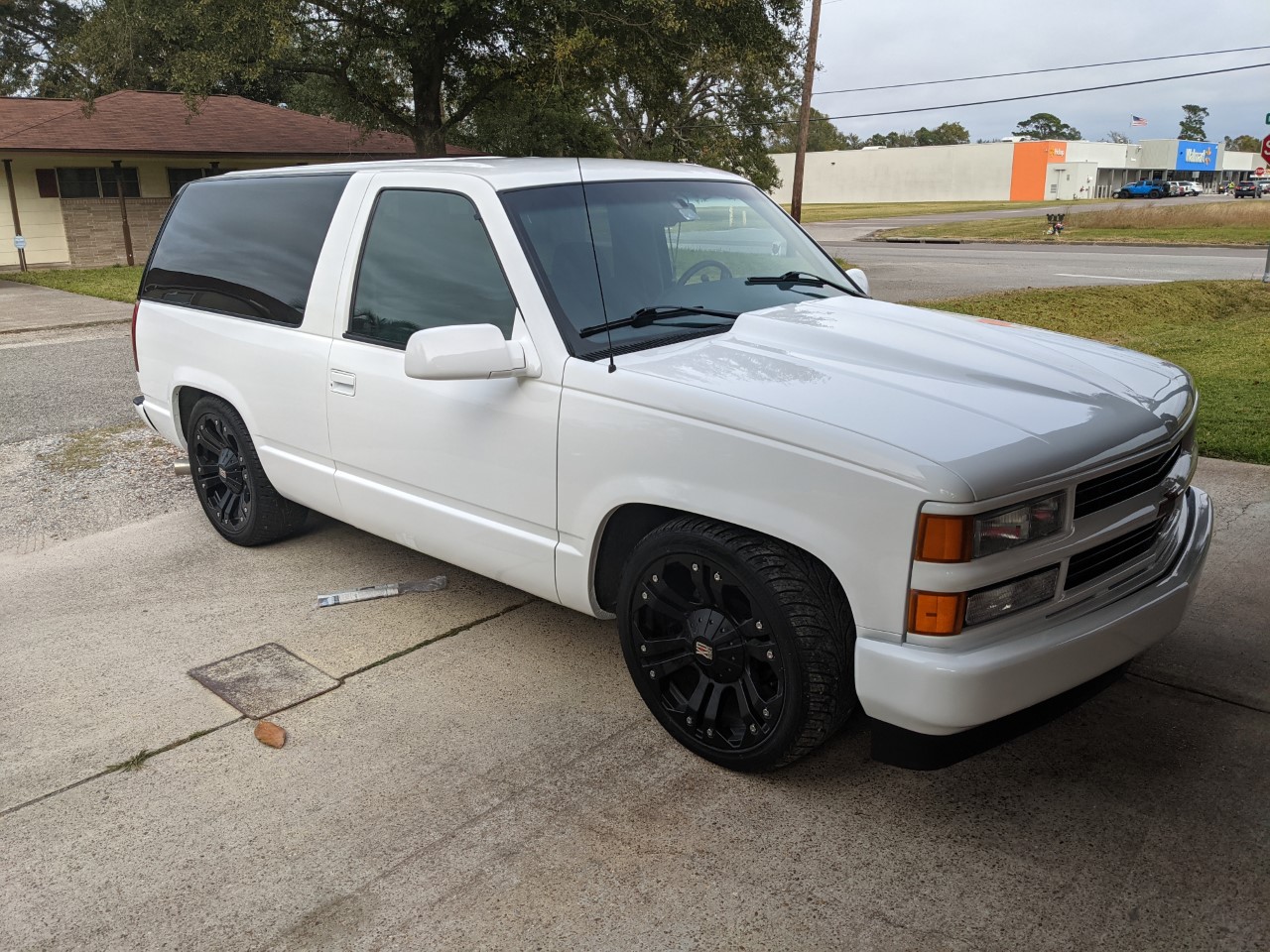

Here are a couple I found

Like I said - it's in the paint shop now. I'm having the roof rack removed, all emblems and trim removed, bumpers painted white, new grill painted white. Basically everything is going to be white. It will be painted Pure White. Also installed a cowl hood.

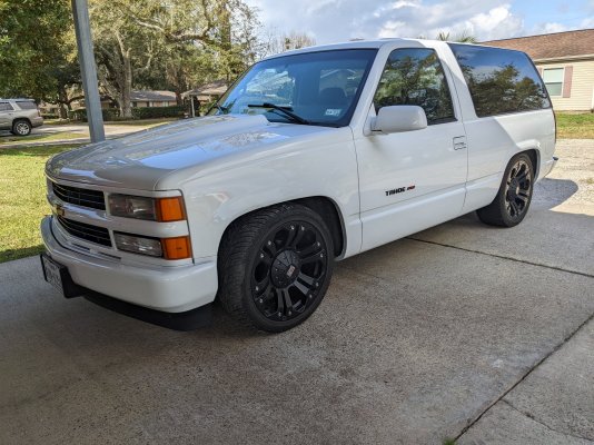

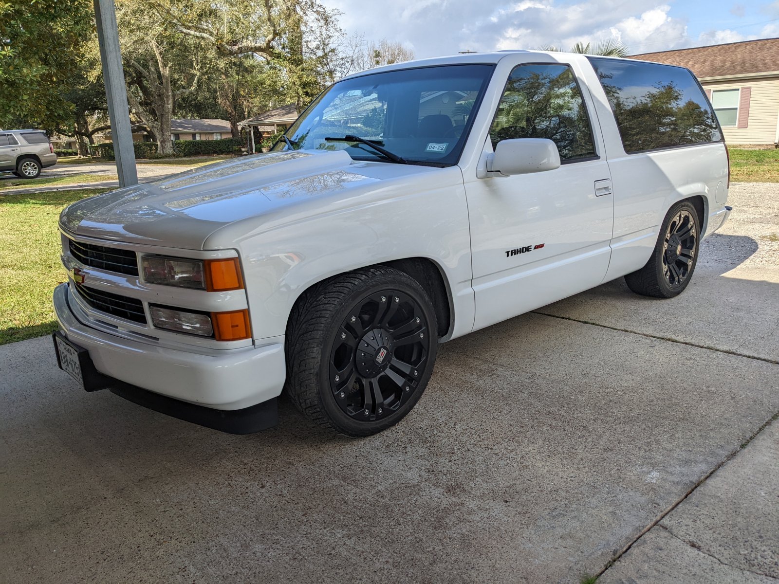

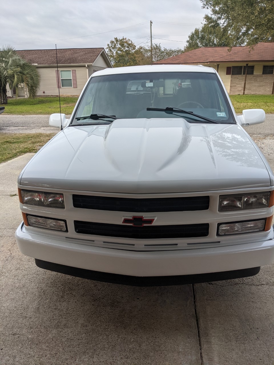

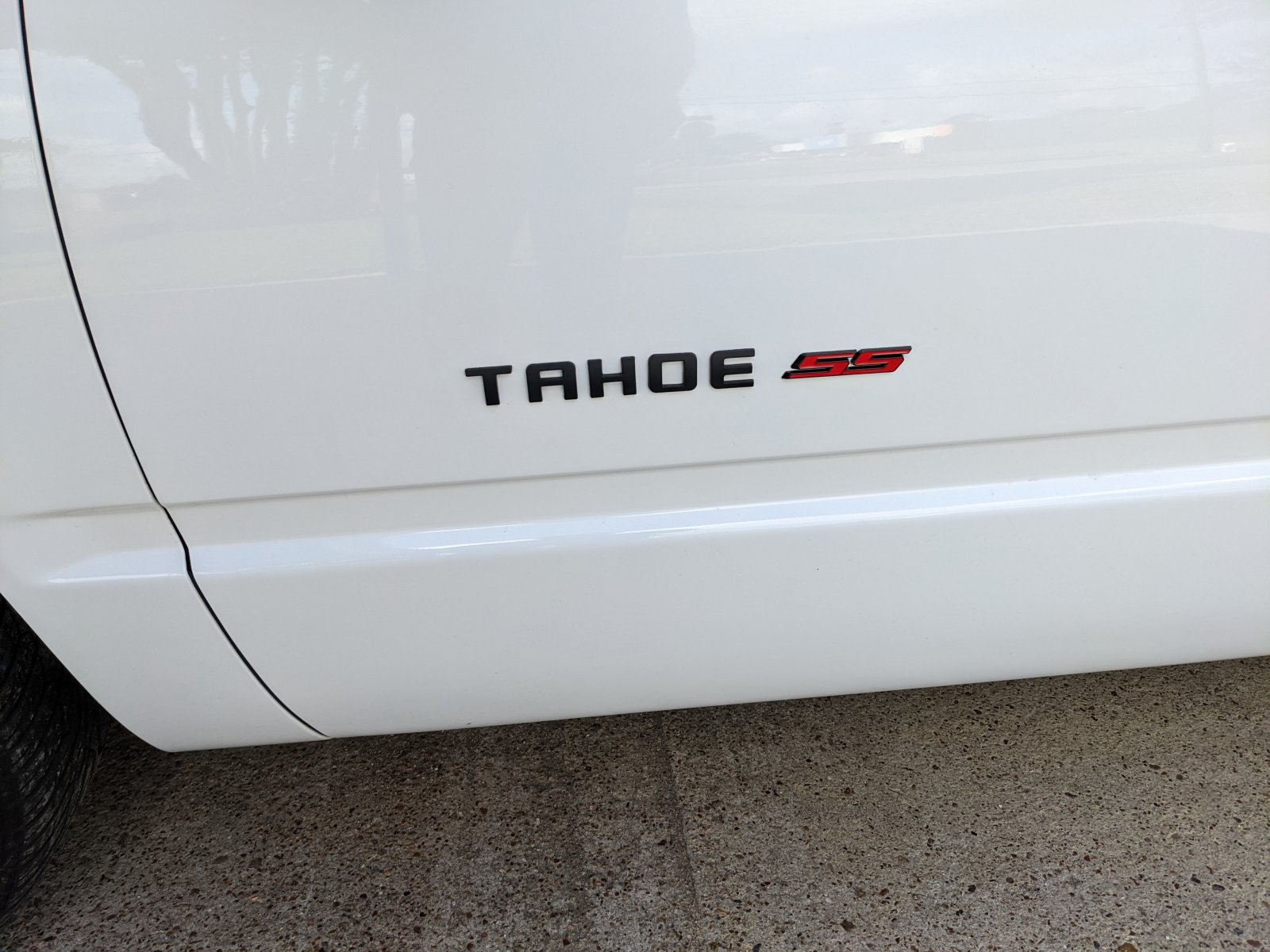

Here are some pictures after it has been painted.
