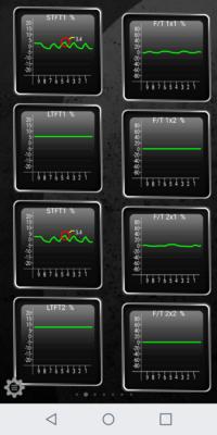

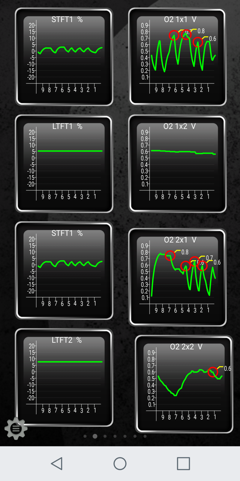

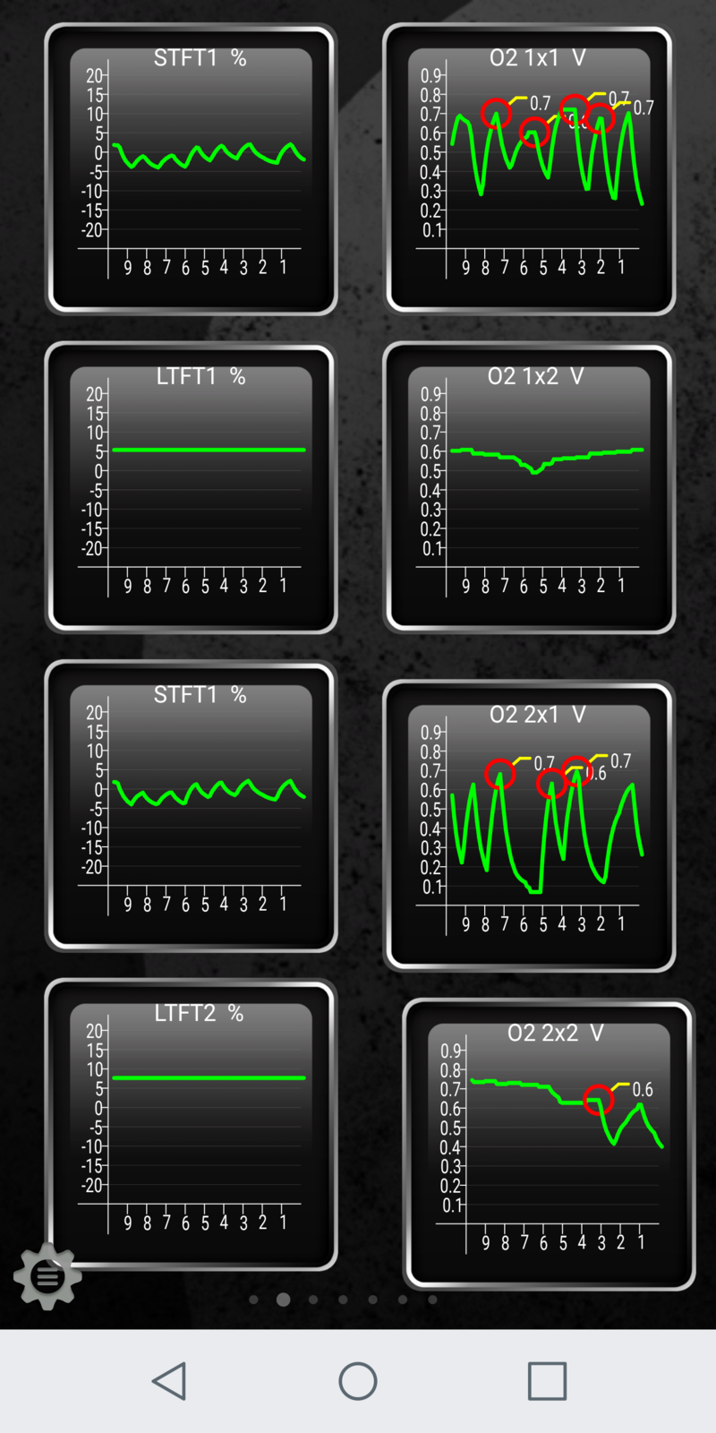

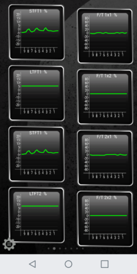

Can you graph data? Specifically B1S1 B1S2 B2S1 and B2S2. Monitor these 4 at OT in park at 2k rpm. No accessories on and turn all the lights off.

You talking 02 sensors right? I did it for both ft/ and o2 sensors. Ftb1s1 and ftb2s1 are the only ones that were jumping. Sensor2 in both banks were flat. Don't think its giving any feedback
Now when I did the 02 sensors b1s1 was jumping. Bank1s2 was semi flat. Bank2s1 ans bank2s2 were jumping. Or are you talkinf about stft and ltft? Im in the car now so i can get realtime sata on what's needed and upload. I jave screenshots won't ley ne upload them right n9w

all screenshots were done at 2kRPM after reaching operating temperature with nothing extra on and lights off.
View attachment 198512 View attachment 198513 View attachment 198514 View attachment 198515 View attachment 198516

It's your cats. Those lower O2 sensors should be moving around like the upper ones.
really? i thought the b2s2 was normal? ive only changed the up and down on B1 about 15k miles back acdelco. test the cats next??

You're right, my mistake in that the lines from both the upstream and downstream look similar only while cold, not hot. Your bank 1 is more normal than bank 2 lower sensor, they should both respond to rpm changes.

not sure i just looked at the best rated ones real quick. looking at that video rhe S2 jumping is actually the one thts off? but off in a wat showing cat damage or o2 sensor damage?

The cat. If you want to double check the O2 sensor performance, swap sides and run another scan.
