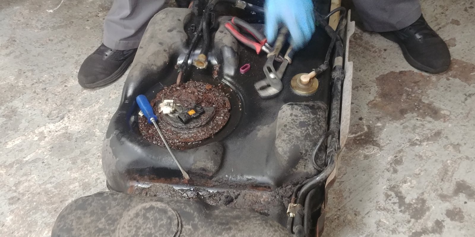

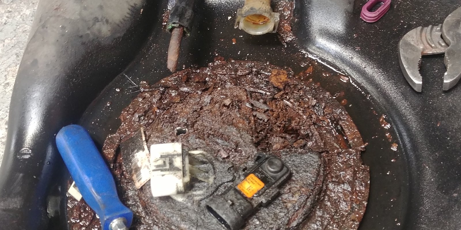

no need to spray that for a test, we know its leaking bad.
o ring is bad, or a line is snapped / cracked at the pump.
hit the strap bolts with some pb blaster for a day or two before you tackle the job, lowers the odds of that stripped bolt action.

shop is doing this one. my boss caught me doing the tranny fluid change and chewed me out dont need him getting riffed over the gasoline smells lol i will prepare it for them tho lol now lets talk parts :) ill be ordering from rock auto most likely but need to know the part numbers for the proper fuel pump assembly, the gasket and that metal ring. also the straps. i read somewhere its good to replace those for future maintanence. 2004 chevy tahoe 5.3 V8 T VIN.

I dunno, the top of that pump looks petty rusty, those lines are probably about to break off, too. I would also buy the lock ring. You gotta beat that thing pretty good to get it off.

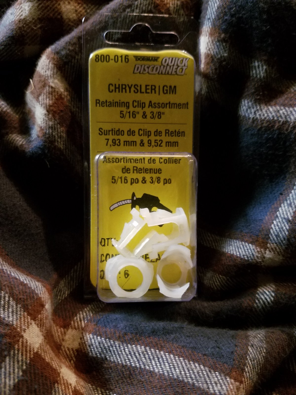

I broke one of these taking it off
Also used new ones for these.
