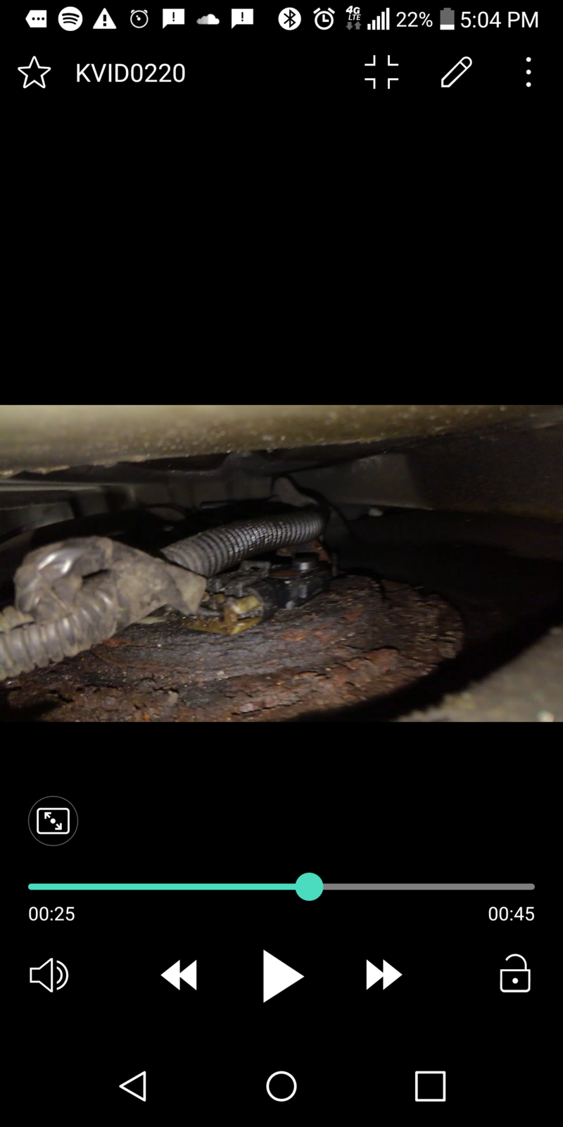

I posted the graphs of the 02 sensors at 2k rpm. I was driving yesterday highway speeds and the upstream were jumping downstreams were steady. I hacent changed the downstream sensor on b2. Now today...ran a smoke test for thr evapcode 0455 large leak...folloeing the smoke we foubd a cloud coming from the fuel pump.
Could you see where on the pump with a mirror up there?

Was able to touch with hands after we pulled off the wheel well...saturated with grime that smelled like gasoline.

fyi, a large evap leak can mess with your trims.
that looks like the pumps seal is failed, its a O ring.
or it was replaced and not installed right. looks like its time to drop the tank.

Yea too bad y'all can't hesr tj4 vid3o lol we were like damnnnnnn. I went to th3 mechanic showed him th3 video quoted me 225 to drop abd replace if I bring the pieces. My inspection is coming up I gottw this done next. Tine to research the pump assemblies. I have the maintence records from the original owner...this is the original pump and seals from the factory was never changed.
