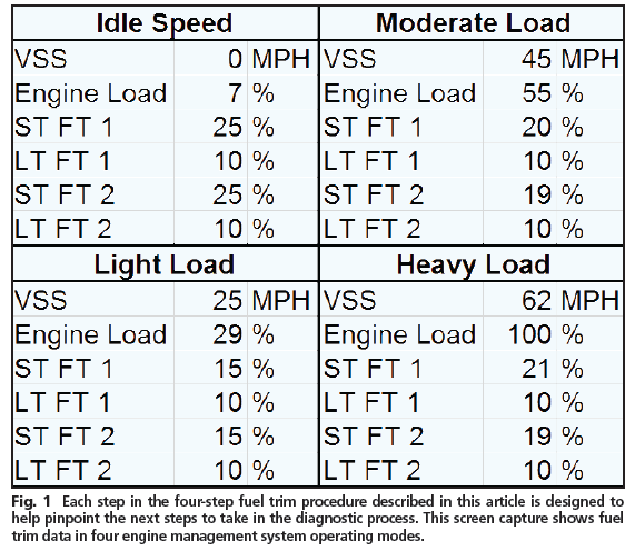

okay cool so heres an update. i hooked up the ancel and the torque pro with the bluetooth adaptor to compare and the numbers were the same. i took a bunch of screenshots from when i left work, highway driving..car off..then at idle again. i found a table of whats considered the various loads to diagnose the fuel trims properly so tomrroow i have those numbers in the proper loads.
now thats not my car that was some caer they used but now i see whats the different load amounts and can get that. but i did notice something...at idle after i parked for the night
STFT1: -0.78
LTF1: 7.8
LTFT2: 9.4
STFT2: -2.3%
arent these numbers supposed to be as close to 0 as possible at idle?
earlier in the day after the highway driving:
LTFT1:0.8%
LTFT2: 0.8%
STFT2: 2.3%
also ive gotten a PO455 CODE on and off...i replaced all the compnents and the gas cap in the evap system and still get it once in a while. saw this in the Emissions rediness s/DTC table:
Evaporative system: incomplete
02 Sensor incomplete
the rest of them ) misfire/fuel systemm compnenets, catalist) said complete or not availble. now i know if i got a large leak somewhere then yea the evap system may not be complete but the 02 sensor being incomplete? or are they connected? i also have 1/4 gas tank today i think ir ead somewhere the tank needs to be 3/4 or full for the evap system to work properly not too sure about that tho.

evap and the o2 can take a while to become "ready". like days even.
your trims really dont seem all that bad, they come with a lean ass tune stock. mine was +8 all the time before i tuned it.
when on a cold start the trims are not true. the engine is running off pre set settings till it warms up, then it runs off the sensors. and then trims are really what they say.
we no longer have a choke, so the pcm adds fuel to make it run when cold, so you get that high idle as well. why the trims got neg numbers on the cold start.

UPDATEs with fuel trims:
idle with car at op temp:
STFT1: 0.00
LTF1: 4.69
STFT2: -0.78
LTFT2: 8.59
25 MPH:
STFT1: -3.12
LTF1: 8.59
STFT2: 4.69
LTFT2: 11.72
45 MPH:
STFT1: -3.12
LTF1: 9.38
STFT2: 2.34
LTFT2: 11.72
65 MPH:
STFT1: -4.69
LTF1: 11.72
STFT2: 1.56
LTFT2: 14.06
then noticeed crusing around 50 mph:
STFT1: -6.25
LTF1: 17.19
sTFT2: -3.12
fTFT2: 17.97
now i been having on and off an evap code, PO455 and ive changed all the hardware in the system ( the canister/vapor things the one in the engine bay and he one next to the canister)
i looked in he vehicle test results on torque pro and sawe that i got a NOT OK on the lean to rich sensor thereshold
min:32878
current 32771
any ideas where to look from this info?
