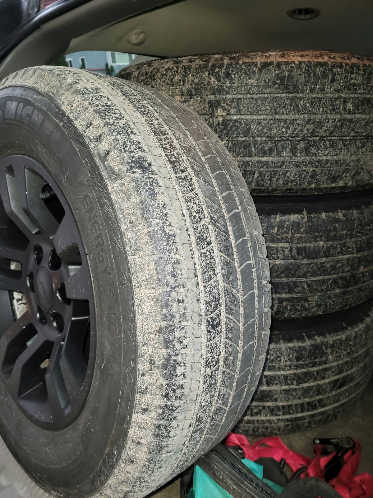

A tire that's separating from the inside sounds probable. What supports yur suggestion is 2 of the 2018 rims and tires were "harder" for the tire companies to balance each time. They would be baffled after it spun and rip off weights and start over. Also, as I'm looking at them stacked up I ran my hands.over the side wall of the tire closer toward the top of the tire where tire contacts the road and noticed bubble like formations every so often on the edge of the tire. Is that an obvious sign of the tires separating inside? And the separating tires are what cause the wheel to be so out of balance at higher speeds? I appreciate the help.
That most likely is your issue right there. Change those tires and I bet your vibrations will go away.
52,954
I had a shop balance a set of new tires 3 times and still had a bad vibration at about 60. I went to another shop who said one tire was out of round so I replaced it and the problem went away. Don’t know why the first shop balanced them but never mentioned an out of round tire.

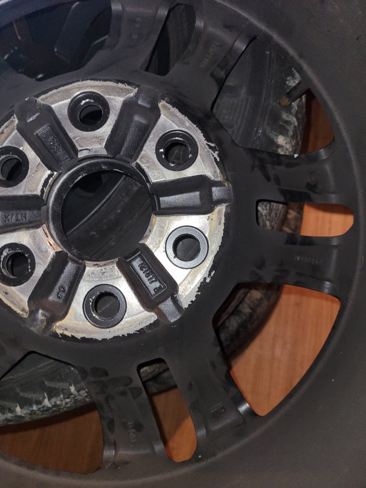

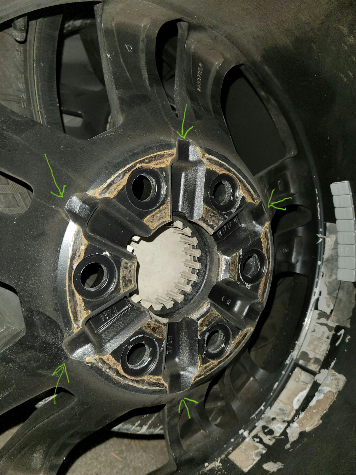

I have noticed small cracks by the hub where the spokes meets in the back. Very small cracks. Are these rims considered no good now? Would small cracks like that also cause vibration?
Thanks for the suggestions and comments. I've gotten more helpful information here than anywhere else.
21,322
30,319
Photos? I didn't notice anything amiss on the two earlier ones.
Have you changed the tires? Pictures please

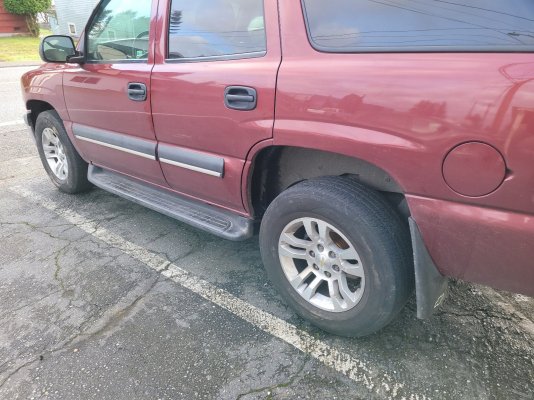

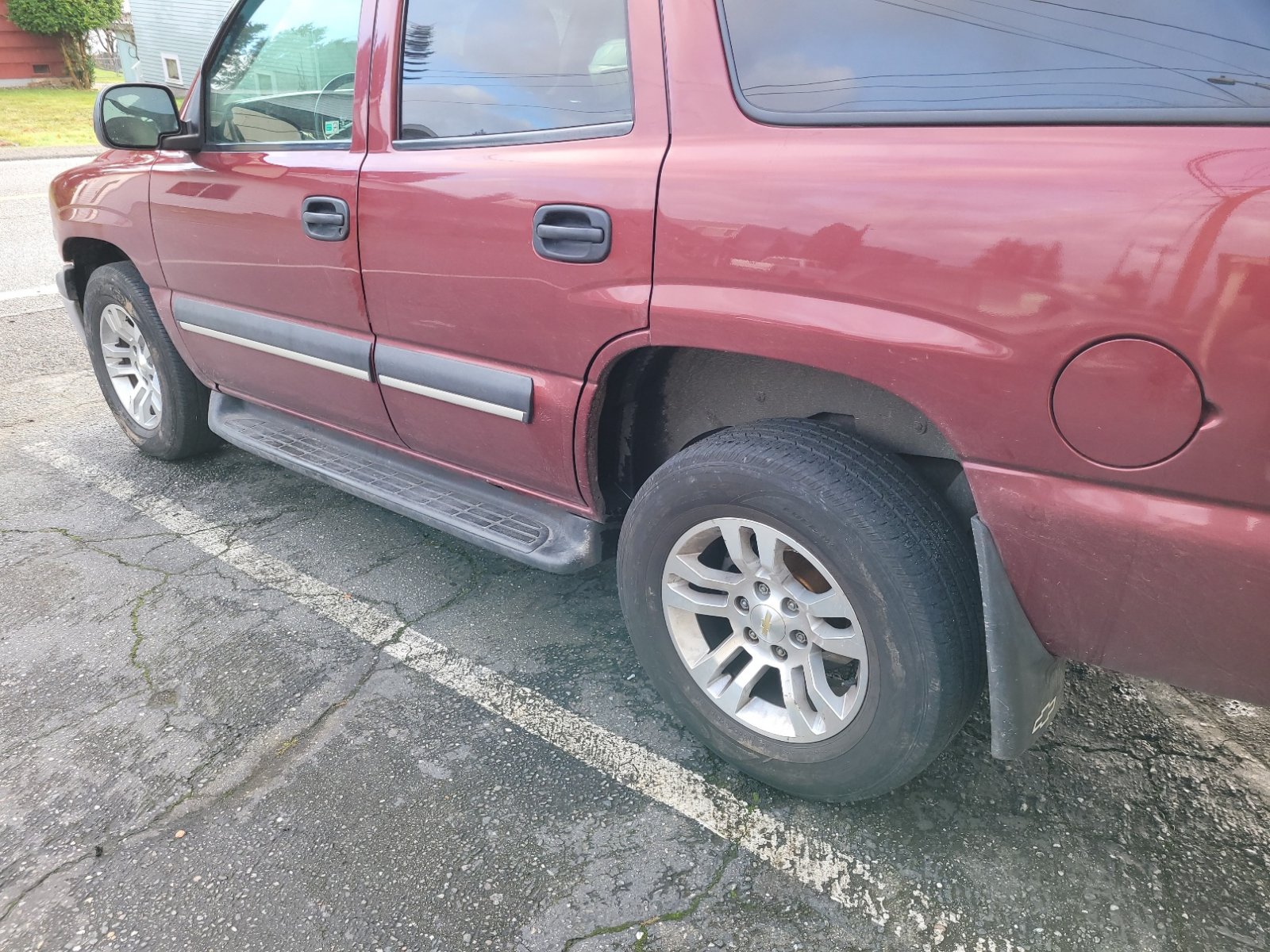

So........I was able to get another set of 18 x 8.5 chevy rims with p265/65/r18 on them for really cheap. (Set 2) They are exactly the same as the wheels/tires I have in question. ( set 1)
This morning I mounted the newer set of rims and tires (set 2) and took it for a test drive. To my amazement and shock there was no vibration At any speed! So yes these gen 4 rims fit on gen 2 tahoe no problem. And my issue is solved, just need a new set of tires!
And defintly sometging is up.with (set 1 ) tires. They look fine on the outside, even had the tire shops say there in good shape. But none of the shops said a word about separating or out of round when I mentioned the vibration. Of course I can't say exactly until.i get them off but since I've got the exact duplicate rims /tire setup on at the moment and no issues. I'd have to.agree with dantheman and tires (set1)are the issue. I'll post a picture with the 2018 rims on my truck (set 2 alloy), and a picture of the cracks in the (set1 matte black) rim. The cracks I'm pointing to are not on any of the other rims at that location on the rim.
