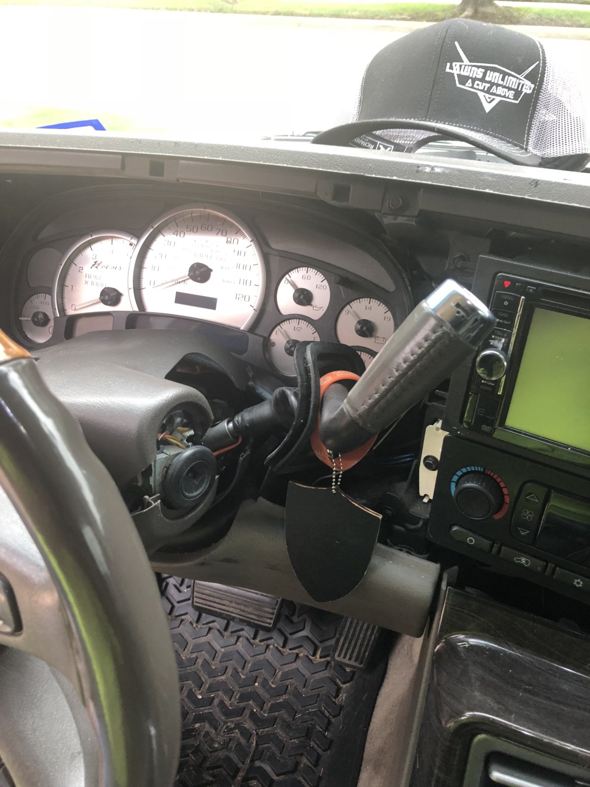

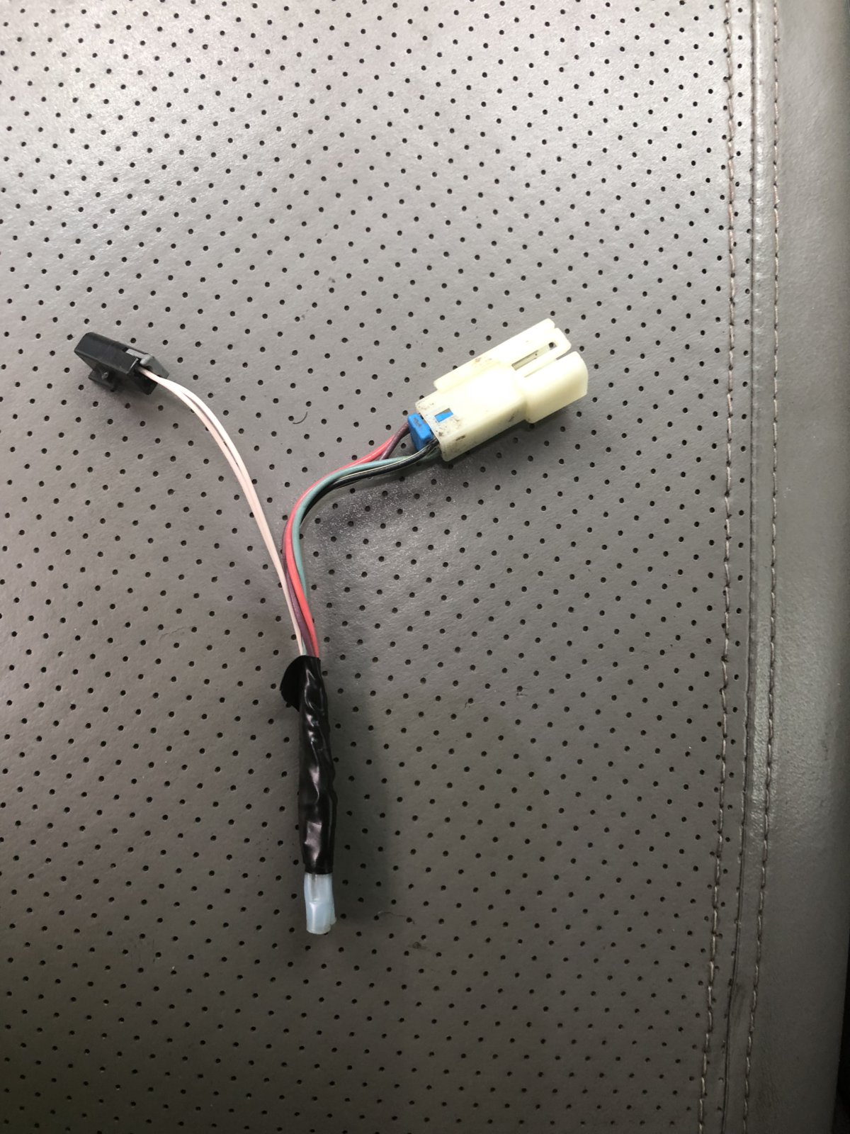

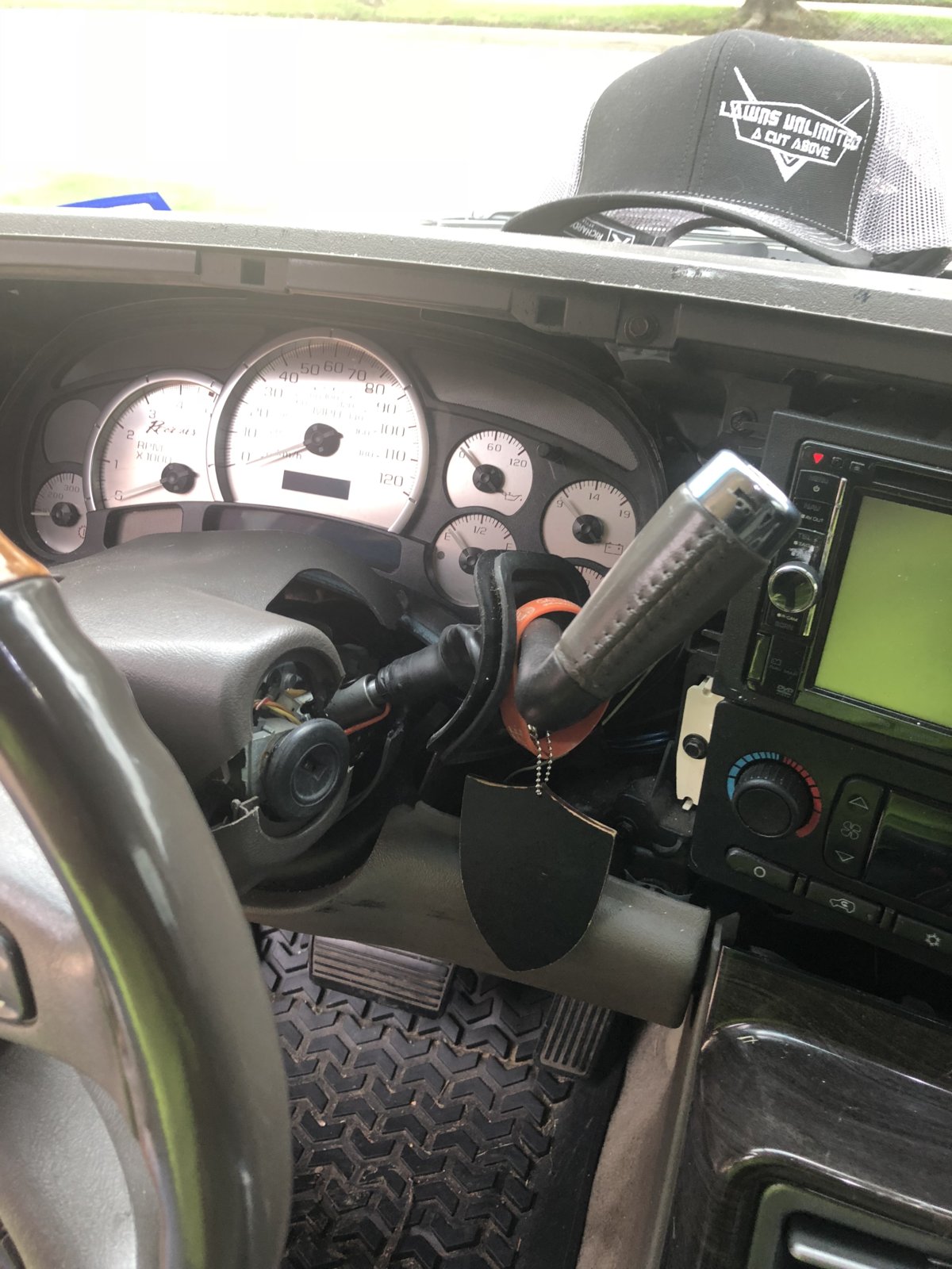

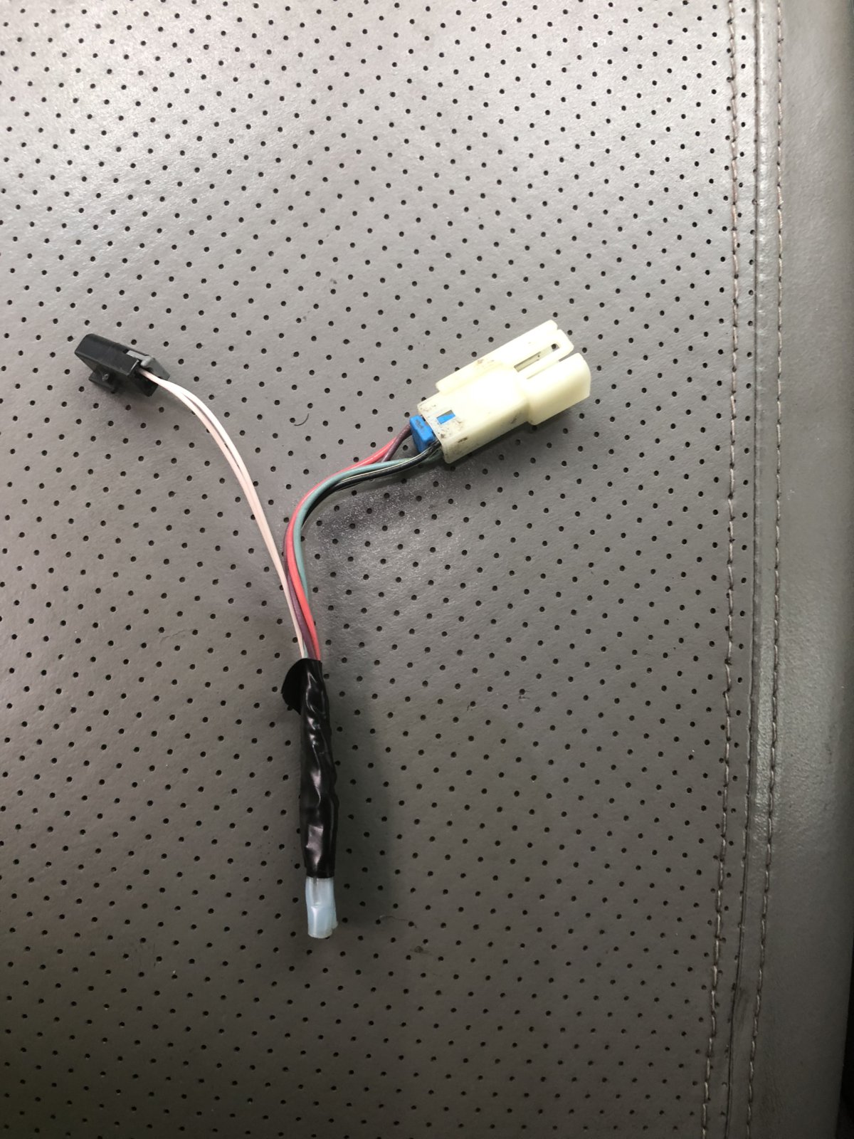

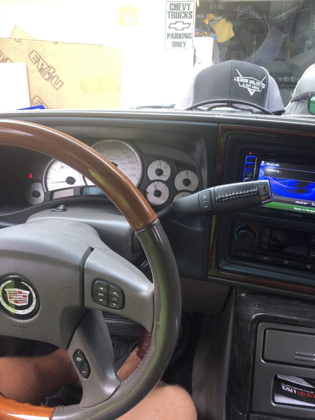

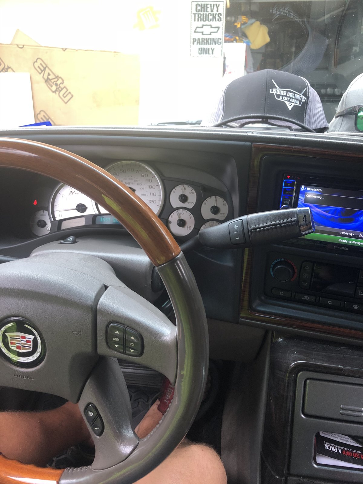

who all here has upgraded to the NNBS gear shifters!
I did and love it ! Now my +_- buttons don’t operate yet but tow haul does and love it here’s mine before and after mines a 04 Escalade and bought a 13 Escalade platinum shifter

Is it possible to make the +_- buttons work if you do this swap? If so can someone post a link?
The + / - will not work with the 4L60 tranny.
This is correct. The 4l60 can't be manually commanded. That button is two momentary switches with inline resistors for sending two different voltage signals to the TCM. I have plans to repurpose it in some way, still not sure. Maybe I should just get the damn thing into the truck for starters. Lol
52,954
I did it. I’ve never heard of a use for the +- buttons yet due to the built in resistors.
