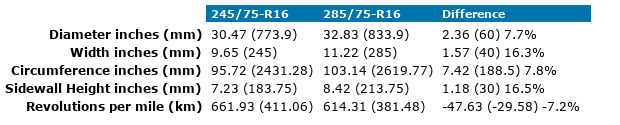

so I just found out I have 3.42s and a G80. I also have 285s which are roughly equivalent to 33s. I also tow about 6000lbs. It seems to do fine but would like it to do better. Also, when driving without towing, it seems sluggish after about 50mph. Everything I'm reading leads me to believe that the gear ratio is off. I'm considering going to 4.10 gears to help with towing and give me a little more power as well as get it back to stock numbers, if not a little more due to the tires as it originally came with 245s. It is also 4x4. So what all does this entail? How much should I expect to spend? Are the gears changeable or does this require new axles? What about this G80? Haven't had any problems but am curious if this is something I should address now also. Thanks.

285 75 16 up from 245 75 16, thus my reference to 33s. I assumed the 75 was a given. My bad.

"75" refers to the amount of sidewall, which along with the wheel size, tells you the tire height. It varies obviously.
4.10's seems like a reasonable final drive. You have to change front and rear gears and its not going to be a cheap endeavor.
